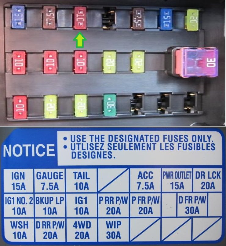

    @Dm93 I hear you are the man to ask. I suddenly lost the lighting around my stereo head unit (head unit buttons, volume knobs etc) as well as the climate control lighting, the lighting next to the shifter...and im not sure where else. I do still have dome lights and the clock...any ideas?!

    Do your tail lights work?
    What about the backlighting on all the other buttons (window switches, dash buttons, etc)?
    If the tail lights work but nothing else I'd start with checking the dimmer knob, If the tail lights don't work check your Tail fuse.
