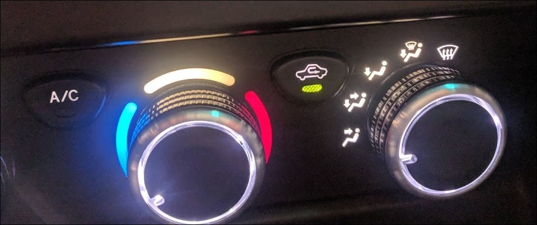

    I really like the white LEDs - to hell with that stock orange/red, never again
    cell pics suck but you get the idea and no, not blinding at night. These are SuperBrightLEDs by the way

    Do the a/c and recirc buttons luminate white on the white 4runner panel you have or did you have to modify those to make them white?

    Not white but green. It's like the old school camry/corolla green. Don't have a pic of it but can get one tomorrow if needed.

    What knobs do you have on your climate control panel? Those don't look factory to me but what do i know?

    When I was tracking down info on the 4Runner HVAC controls, I seem to recall the AC and RECIRC couldn't be altered without hosing the button. There is a solid piece of colored plastic in there. Anyway, here is the green -
    If I ever try another color, it'll be this green.
