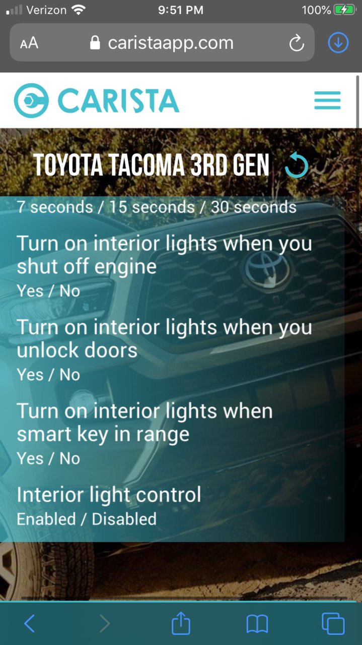

    Both trucks are identical. I'm saying I just learned that if your lights are in the on position and you shut off the truck, lock it and the headlights go out then when you approach the truck the interior lights will come on. It's a safety thing. Now repeat the process again with the lights put in the off position this feature will not work.

    Mine works either way with headlight on or in the off position.
    Here are my settings.
    No
    Yes
    Yes
    Enabled
