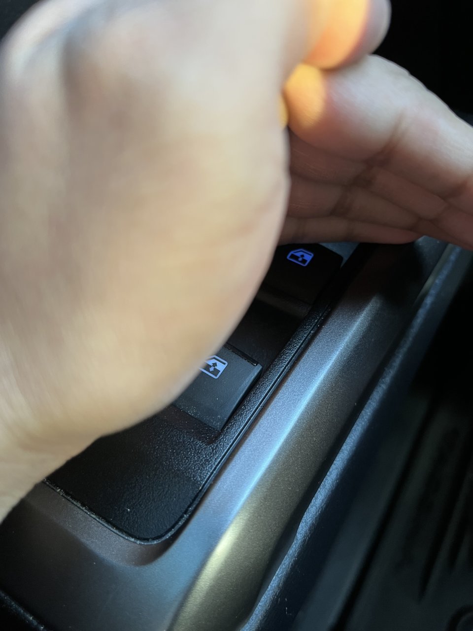

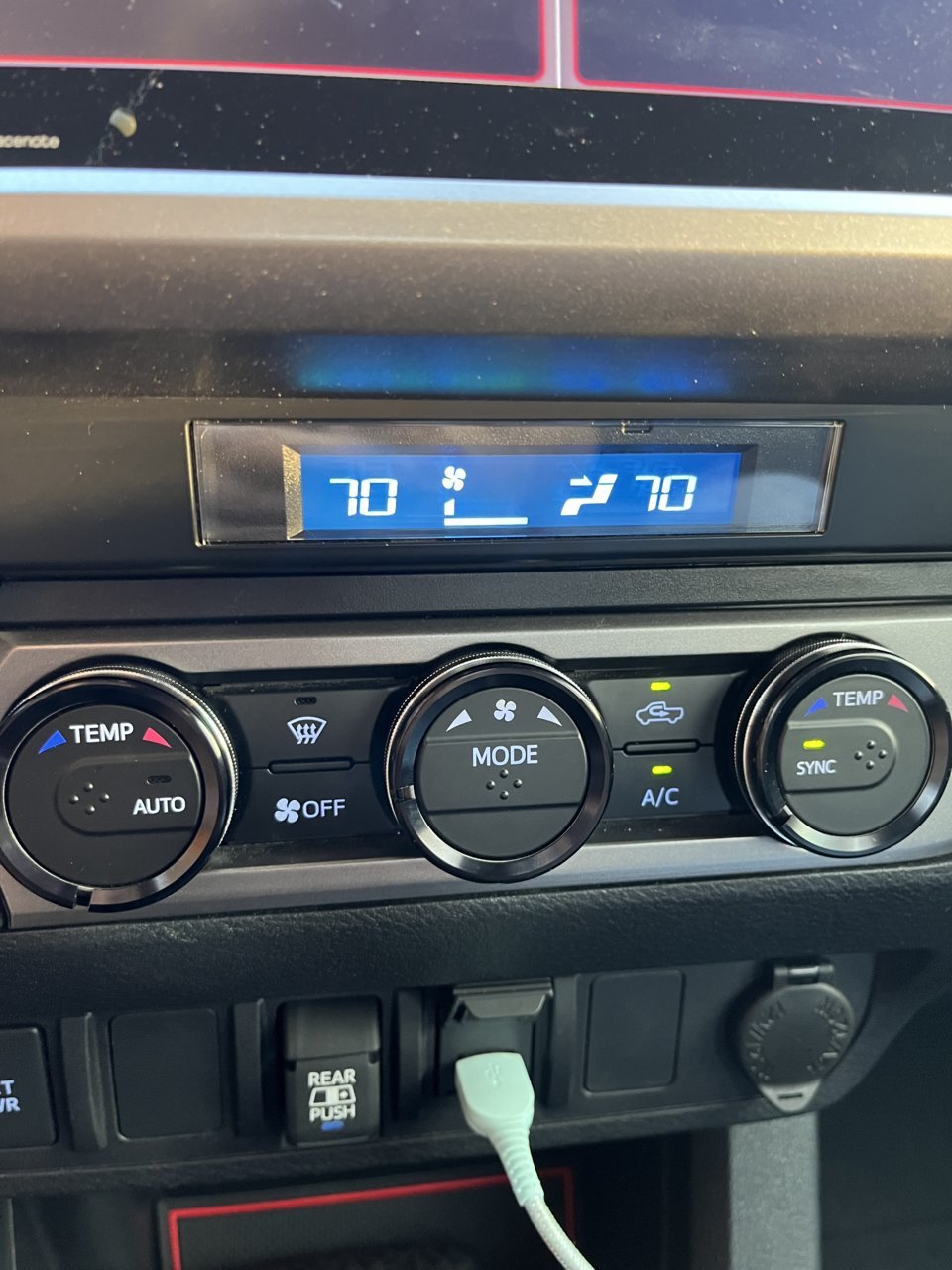

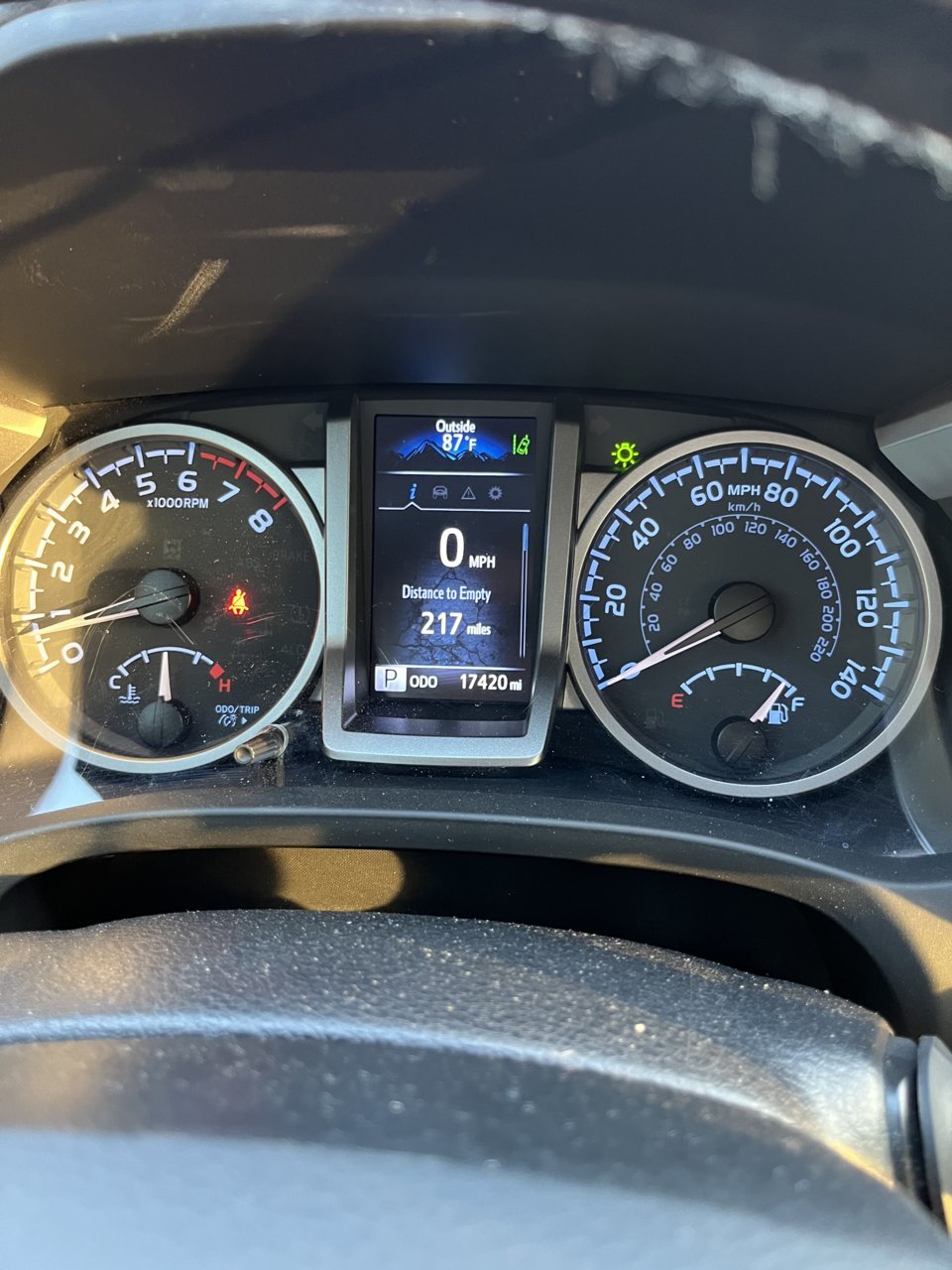

    Hi all! I own a 2022 SR5. I have seen several threads and I decided to join this awesome community. This is my first thread. Is there a way to change all the interior blue lighting to a different color? I’d like to change the (AC knobs and digits, instrument cluster, and door switches) to red lighting instead of the blue. Red is my favorite color and I think it would look awesome and also match with my current screen theme.

    I believe this is not a simple bulb/lamp swap out, the LEDs are solder to a board.

    I have no idea my friend. For many, the risk isn’t worth the reward. I’m sure it can be done if you want to dissect the controller boards.

    You'll need to pull each switch apart and de-solder the blue SMD LEDs mounted on each circuit board, then solder in new red SMD LEDs. Same goes for the instrument cluster, HVAC display, etc.
    SMD "Surface Mount Device" are SMALL.. and the precision needed to do this is possible but definitely not easy. I swapped out ONE SMD LED in an Air On Board switch for a color change and I wrecked the board from too much heat and pulling too hard with tweezers. I assume for a bigger job the odds of trashing something expensive are pretty high.
    CHANZON (5 Colors x 20 pcs = 100 pcs 0805 SMD LED Diode Lights Assorted Kit (Mini Chip 2.0mm x 1.2mm for PCB DC 20mA) Super Bright Lighting Bulb Lamps Electronics Components Light Emitting Diodes https://www.amazon.com/dp/B01CUGA8JO
    There was a dude on the 2nd gen board that used to do these conversions for the older trucks (stock orange color to white) but IDK what happened to him. Maybe he's still there?
    Juice ain't worth the squeeze IMO...

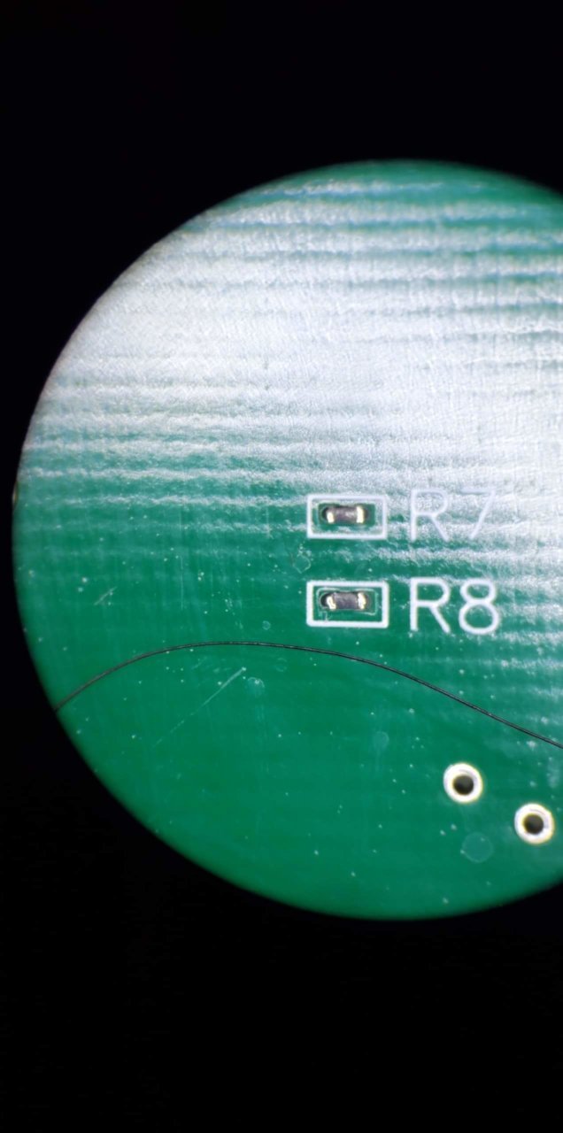

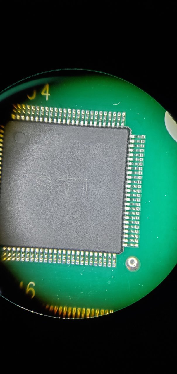

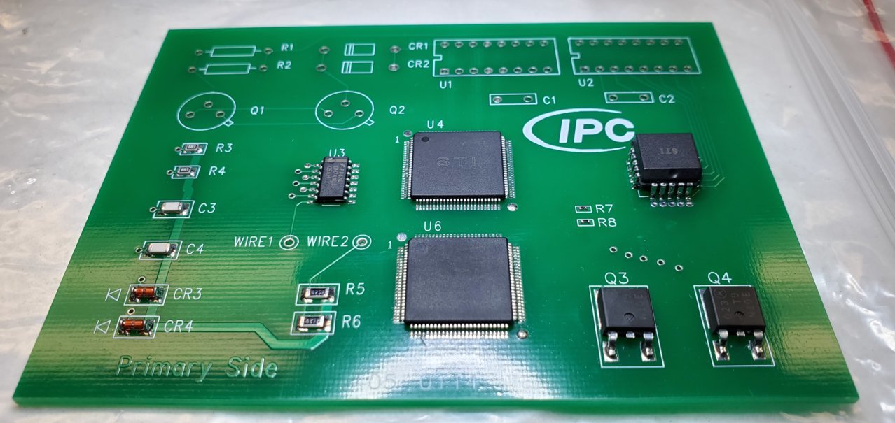

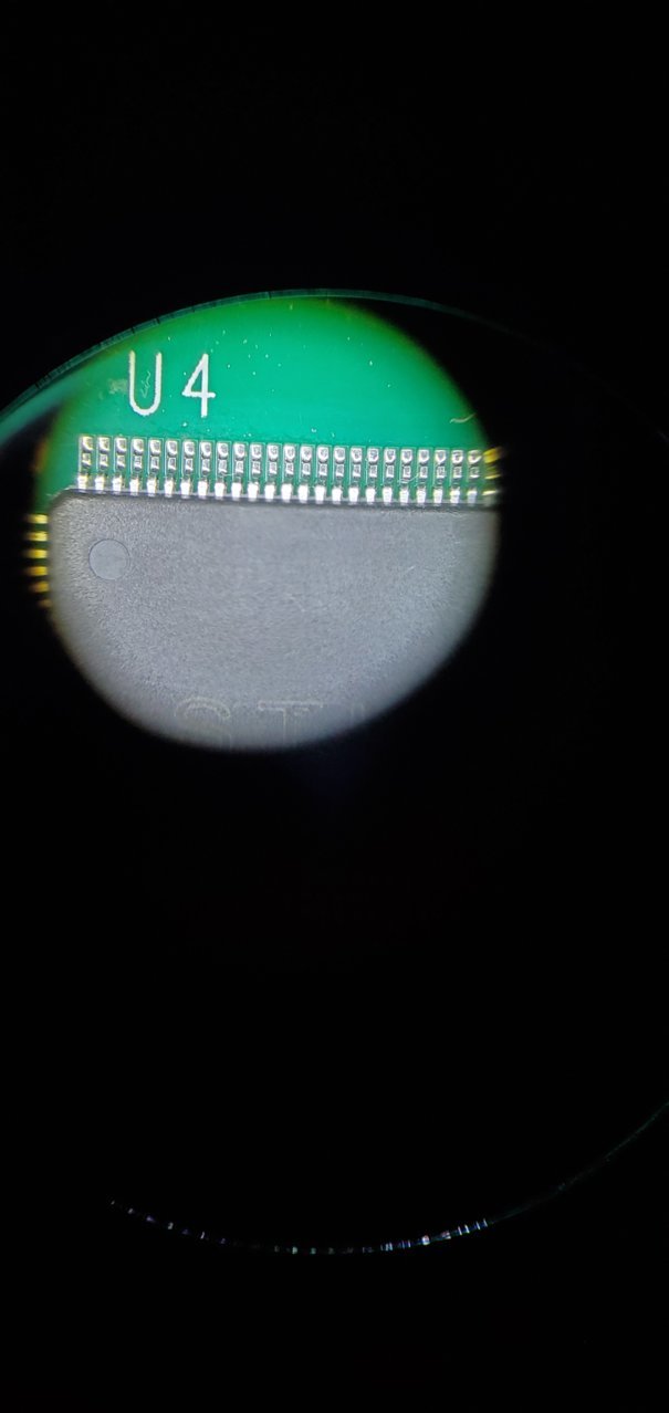

    It's not too difficult if you've got steady hands, but even that isn't necessary. However, it may not be worth it if you don't have the necessary tools, as those can be pricey.
    • 60/40 leaded solder
    • Soldering iron that can be set to 700°F (I've found 650°F works well)
    • Liquid flux (not just the rosin core solder)
    • Solder wick to remove the solder from the board after pulling the current LED off, also to fix any issues you may have, like a cold solder joint
    • 30x+ magnification microscope (30x-40x works for most applications done by hand)
    • Light source for the microscope
    • Set of helping hands to hold the parts in place
    • Acid brushes, isopropyl alcohol, and q tips to clean.
    When using the proper tools, the parts almost solder themselves. The flux and solder will help pull the SMD part right onto the pads.
    Full board:
    Full board:
    100 pin:
    100 pin:
    That is a hair from the acid brush, comparing the size to the resistors.
