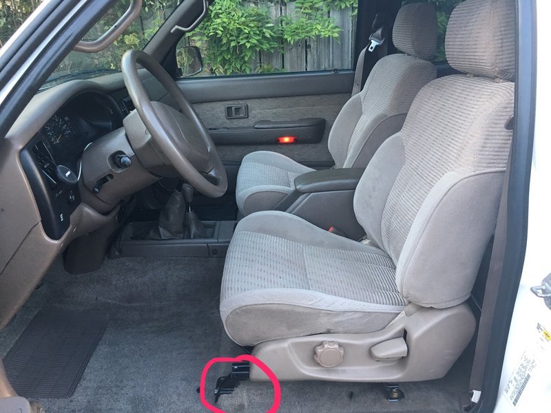

    No welding required. grind off the rivet holding the 90 degree angled foot from the tacoma seat, then grind off rivet holding the 45 degree angled foot from the 4runner seat, and then bolt the 90 degree angled foot to the rail of the 4runner seat (foot circled in red).

    It was so hot I decided against the extra time to do the write up. I'll try and answer any questions. I did not document the process to do a write up unfortunately.
    Grinding out the rivet is probably the hardest part. I didn't have my grinder so I drilled it out (more of a pain, but do-able). The rear foot on the outter rail (the foot behind the circled one) was about a 1/4 inch off centered. I was able to make it work with some muscle and was able to get the large bolt and washer in. So 3 of 4 lining up is a bit of a stretch. 2 of 4 are PERFECTLY centered, the 3rd hole is slightly off, and the 4th (red circle) is the wrong angle and must be fabricated.

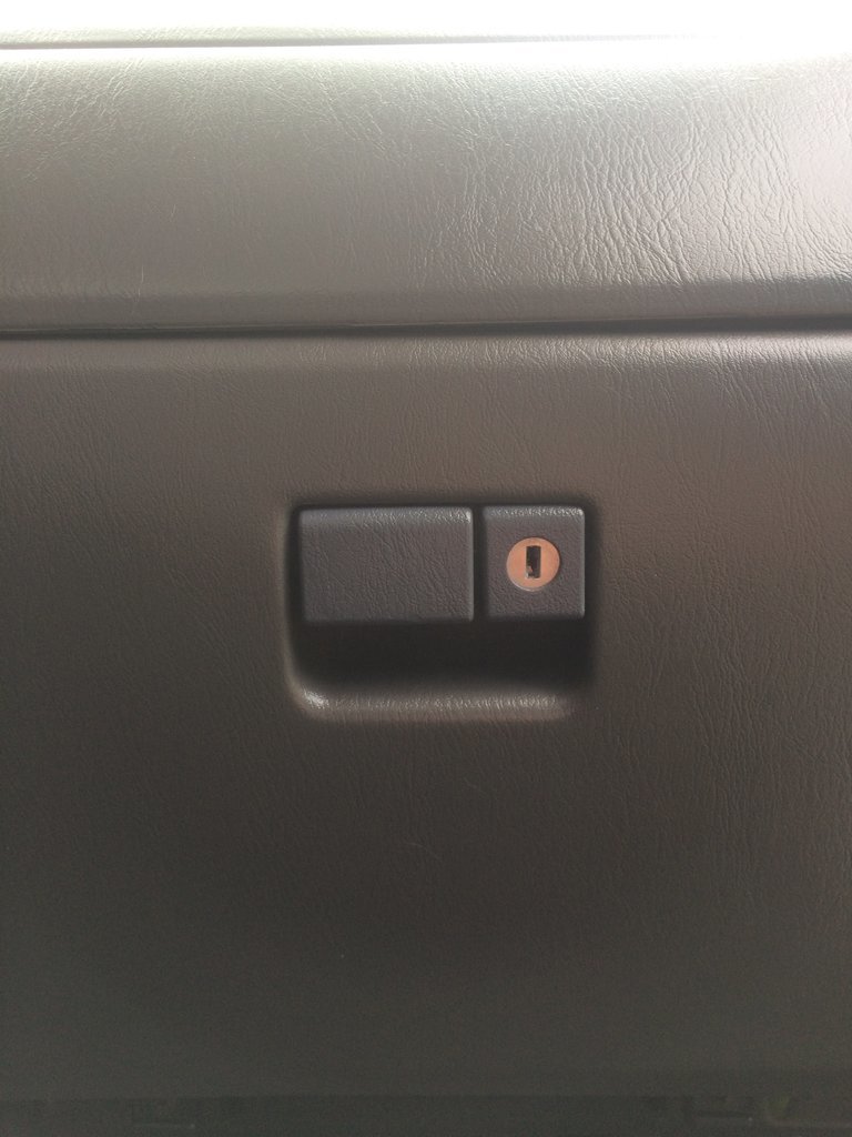

    Locking 4Runner glove box:

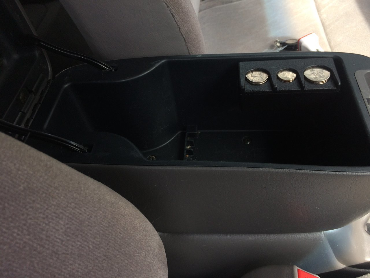

    Replaced missing coin holder:

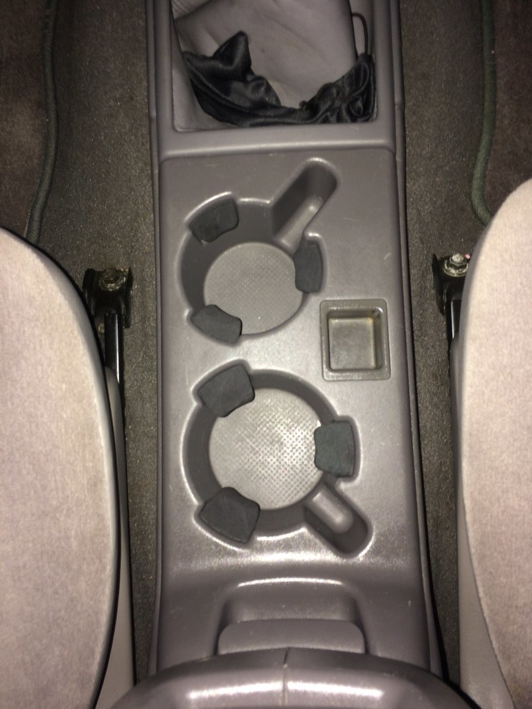

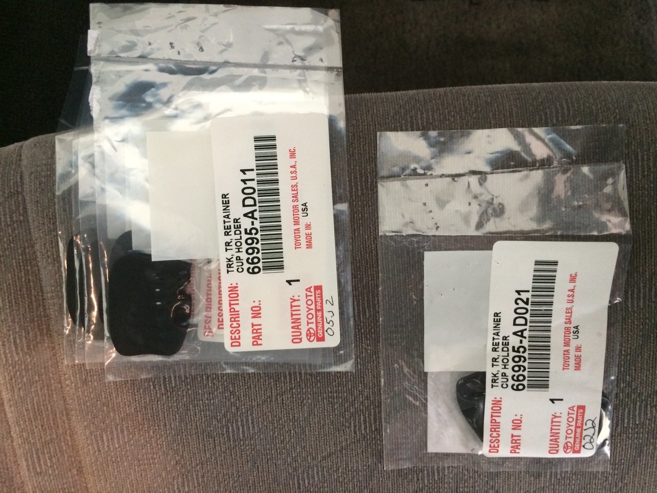

    Replaced missing cup holder inserts:

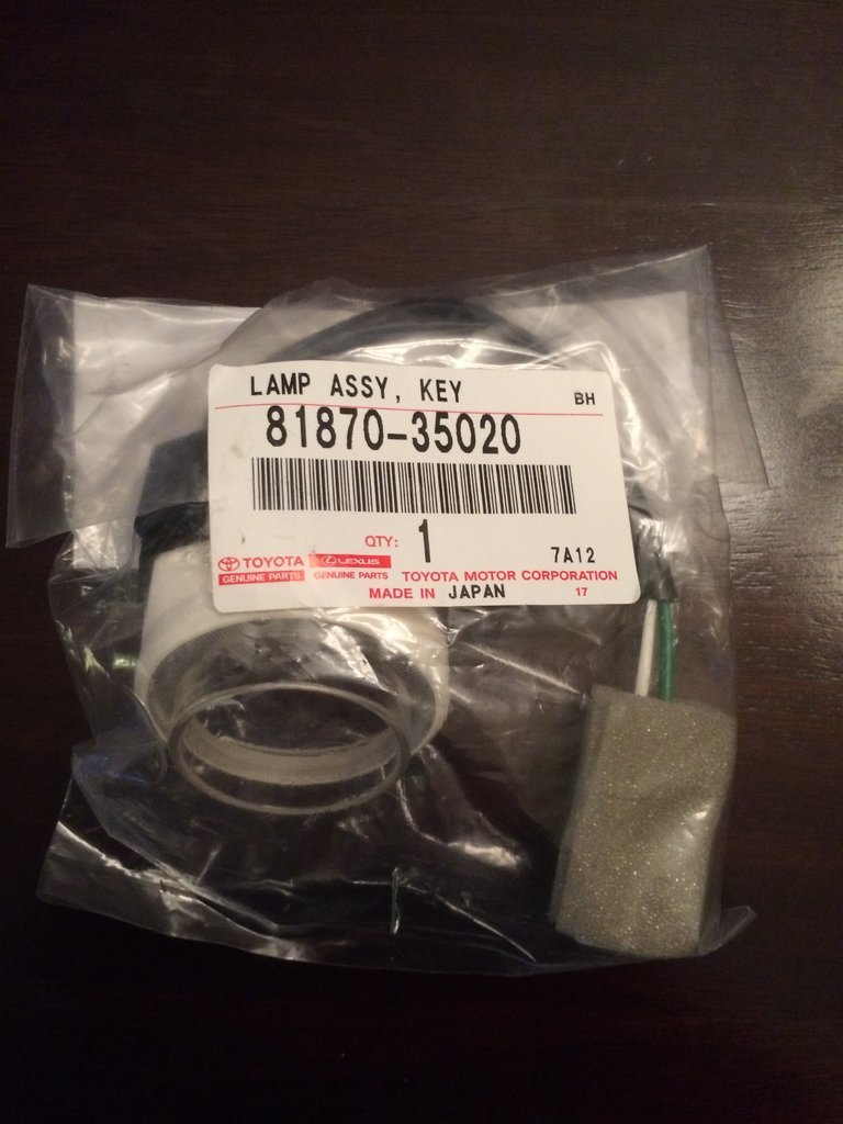

    Next mod on deck is the 4Runner lighted key ring:

    Were did you find the cup holder inserts?
