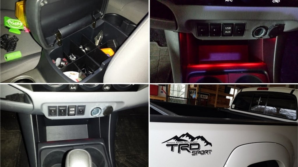

    Cheapo "molle" storage after removing DC plastic organizers;
    Three switches are for the interior cup holder lights, backup cam anytime, and rear lights. Salex console organizer.

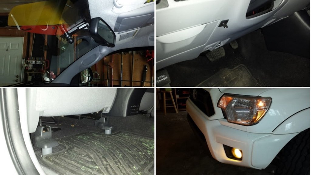

    BirdDawg rearview mirror riser, seat risers, fog-lights anytime and ABS kill switch:

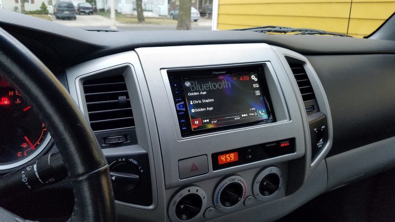

    Just got mine. Replaced most of the interior lights with LEDs. Just installed a new Pioneer this weekend. A lot of stuff to do. I like the Maglite mounts I'm seeing on this thread. Gonna have to grab a set of those.

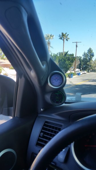

    it is a scangaugeII

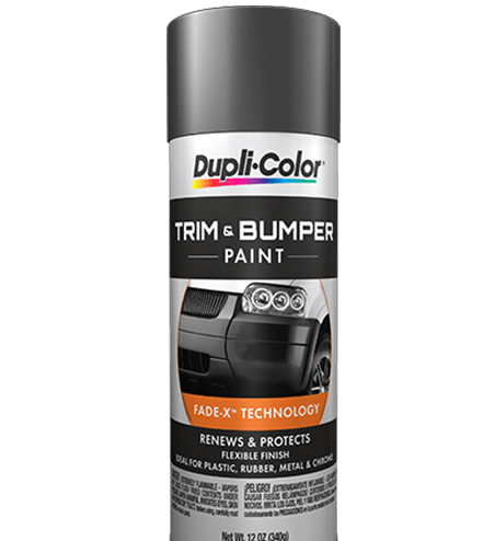

    Trim paint works the best for me .Duplicolor sells it.

    Which one the trim&bumper one? Or you got a link to the one i should use

    The duplicolor trim and bumper paint?

    Yea thats what I use . Clean part to paint good first .Also good to use the duplicolor (or other brand) adhesive promoter.

    So your saying this one... isn't this just for the outside? Or should I get the vinyl and fabric dupli Color? I just want to mess my interior up lol

    I use the trim paint for my pieces inside . Also use Duplicolor adhesive promoter before trim paint.

    As some else mentioned Sem makes Good trim paint A lttle more expensive though. I havr
    I have had good reults with the duplicolor.
