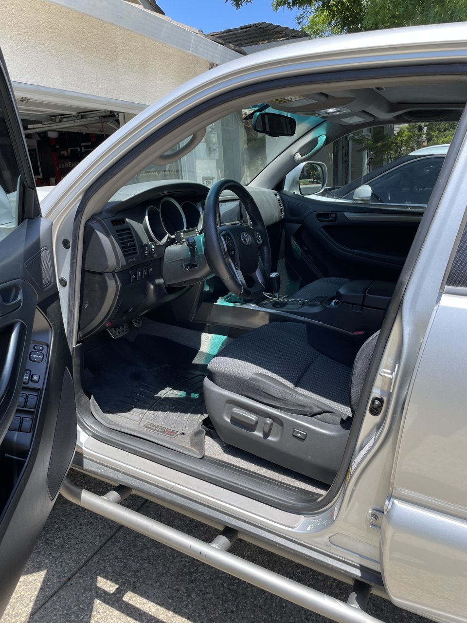

    I painted the interior of my 07 Sport 4runner black using SEM color coat. It already had black seats due to it being a sport model but it turned out great! Will post pics later but I did my lower dash kick panel, glove box, door cards, console, rear panels, basically everything from the bottom of the windows down.

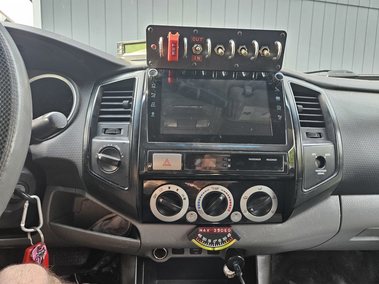

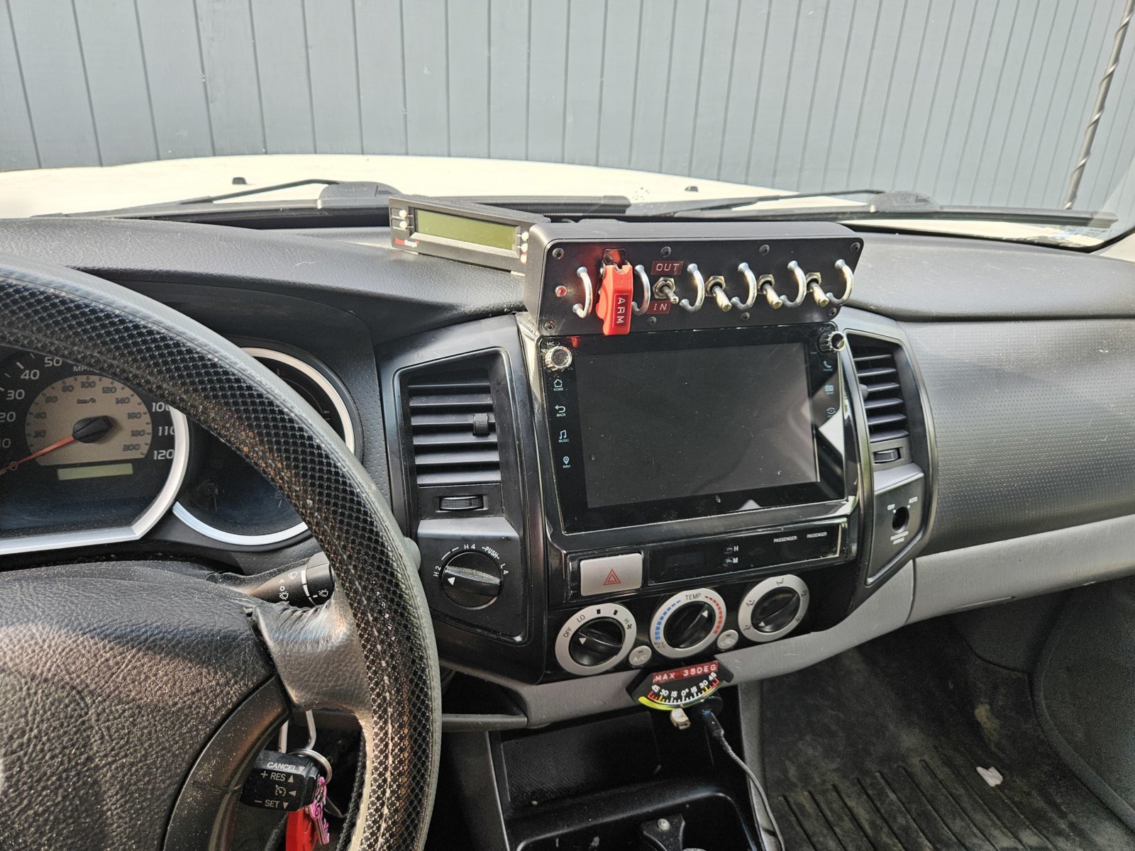

    Picked up a 2.5gen surround and climate control for cheap. Did some microsurgery to make the faceplate off the climate control to make it fit my existing - the top tabs don't line up so I got after them with a scalpel and swearing until they did. I wanted to keep the silver knob surrounds to match the hazard.

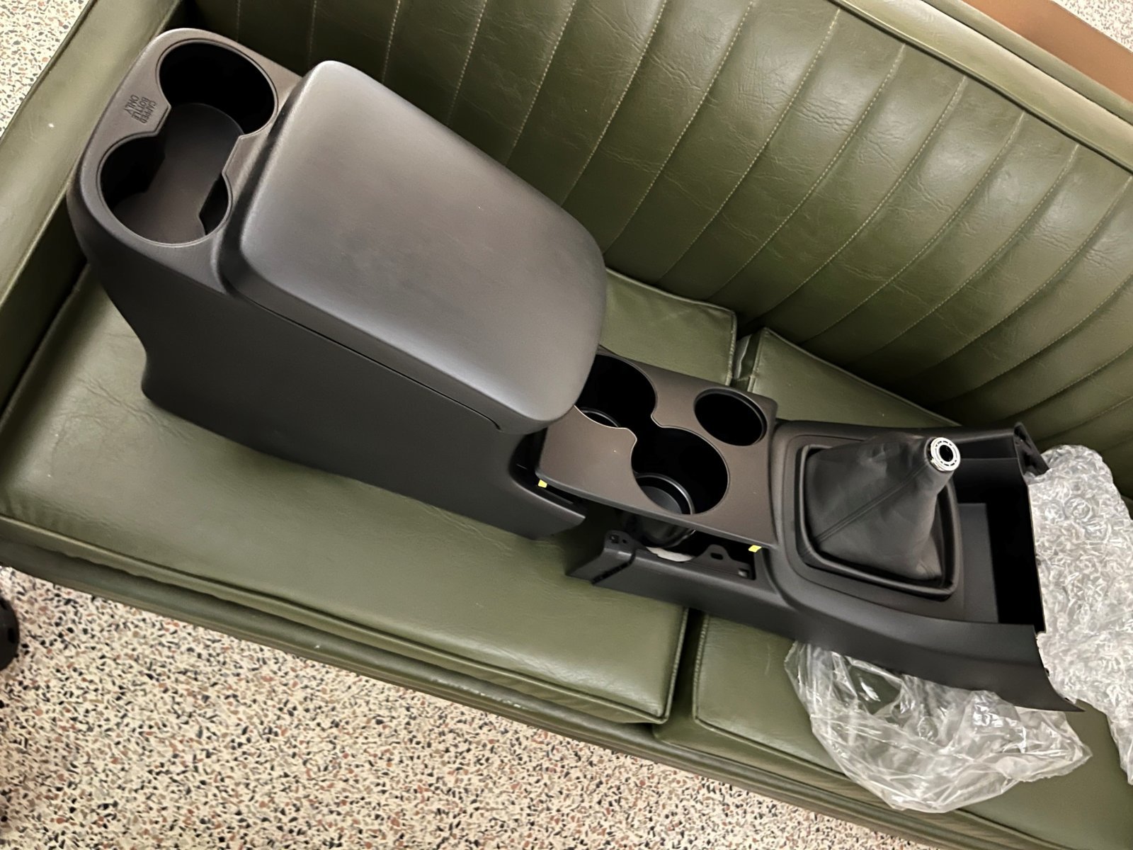

    That seems like a lot of work when you can just order all of the console parts in black. Photo below of my new console parts for a project I have going on.

    Buddy you're not gonna believe it. I have a black console sitting in my garage waiting for me to reupholster the dog deck. That SEM did not hold up to Truck Stuff, so not only was it a lot of work, it cost money and the result wasn't good enough. :rofl:
    I'll post some pics and an update on the SEM when I get there.

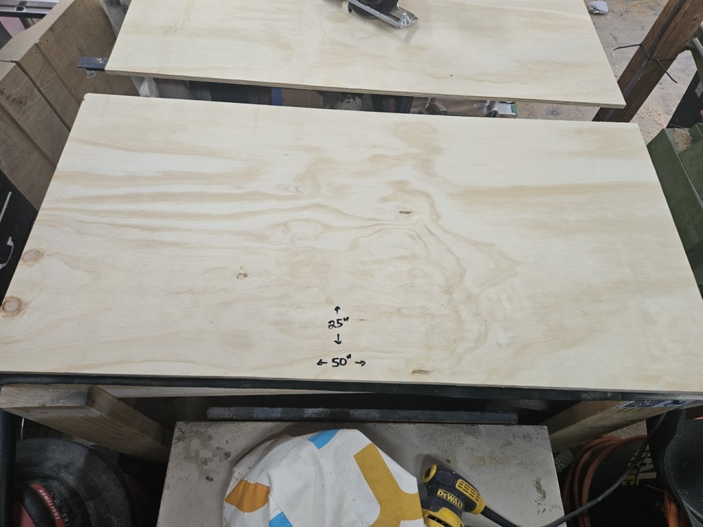

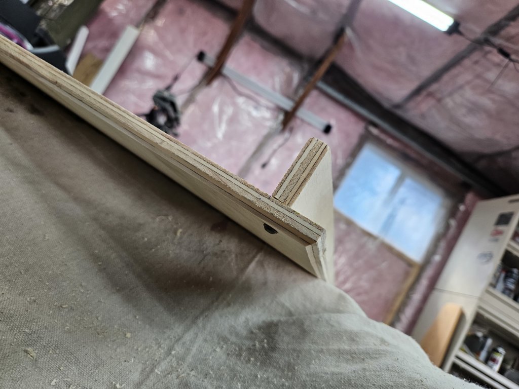

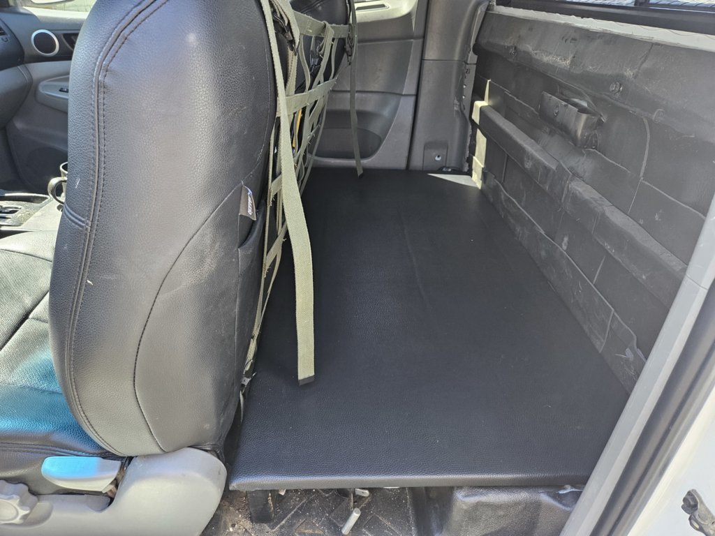

    Ok, we are finally crawling back to this project.

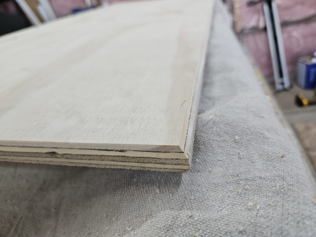

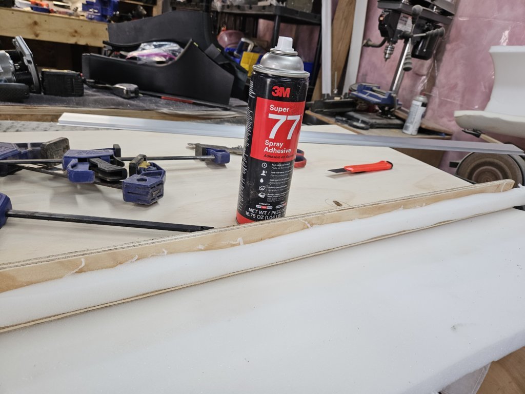

    I have had a cargo/dog deck in the back of this Access Cab made of a bunch of crap I had laying around at the time. It has been that way temporarily for the last 9 years.
    It was a bunch of manky 3/4" plywood scrap, an old yoga mat, and some outdoor carpet remnant, and after sitting on the materials to do so for two years, I am finally underway.
    Old deck:
    3/8" ply, 50x25":
    Salvaged the old yoga mat, glued it down with Super77, rolled it with a deepwell socket and bodyweight, and trimmed edges:
    Flock-back marine vinyl, super77 and a few temporary staples. The vinyl has some creases that I want to try to get out, so I'll let it cook in the truck until a few things for the rear wall upholstery show up (new c-pillar trim clips - I finally removed the rear seatbelts that have been doing nothing but clunk around and catch on cargo for 9 years) and then give it a re-stretch and a good staple. I'll also be putting some aluminum 90 on the outboard edges for extra durability when slinging shit in and out of the truck. You can see the creases pretty well in this lighting:
    And here it is with the front legs put back on and slapped back in. Nothing holding it in right now but gravity, but it will be fine for a few days:

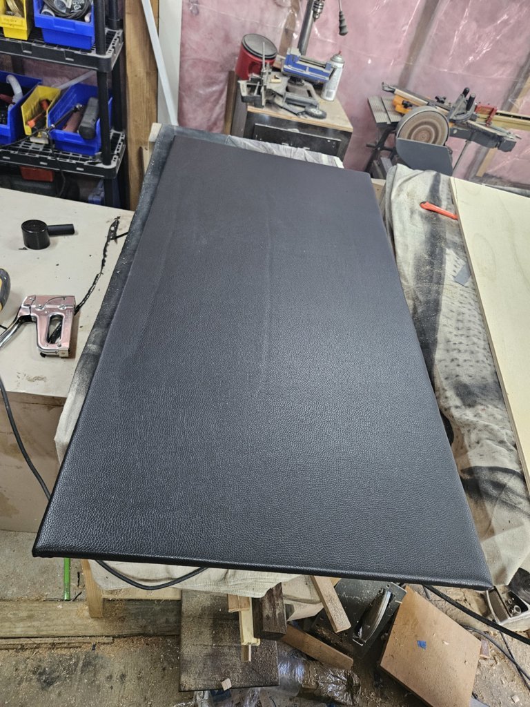

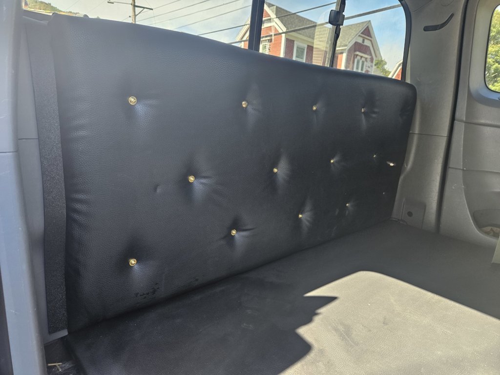

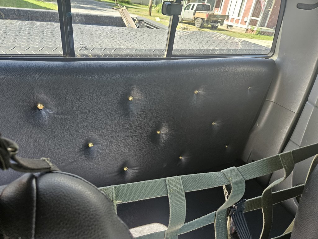

    Got the rear wall section together and upholstered. Its by no means perfect (or done) but its a nice checkpoint in the project.
    20250828_111221.jpg 20250828_111227.jpg 20250828_100137.jpg 20250828_100153.jpg 20250828_102411.jpg 20250828_102733.jpg
    Black marine upholstery vinyl over 1" marine upholstery foam. (Marine grade is redneck aerospace.)
    The upper corners kinda look like ass on the outboard edges because the geometry there was pretty complex, and I have no idea what I'm doing. They'll be covered by trim (waiting on materials) and there is a lot of detail work to do yet, but overall this is already 1000% better than it was.

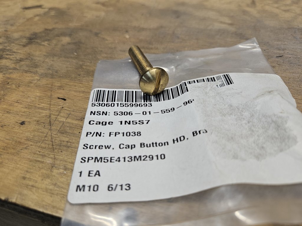

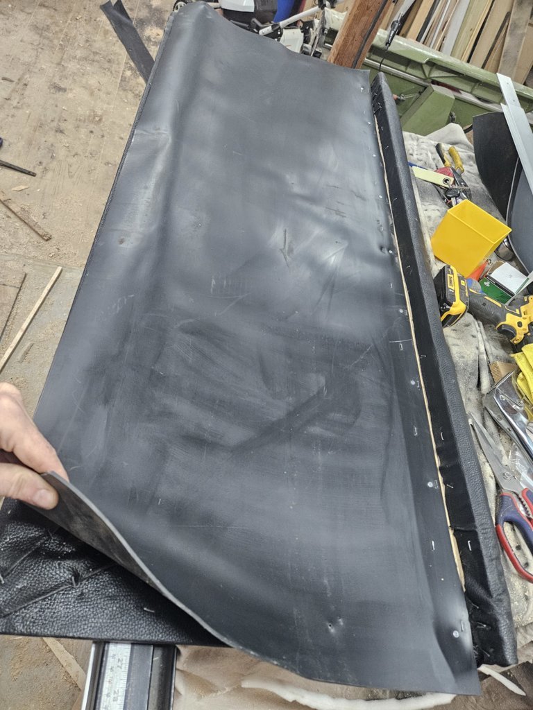

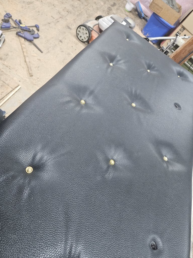

    Well, the upholstery is finished at least. I have some special order brass M8s coming for the two fasteners that go to the wall.
    MLV hung behind:

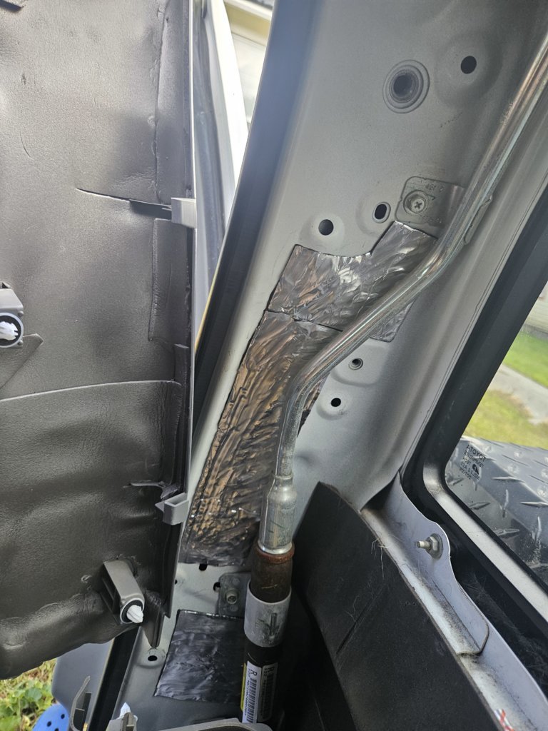

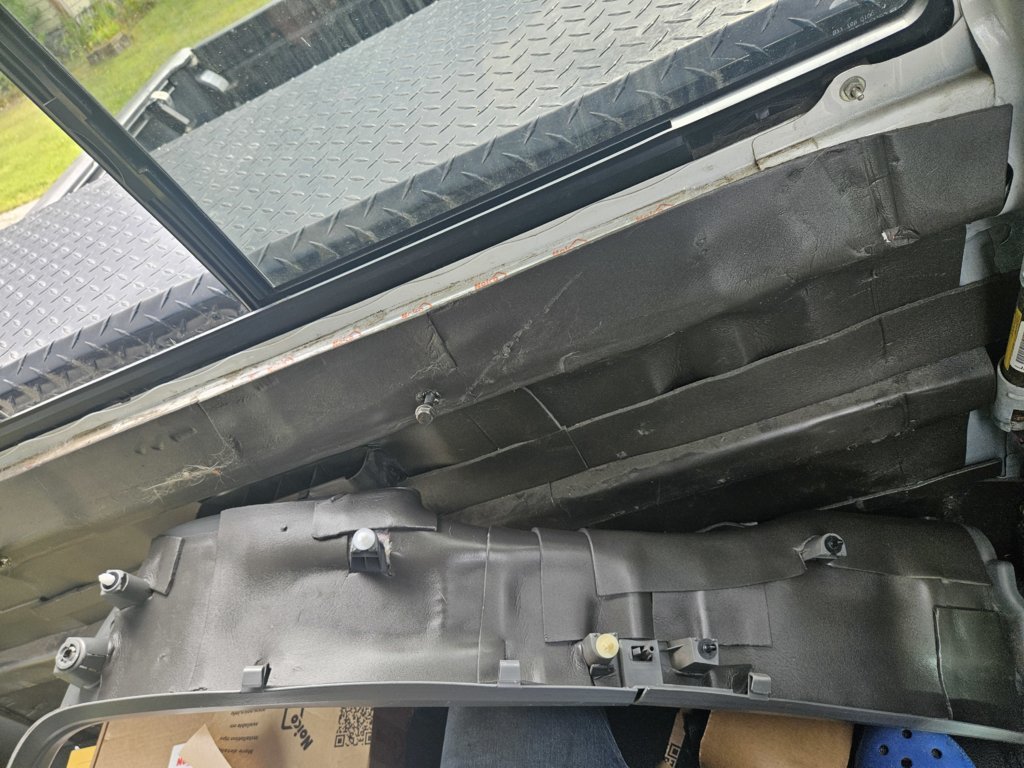

    I was taking some measurements so I had the C-pillars off again anyway, and I found the pile of Noico boxes that have been waiting for me to get around to this. The rear wall and factory cubby floors have a 100% Noico 80mil/100% Noico Red layer on them that reaches around the rear corners. (Done previously, documented somewhere in the bowels of TW - https://www.tacomaworld.com/threads/access-cab-noise-reduction-process.742121/#post-26419537)
    I threw down some strategic 80mil on the interior of the C pillars, being very careful to think about and give much leeway to the safety systems in those locations. It was tedious but using a semiround trim removal tool I was able to get good pressure on everything I did put down.
    I've never had a chunk of this stuff bust loose or rattle if you make sure to make sure you get enough pressure on everything to lose the diamond texture on the foil.
    I then lined the C-pillar trim with the Noico red, awkwardly, from inside the truck instead of walking them the 11 seconds to a clear, well lit workbench.
    I learned a lot on the first one, had a working method by the start of the second (feeling how the foam actually fit all the curves I had been eyeballing), and will hopefully never further refine the process.
    I also used some scrap upholstery vinyl and blanked out the seatbelt holes (upper slot/lower bolt). They're just ahered to the foam, and I made sure there were good margins where there needed to be.
    Not bad for killing time waiting on parts.

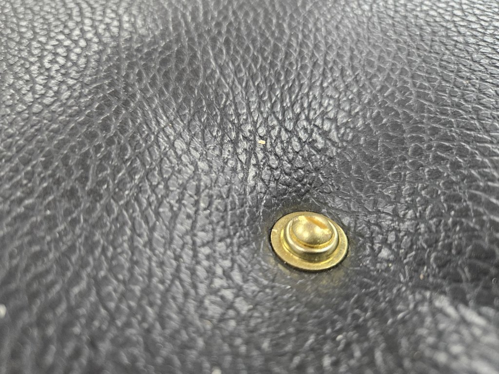

    Boy, they're awfully hard to describe through the lens of culture and perspective, so just imagine the author has described a perfect "mad scientist" type cackle.
    I sure have no idea what these surplus US Gov't aerospace fasteners were originally meant to do. They are M8x1.25x35mm button head flathead fasteners. I have no idea what someone originally paid for this thing, but I got three of these for way less than one brass JIS flanged or even one brass plain hex bolt.
    The plastic and some of the aluminum for the deck came today as well, I am waiting on a miracle local supplier to take care of my chump-sized order for 1/2" interior, 1/8" wall aluminum channel and a hank of 3×1.5x1/8 wall aluminum tube.
    I think I will heat form and install the trim first, as it's just a matter of zipping some strips off one of the sheets and a (long) single 90 bend. I'll have a look in the junk bin and see if I have enough leftover edge trim to do something with, and they're going on with VHB or window seaming, whichever seems like will do.
