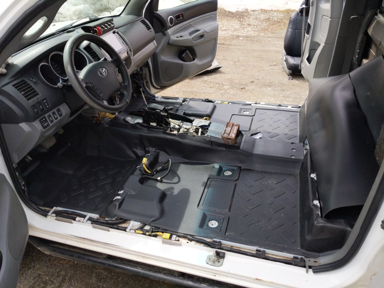

    Whelp, with all of the major mechanical stuff where I want it for now, it's time to start fuckin up the interior.
    Today's work was floors, seats, and center console.

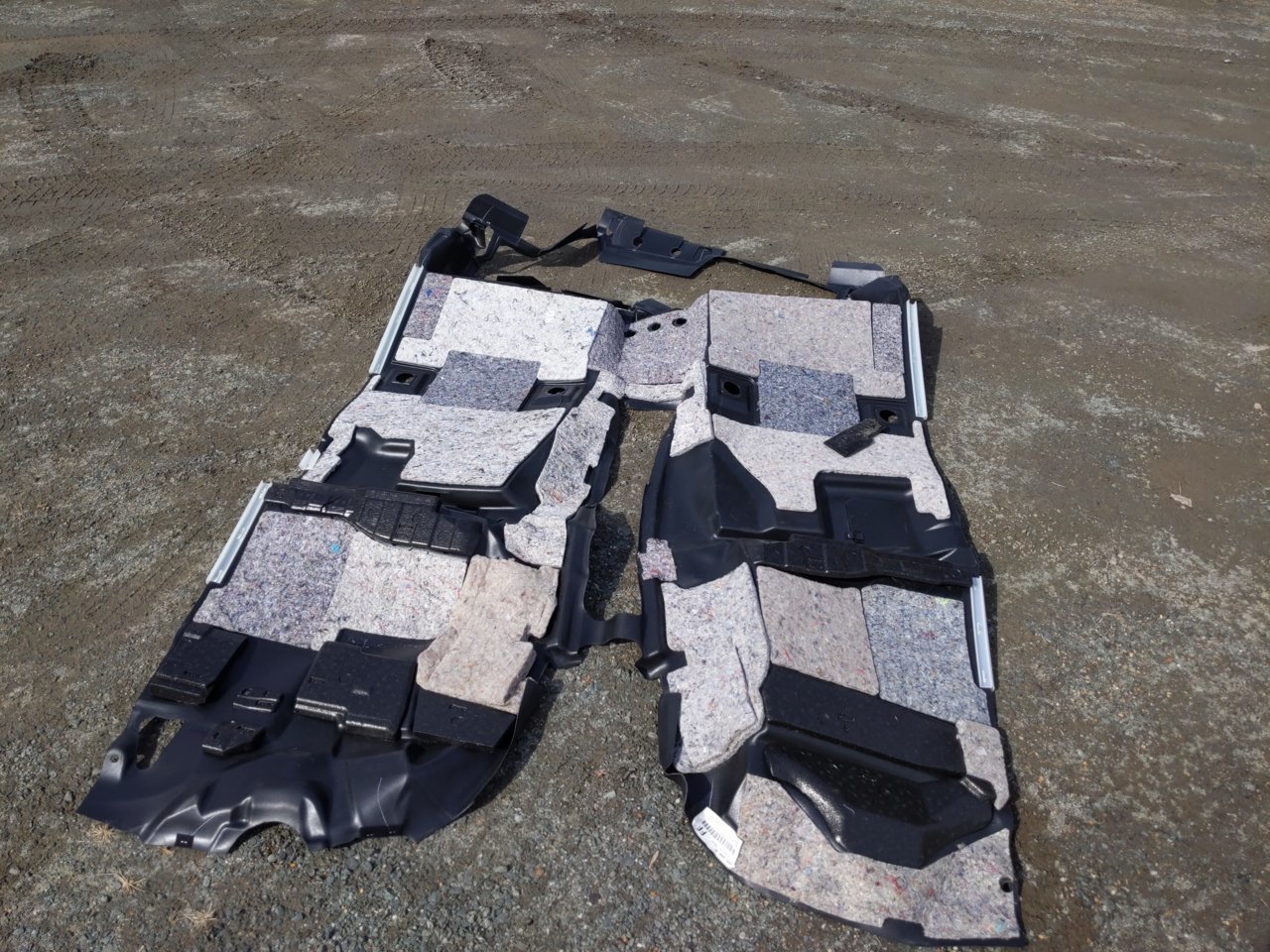

    It took a while to find a factory all-weather floor, but I did. I laid it out in the sun while I prepped for install and did the seats. Today wasn't exactly warm but it was above 60 finally, and it did make a difference in pliability after it sat for a few hours.

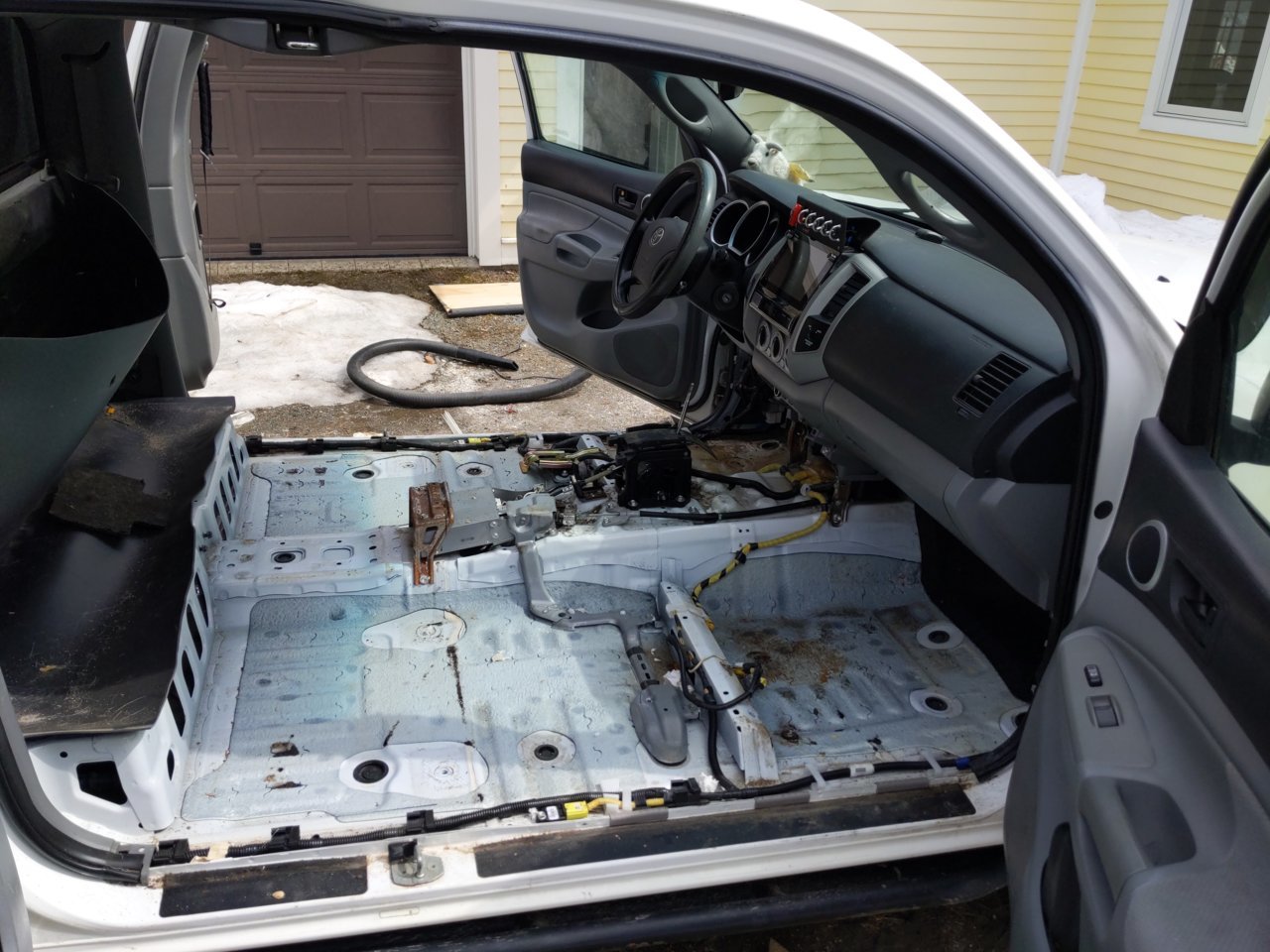

    The interior wasn't bad to tear apart. I was already familiar with the door and kick panel trim, and the center console only required one or two quick scrolls through some YouTube videos, mostly to confirm I really could just pop stuff out that seemed like it just popped out:
    Found a rodent nest inside the console. FFFFFFFFFFfffffffuuuuuuuuuu..... But it was obviously very old and not inhabited for long. Probably from the first spring I was in VT, before I taught the dog to pee on the tires and put a chunk of gutter guard on the A/C cowl vent:

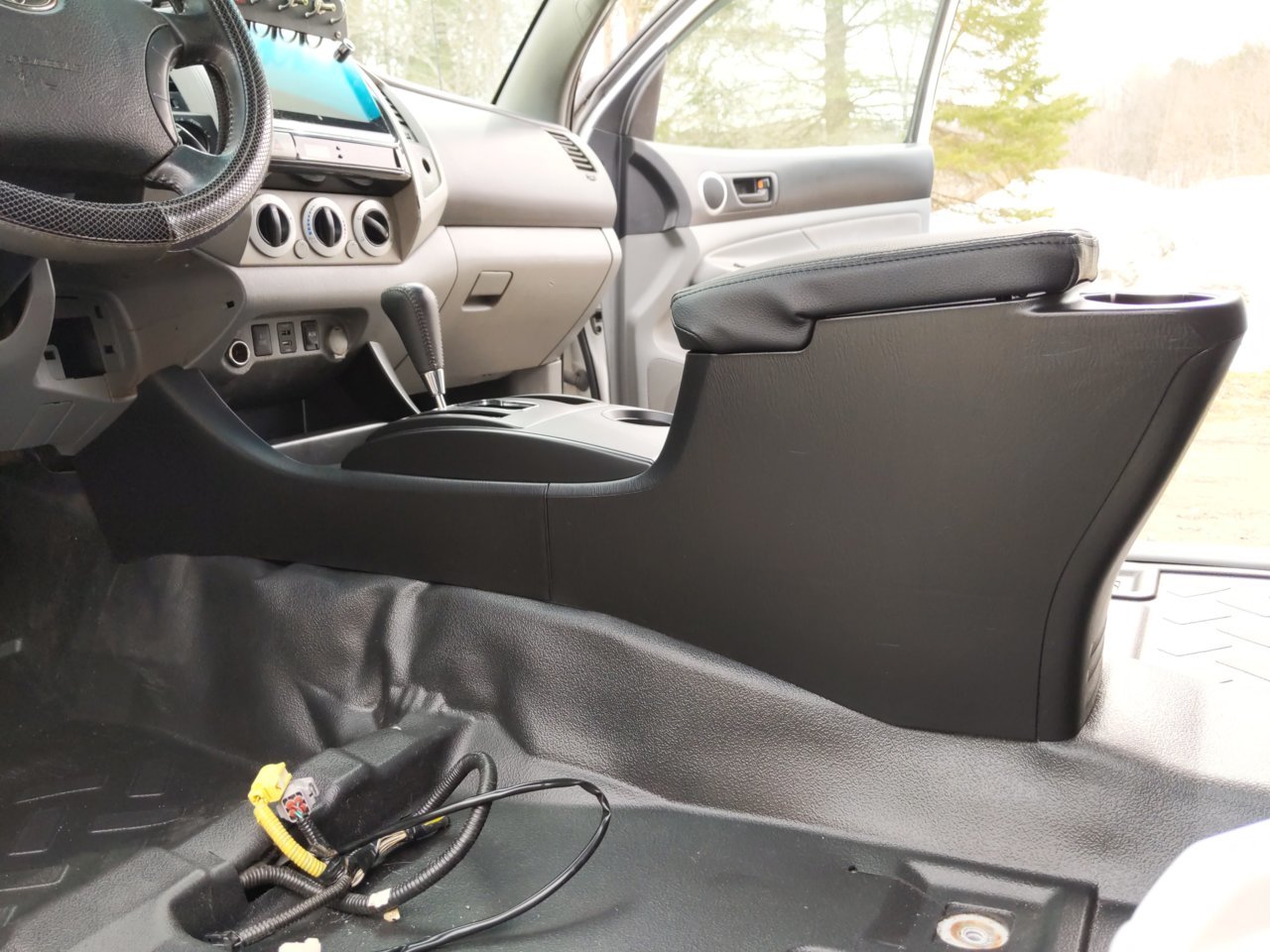

    After some general cleanup, including pennies wedged into places I could not believe, the floor went in like it was made to. (It... Was.) I massaged it as best I could, knowing that this summer I'll have the seats and console out again anyway and it will be much more cooperative:
    While it was right there, I also adjusted the parking brake tensioner inside the center console.

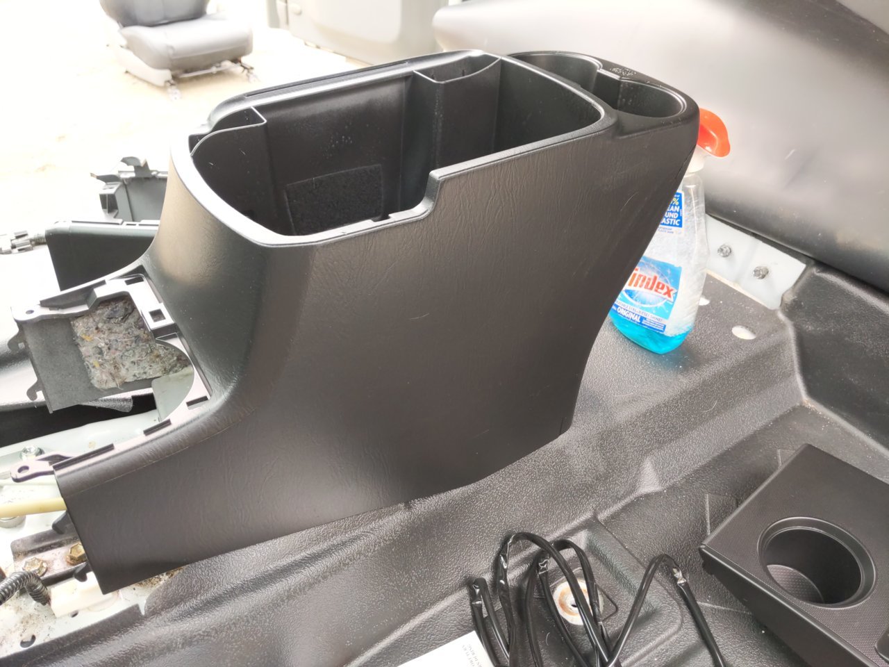

    I've wanted to murder out the interior for a long time and finally settled on SEM's vinyl and plastic dye:
    I scrubbed with soap/water/stiff brush especially in crevices with almost 15 years of junk caked on, then degreased with alcohol and rags, then used SEM's Plastic Prep and the dye with religious attention to the instructions:

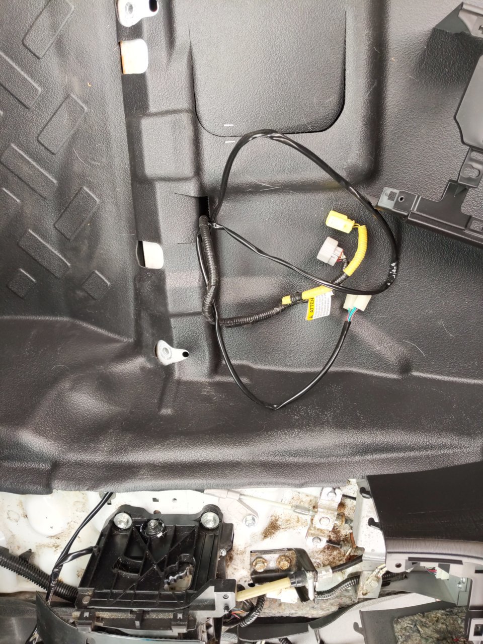

    Wiring for the heated seats (Leather Clazzios, done off camera because there is ample documentation already - I however note that the console lid cover was the worst part of this entire project) was run neatly inside the console and under the flooring:
    I will also note that the connectors on the Clazzio kit are mechanically decent but have relatively thin pins and are not sealed. I gave them a generous dab of dielectric grease to avoid any corrosion in the future. I track brine into the truck all winter and didn't want to have to worry about it.

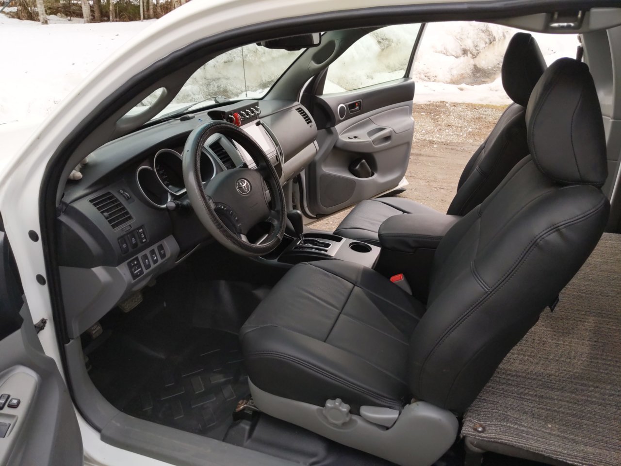

    Console reinstalled. Note the waves and ripples in the flooring. Again, it will be much more cooperative this summer, especially since it's going from a 90% fit to a perfect one instead of starting from folded up and frozen in a box:

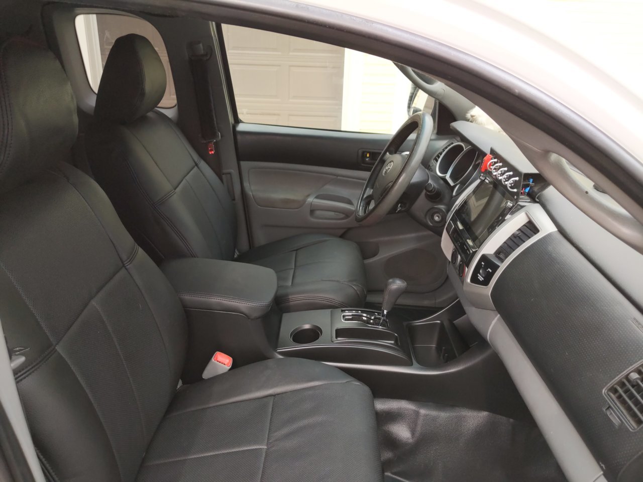

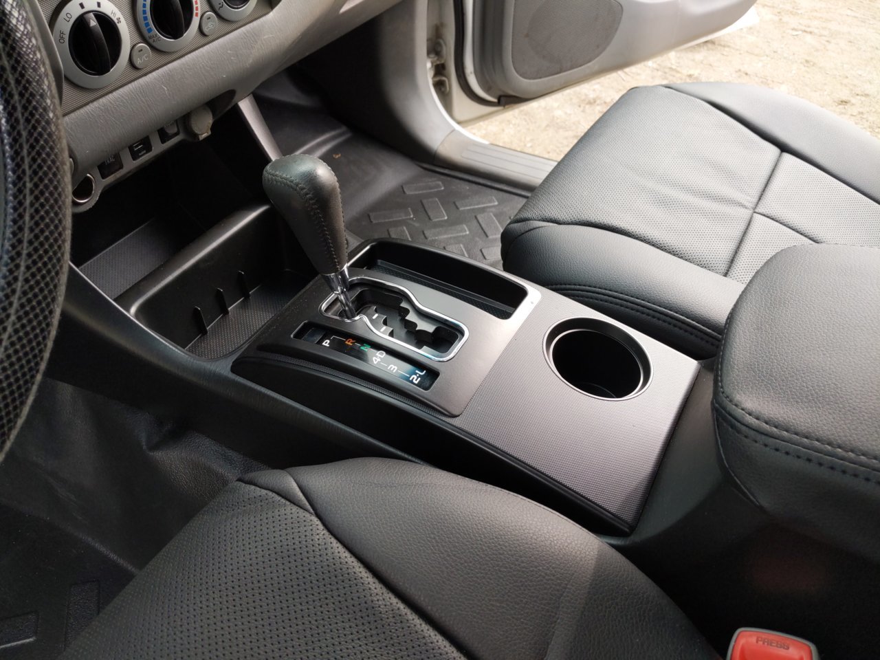

    Finished shots of today's work:

    Yeah, I did a ton of reading before going with the SEM product. It's what a friend of a friend of a friend who does high end custom/resto work uses, and a lot of the classic car guys use it.
    Something I'm gonna have to wait and see about is whether or not the specific Adhesion Promoter I used was correct for the various kinds of plastic. I'll keep the thread updated on durability. Can't find much info on full cure time for the dye, but it dries to the touch pretty dang quick. I'm betting that the full cure time really depends a lot on the specific formulation of plastic, how old/UV'd it is, temps, and so forth. I'm gonna be real careful with it for a week or so.

    I'm gonna tear all mine out (lower dash, glovebox, etc) when I do them like I did with the center console. I need to do a lot of wiring work and that will also be easier with it gutted. I used SEM Color Coat on the console and it went on great, and all the other panels are the same material. I will probably do the door floor trim and kick panels (and maybe the lower seat trim panels) with black bed liner for durability, I really stomp the hell out of them.
