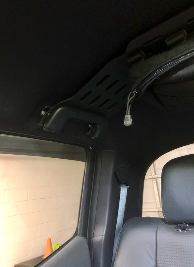

    Finally installed the OEM handles.. love it!
    Anyone else with them on.. do they not close all the way after you pull it down? Seems like I have to give both sides a little push to completely return.. not a big deal, just curious.. maybe it's the angle they're at on the rack.. not sure.
    Regardless they look awesome. I got some 2 inch bolts and basically just screwed the bolt in and it took the washer down with it haha.

    Did you have to shave down the back end?
    To install them into the rack?

    Yea.. I bought my first dremel lol -- it was easy. Cutting the little plastic pieces lets the piece sit flush on the rack. It took on a couple of minutes to cut the excess plastic. I saw someone said they used pliers and a razor blade.. I tried it at first but eh.. the dremel made it so easy lol.
