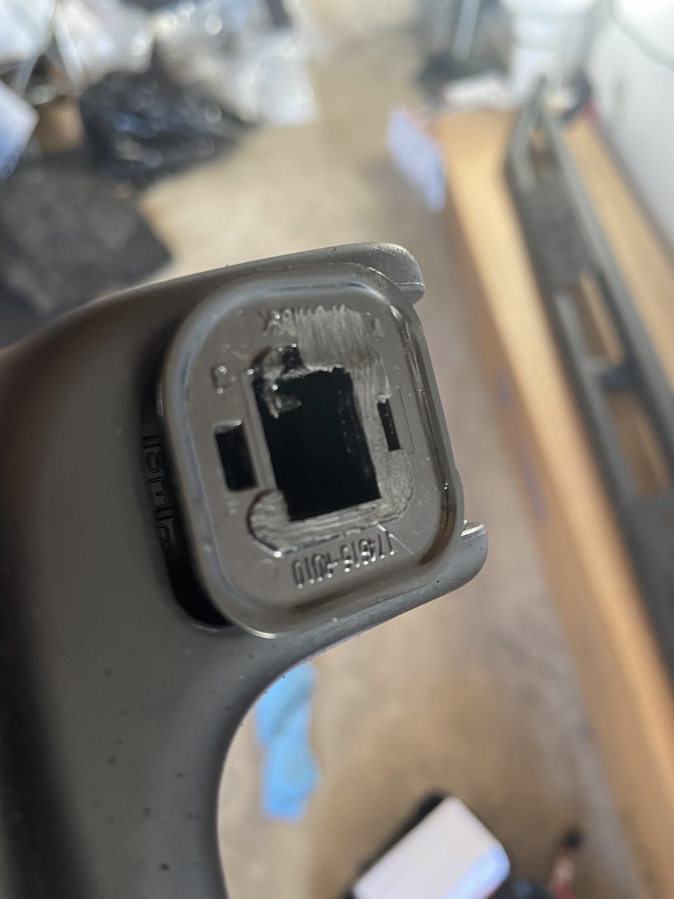

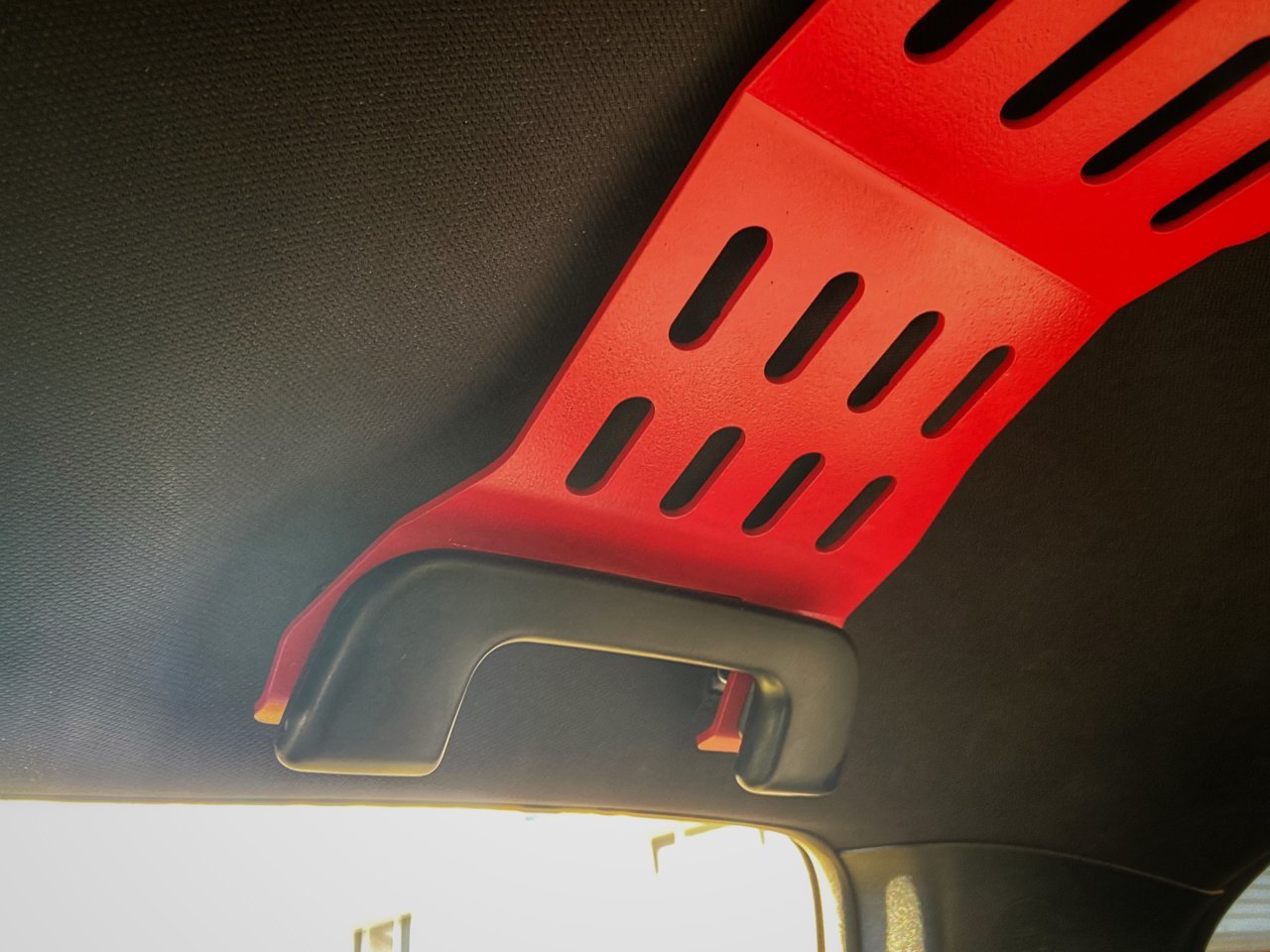

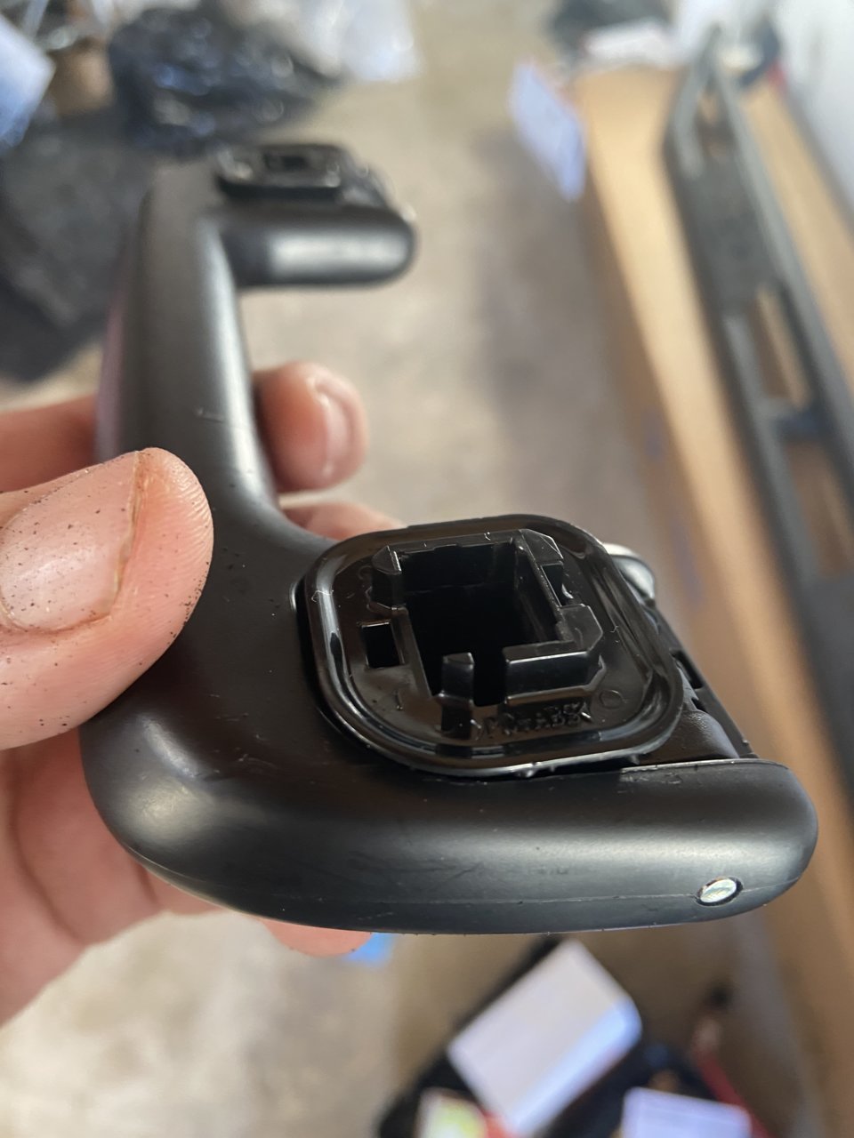

    What you do to get the grab handles to attach?

    grind the back of the handle and longer screws I would think. Seems what most people have done

    I dremeled them down. Took five minutes. Then took a round file and knocked down any burrs. I swapped out to 2” bolts. Bolt and washer go through handle, through rack, through spacer, screw it down and bobs your uncle.
    0D329560-416E-4D80-8E58-F1BFC6DF3A1E.jpg 6319D93C-9E9D-41D0-BD4B-61EDDF78F0AE.jpg
