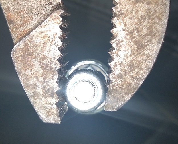

    I also had a little trouble with the rear inserts on my sun roof model. They just wouldn't go into the factory cutouts. I was able to squeeze them down just a bit. I threaded in the install bolt first, to avoid crushing the threads. Then gave a pinch with the "channel locks".
    the second picture shows one of the inserts after i worked it enough to fit.

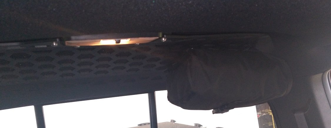

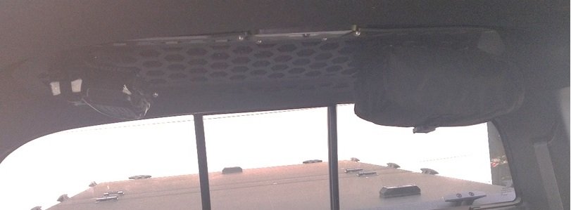

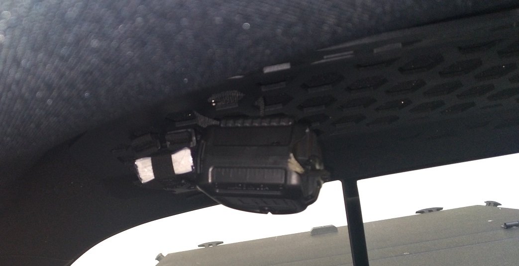

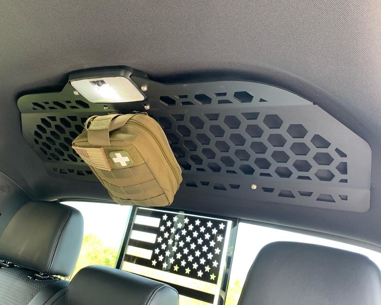

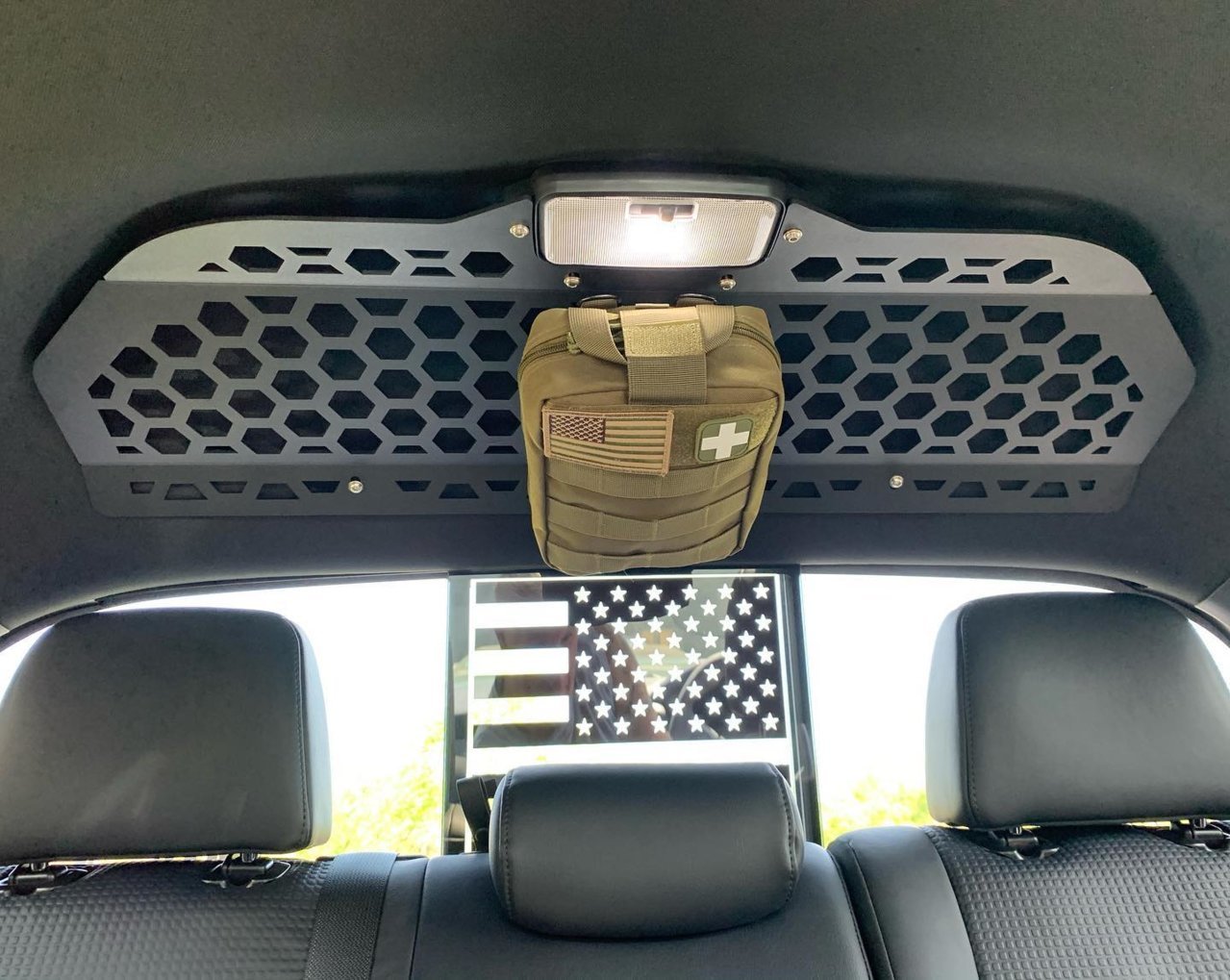

    sunroof model installed:
    Full rack:Untitled.jpg
    First aid kit:
    Passenger side wide view:
    Tactical tissue packet:

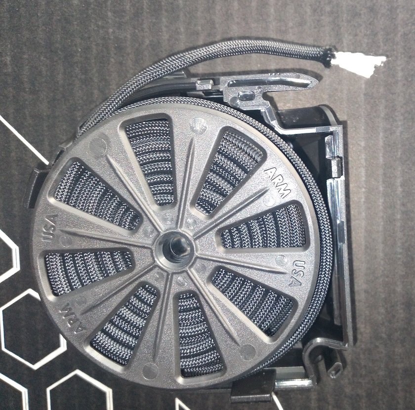

    Tactical Rope Dispenser---Soon to be repurposed as a Tactical licorice dispenser. Should be an easy upgrade.

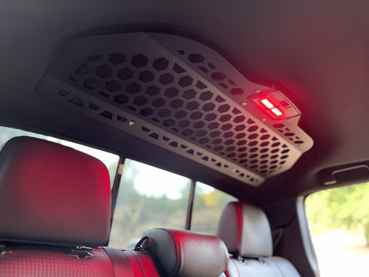

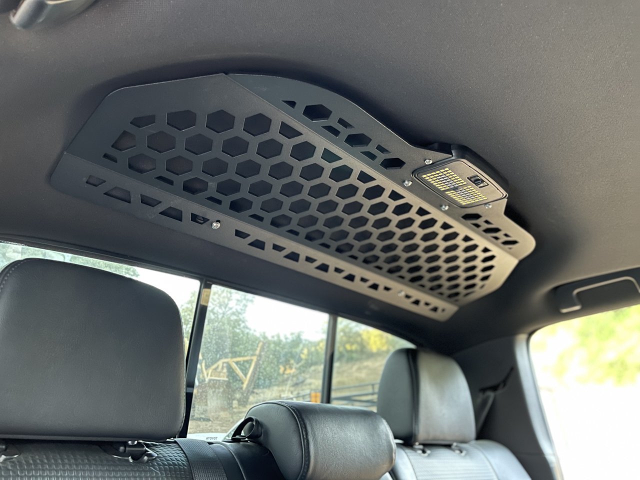

    I put mine in this morning. I found that removing the dome light was a little harder than in the video - besides the 4 clips shown, there are two others that have to be pushed back to get it to release. Once I figured that out, it pulled down easily. I also used a little "percussive maintenance" but hitting the back of the jack nut tool to get the jack nuts through the rear openings. The fronts went in easily.
    Great quality as usual.......but now I am really lusting after a V2 Dome Light. :drool::spending:
