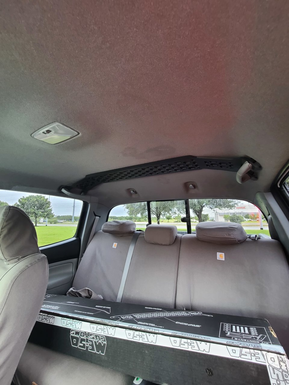

    Finally got mine installed today and love it!
    It is 100% compatible and even easier on 2nd gens as we have threaded holes already. The only difference is the handle retention requires modification to the grab handles, not an additional purchase.
    Forgot to snap pics but in a nutshell you have to grind the premoulded spacer on the base of the grab handle flush with the base. It has a portuded area on the mount so the handle fits flush through the headliner. The rack is flat so the base needs to be flat. I just used the belt sander we have at work to grind the base flat and it sits flush on the rack.

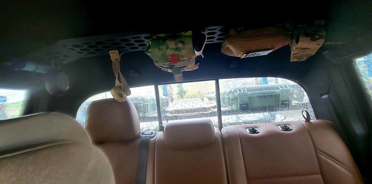

    I'm pretty happy with this setup. Thanks @MESO for the sick products.

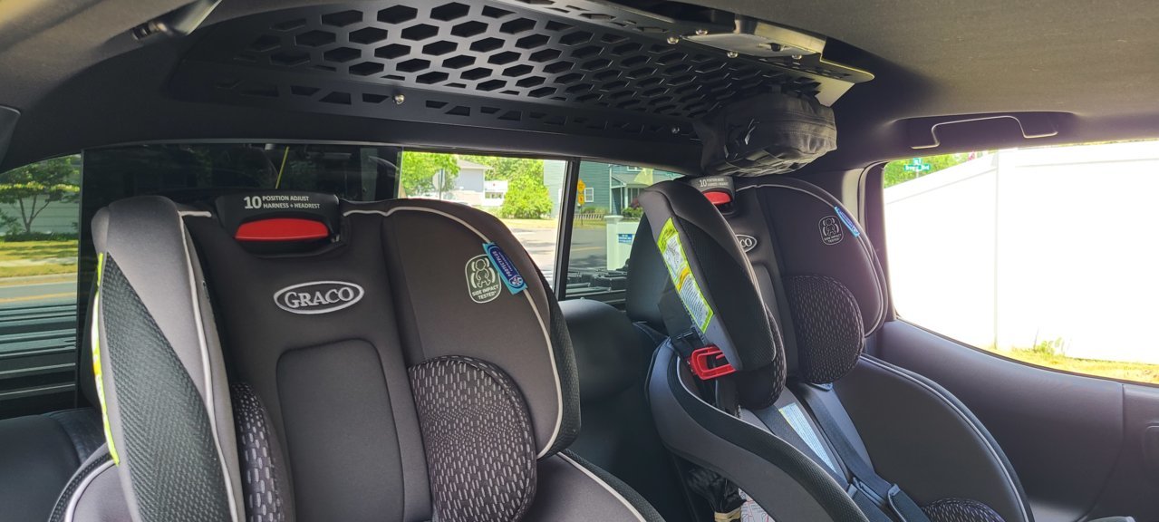

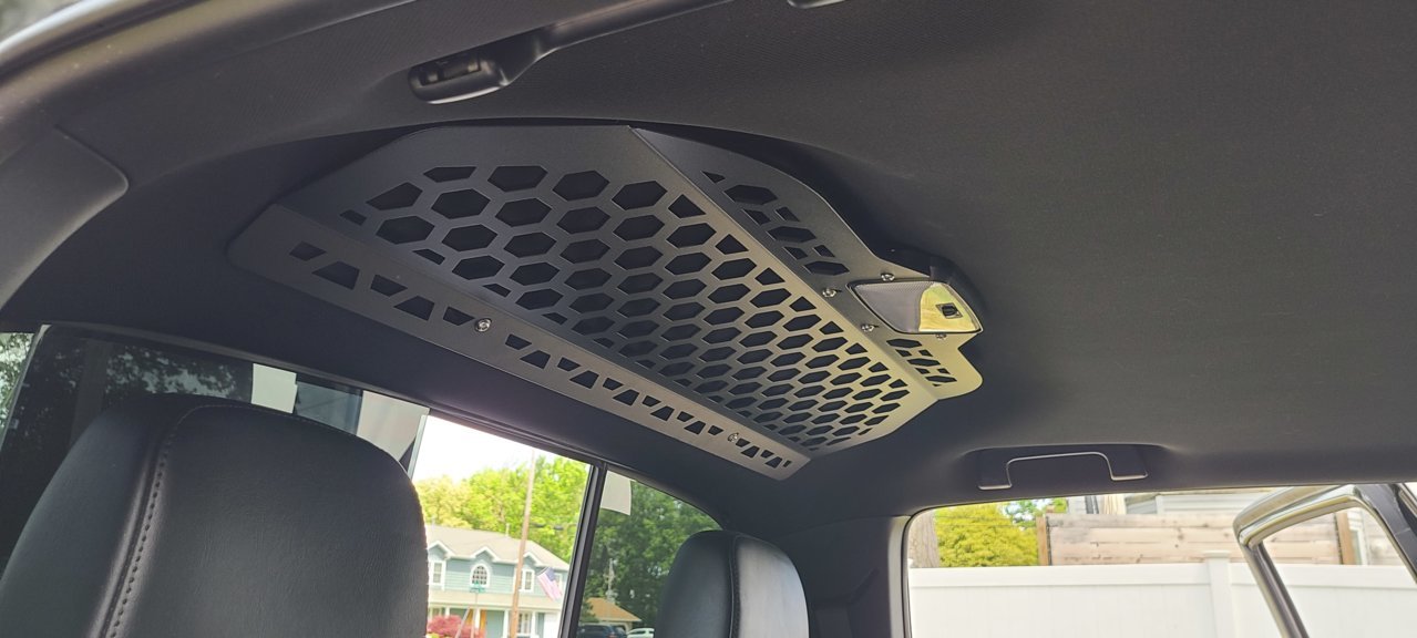

    Definitely a tight fit. My dome light had a very short lead so the toughest part was getting the bulb housing back into the bracket and all that jazz..
    I noticed the dome does angle back slightly, not a big deal at all.. I removed the rack a couple times just to mess with positioning or pitch, but it kind of is what it is due to how the new dome bracket sits in the little recess. Assuming the bottom corners are tight against the roof for everyone else?20210523_114758.jpg
    Going to figure out how to close the gaps around the sides of the dome light.

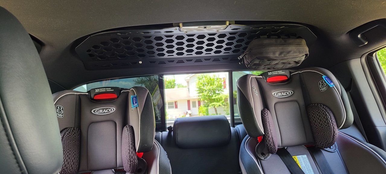

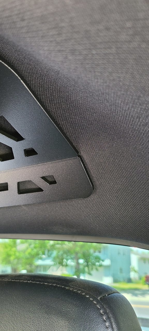

    Photo of car seat clearance for anyone interested.
    Even with a pouch strapped, my kids should fit no problem.20210523_120728.jpg 20210523_120740.jpg
    An adult won't sit comfortably if you have a pouch strapped up, especially if they are sitting in your toddler's car seat, but we all knew that already with how tight the taco cab is by itself

    I am 6' even, the button on my hat touches the rack when sitting in the back.
    Good thing I don't really ever have passengers.

    Same here with the visible gap on the left and right side. It would be nice to of had the dome mold cover more of the gaps, but for me it is not a deal breaker.

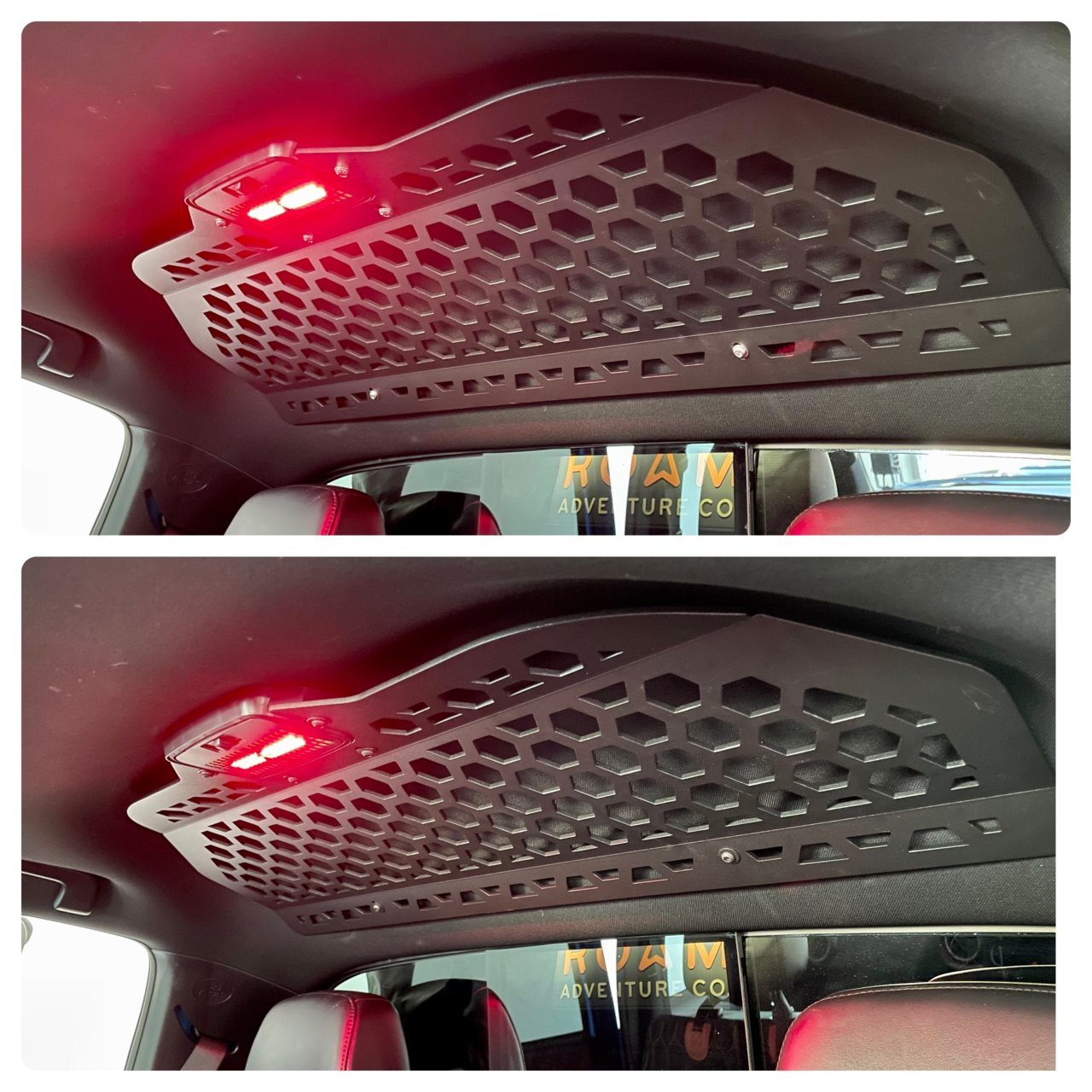

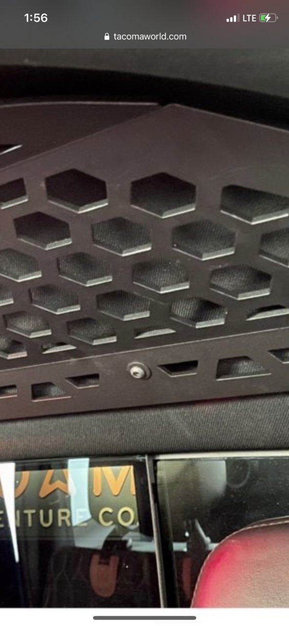

    Got around to swapping the bolts out for black ones today .
    before and after

    Looks the same

    Top are the stainless bolts and washers. Bottom is the black oxide bolts with washers. Looks diff shiny to black to me ‍♂️

    Haha definitely see the black washer. Bolt looks like a not as shiny stainless
