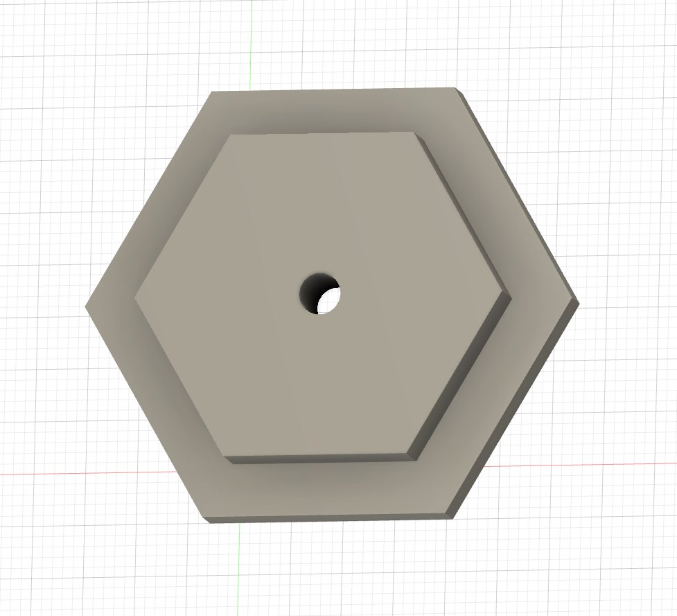

    Do you just screw into the plastic of the hex plates? A recessed hole on the back that a nut could press fit down in and give you good thread engagement would be nice.

    I am just screwing into the plastic currently, yes. I made the hole size just right for the screws I am using. I will post a revision with a recessed hole in the back for a small nut, as you suggested! The trick will be to get the right size/shape for that hole. Different screws would take different sized nuts. Best bet would be to find a screw size that works with your average quick fist, and find the nut that goes with that, and design around it. Best use would include said specific screw/nut specs so the hole is the right size for the screw, and the recess the right size for the nut.

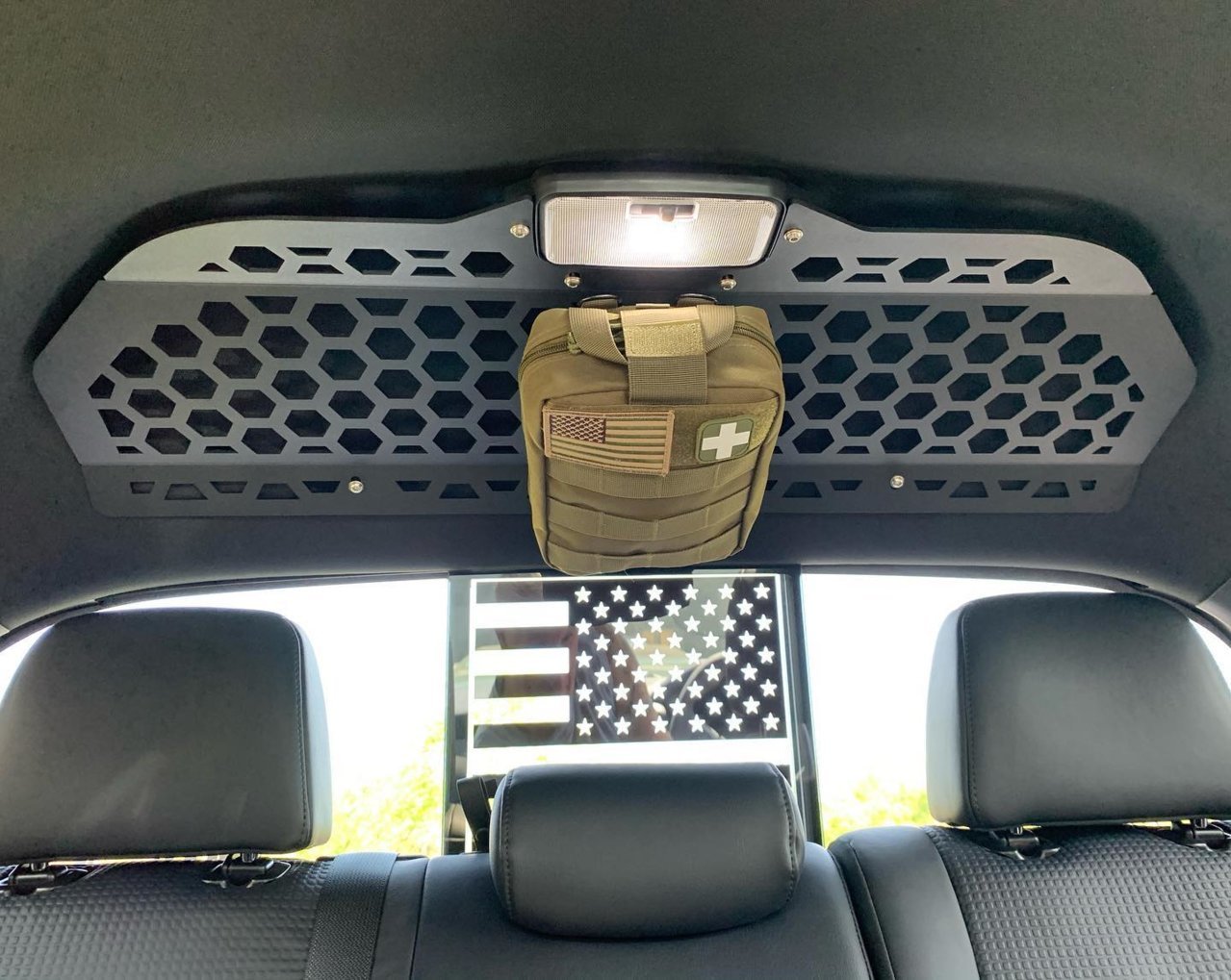

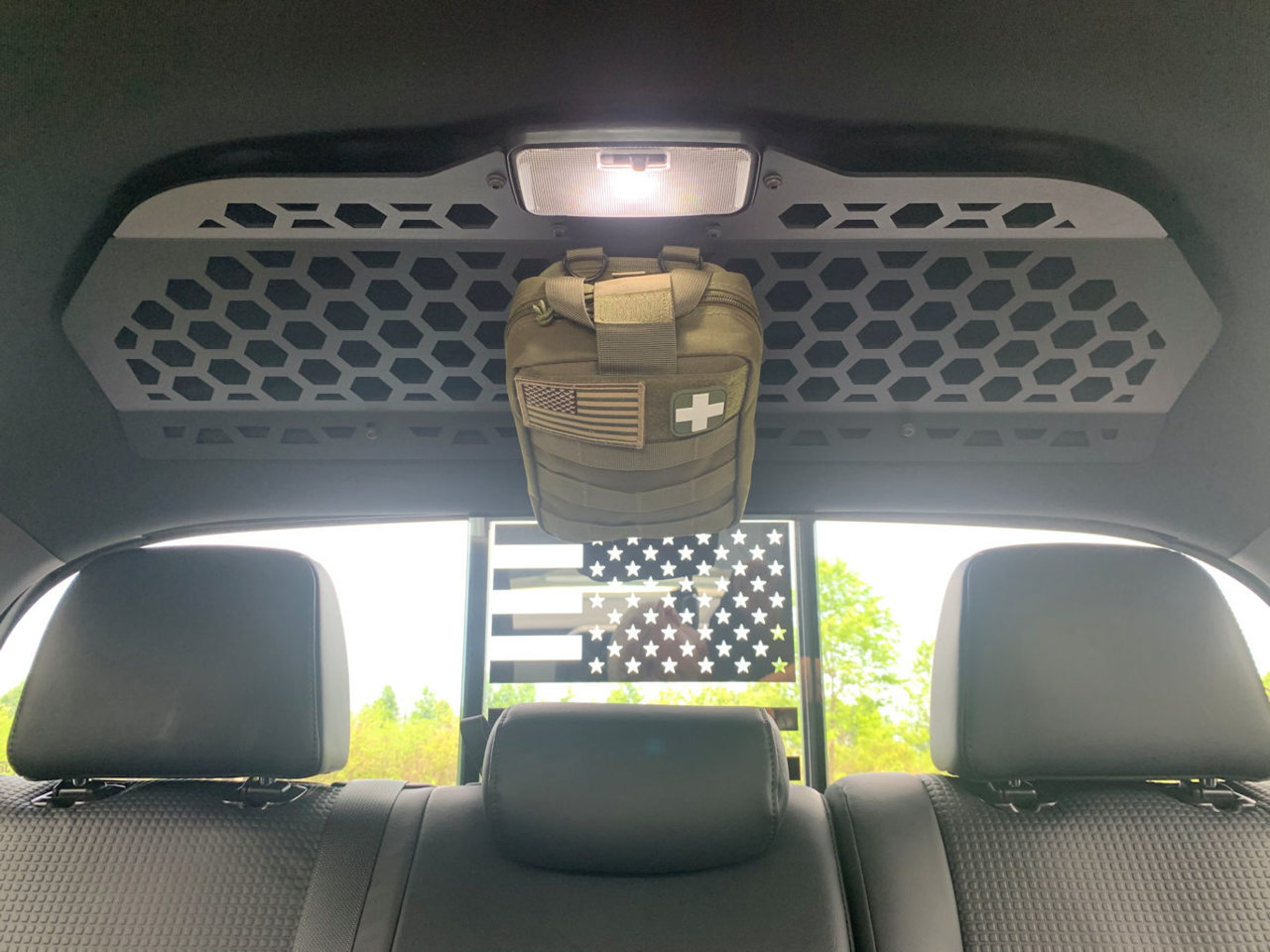

    I swapped out the stainless screws/washers for black oxide screws and black fiber washers today. Color me odd but after pretty much eliminating all the chrome in the interior, I had to swap these, too.
    I really love the quality and function of this rack. Well done, @MESO !!
    Now I'm truly jonesing over a set of the V2 Dual Color map lights and the V2 Ultimate Dome light. Of course, I will be travelling in the coming future and it would be just my luck to miss the restock.
    With stainless steel screws/washers.
    With black oxide screws/black fiber washers:

    I concur, black hardware is the way to go. I will have to change for future production.

    I changed the design of my coat hook, it was sticking down too far interfering with the rear view. When these are done printing, I will double back and perfect the single hex mounting plate. I am rushing to get these prototypes installed before my camping trip this weekend, so I can try them out. So the single hex plate should be ready next week sometime.

    I ordered M6x1.0 20mm & 30mm (length) button cap with hex drive, and associated nuts/washers for the single hex plate. They should be here over the long weekend. I will design the plate to work with those, FYI. The length needed might be different depending on what you're trying to mount. I have some quick fists laying around, so I will include fitting those in my design process.

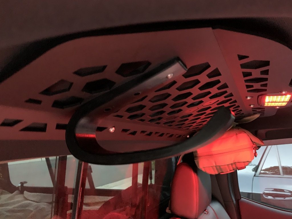

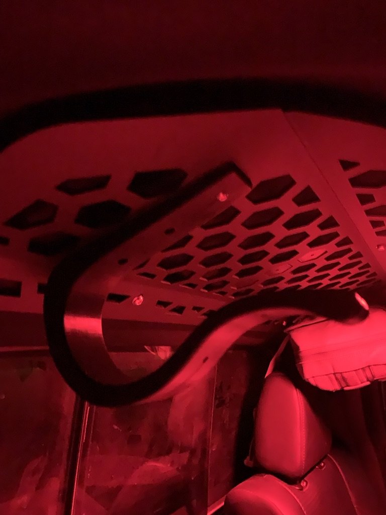

    This shape works better. Roll up my North Face rain jacket, slip it into a pair of these hooks. Why do I need quick access to my rain jacket? Because its raining! :crapstorm:

    Second hook finished printing over night. Just put it in. It does the trick. Med pack is in the way of the rear view a bit, will probably move it or mount a smaller pack there. Now, on to the hex plate. Still waiting on the bolt/nut hardware to get here for that design, however.
