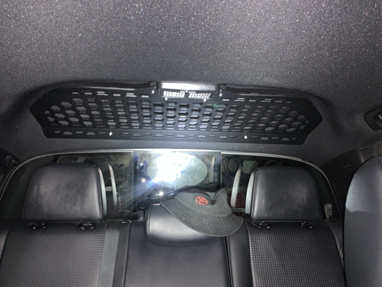

    Okay! I took the dive and installed the sunroof hexrack despite my concerns about the gap between the factory dome insert and the dome light itself.
    I'm blown away by the thought and attention @MESO put into this thing. I agree that the full picture will be pulled together with a meso v2 dome light, so again, I'm greatly anticipating the restock. The gap does exist but it does not pull the eye as much as I was concerned it might. The hexrack itself hugs the roof's shaped molding uniformly and adds a really nice aesthetic. It's also sturdy as can be. I just took the truck down a dirt road, with significant washboard, at speed and the rack appears entirely un-effected. Another win, Stu. Thanks for the work you do!

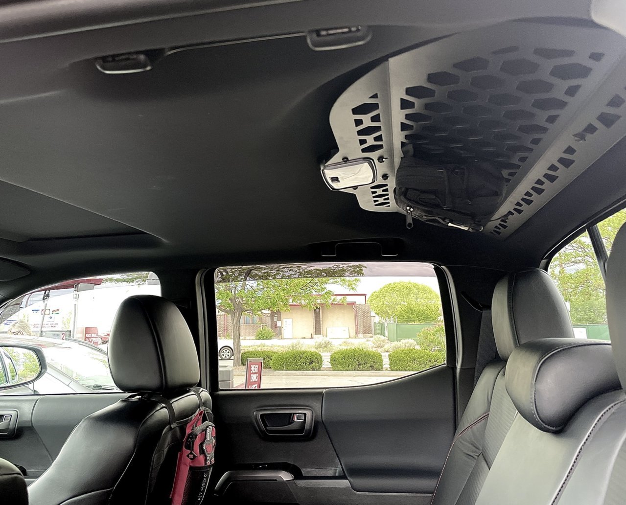

    A few photos to show how I converted the Sunroof panel to fit my Access Cab. I know the photos are huge. Wish they weren't, but I'm lucky that I got some attached at all, so I dare not try to reduce them.
    Rear anchors line up perfectly (the hat hooks) so nothing different there.
    The front comes up too short to plug into the overhead light bolt holes.
    However, I reversed the plastic light adapter (MESO made) in the “u” shape cut-out of the panel. That did allow the through bolts to line up with the installed jacknuts in the ceiling.
    Now the issue was the two small screws on either side of the light fixture. I had to elongate the holes in the aluminum panel for alignment, a mere fraction of an inch. Maybe someday, MESO will re-work that plastic light adapter a few millimeters to perfectly center it, then it will work forward or rearward. Of course this will allow it to be installed wrong by someone with the sunroof model at some point (Murphy’s Law), but it would sure simplify adapting this panel to the Access Cab market.
    At this point:
    • The plastic light housing/adapter mounts to the ceiling using the long bolts. (I used larger diameter washers here because of the oblong holes in the plastic and wanted to have metal to add strength. They show in the photo.)
    • The plastic light housing/adapter mounts to the panel in the “u” shape cutout using the short bolts.
    • The panel mounts to the rear bulkhead using the medium bolts and spacers.
    • Because the light housing/adapter is now mounted backwards, a large portion of the ceiling recess (for orig factory light) is visible. And ugly! But... I am quite deaf (from my time of turbines & M2 .50 cals.) and require an additional speaker for my comms. That speaker filled the void I created perfectly and is now right close to my “good” ear. (One photo will show the red/white speaker wire I ran prior to mounting.)
    The worst issue about reversing the light adapter is that the panel is relying on the plastic light housing/adapter alone for structural strength. Not good!
    To enhance the strength I installed two metal braces (1 x 1/4 alu strips) from the ceiling jacknuts to the originally designed mount holes in the panel. They attach to the panel without the light adapter betwixt them.
    Because the light itself has depth, it required spaces for those bolts (from strips to panel). (Note that the photo of these bolts show two different types. I actually used a third type not in any photo. The photo also shows a two piece spacer; I changed to a one piece. More on all of that in a bit.)
    • Now the panel is supported from the ceiling, just at a bit longer moment (arm); which could compromise weight load. But I’m not keen on too much weight up there anyway due to crash-worthiness!
    • The light adapter is in place and functioning.
    • The rear mounts are secured in the rear bulkhead as designed.
    • I now have a functioning, centrally located, auxiliary speaker for my ham and CB radios.
    And it all is in my ’17 Access Cab!
    The photo of my alu braces (strips) shows them in design stage. Final product has the bends in the proper locations, the proper size holes, and are painted black.
    The proper size holes were about more than just allowing the bolt to pass through. My 3rd iteration of bolt type ended up being a carriage bolt, with the square nut (under the flat head) wedged / fitted into the alu strip. No good photos of it though, dang it. That locked-in carriage bolt also allowed me to simply tighten the nut at the panel (no back-up wrench up against the head liner needed).
    The speaker was mounted using aircraft grade nutplates. But the MESO jacknuts would work just fine. I did have to drill the holes to get perfect centering alignment of the speaker. That wasn't a problem, because just as the jacknuts don’t go through the outside of the roof, I was able to just drill into the same structural doubler which is dropped down off the roof skin.
    My photos are crappy and far too few. I was more interested in getting it all to work than I was in taking photos to share. My bad.
    Can only hope it all makes sense.

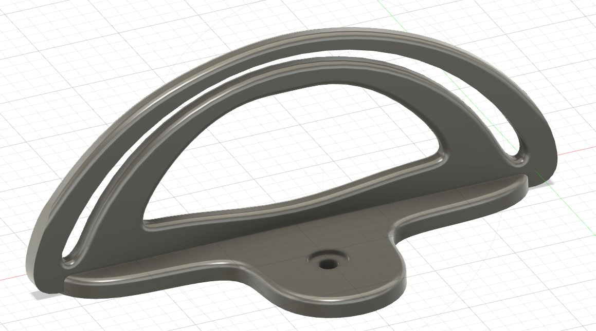

    Baseball hat slip/hook prototype. Slip the bill through the larger slit. I haven't printed it yet, but I will post pictures of the progression.
