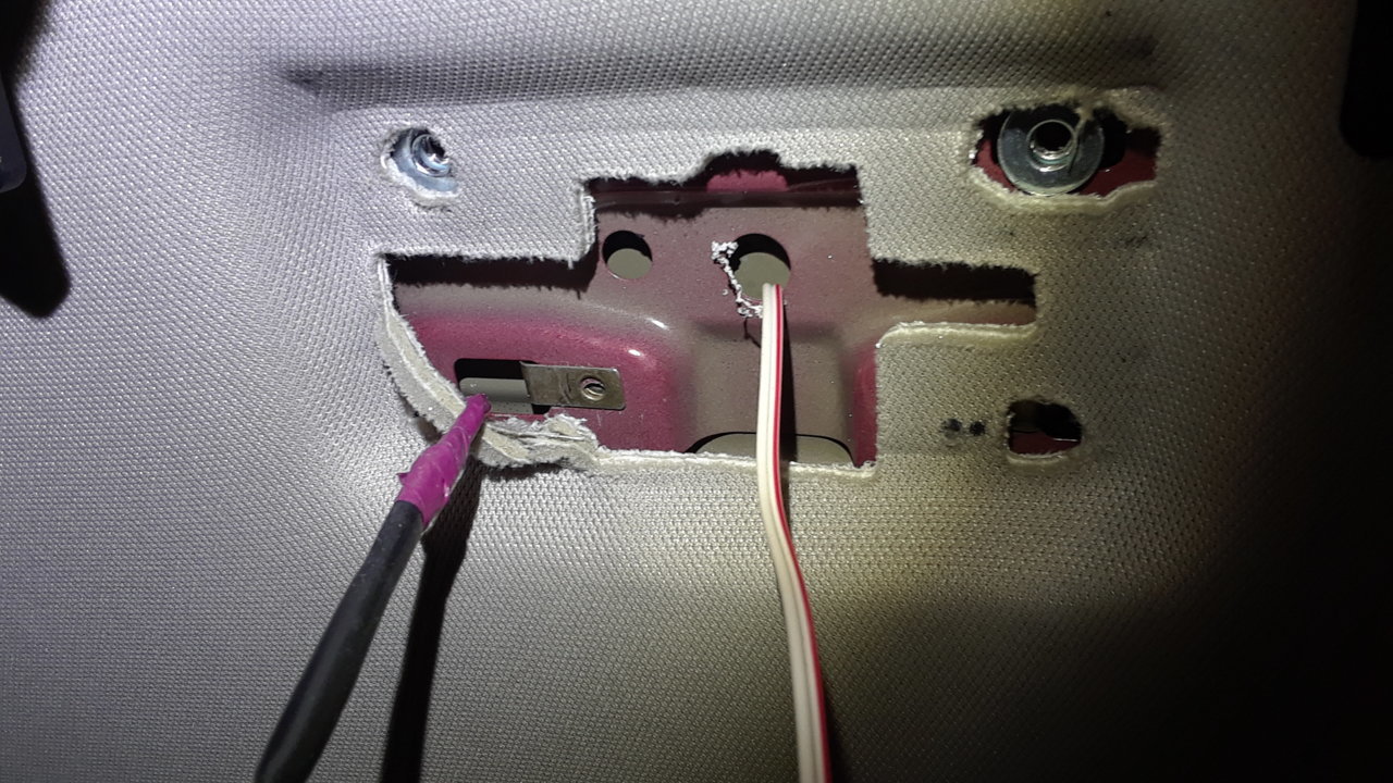

    Try setting the two on one side. Then spear the other two with screwdrivers on the second side. Once those two are in place you can more easily pull one screwdriver and replace with a bolt. Repeat for #4. You still have to hold it in place with some Popeye juice though.
    Also, make sure your jacknuts aren’t moving around on you. That’ll throw things off with the bolt.

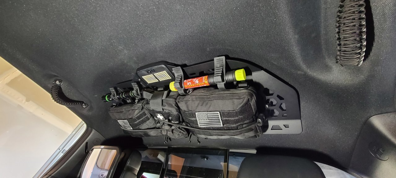

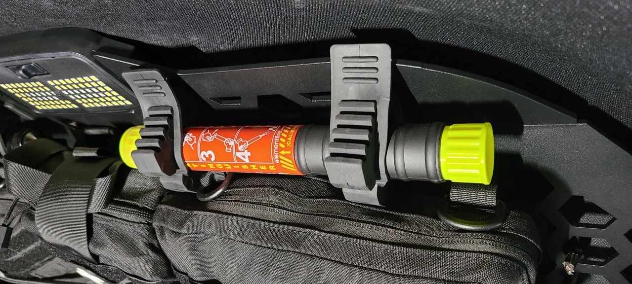

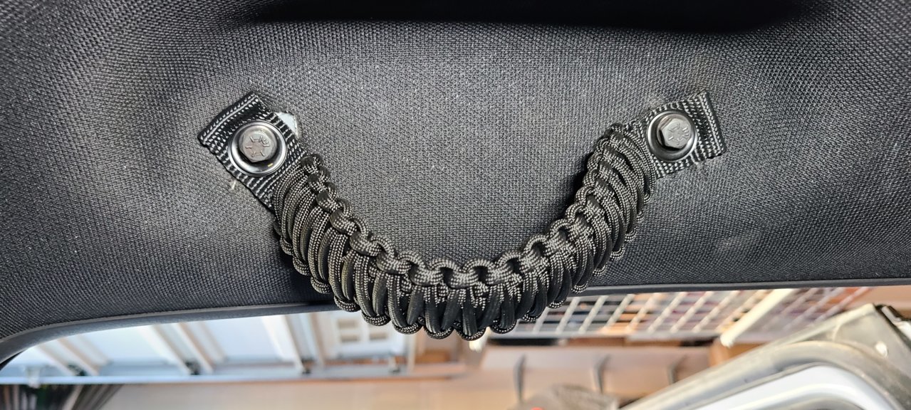

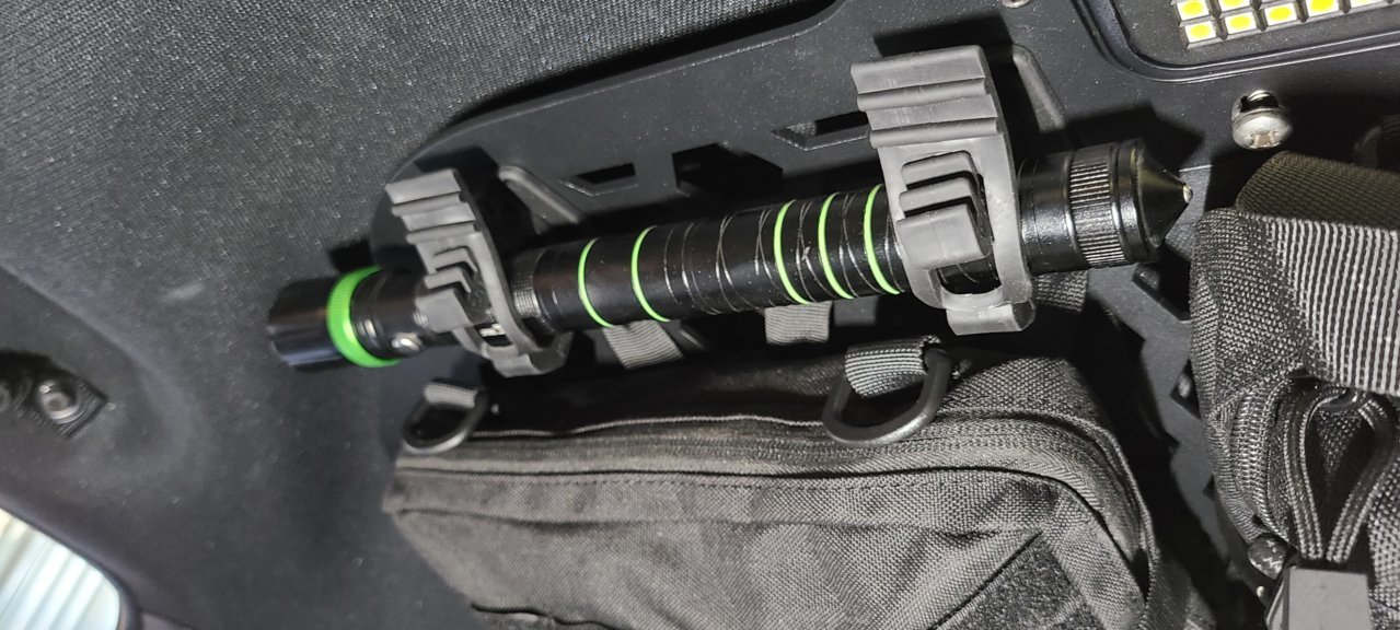

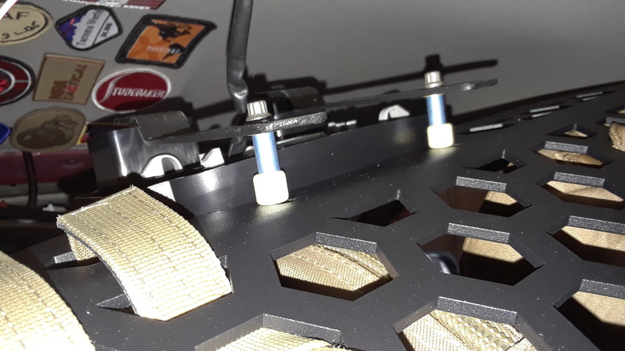

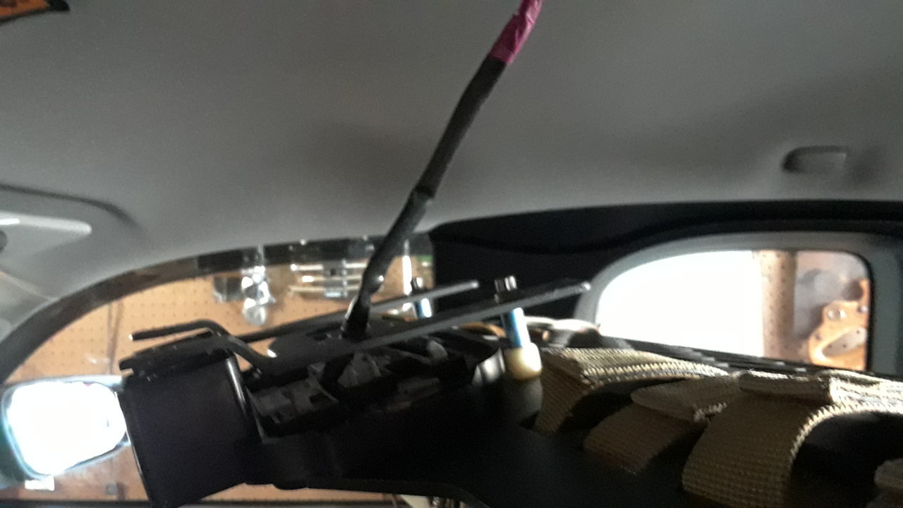

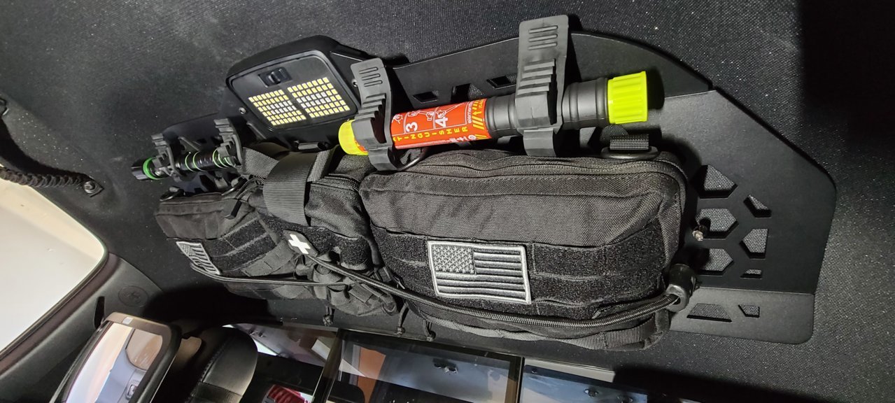

    Thanks for linking these! I used Meso's jacknut tool to install these and I really like them compared to the stock handles.
    Huge thank you to @reymataco for sending me some hex plates and hardware to install quickfist mounts for my fire extinguisher and flashlight!

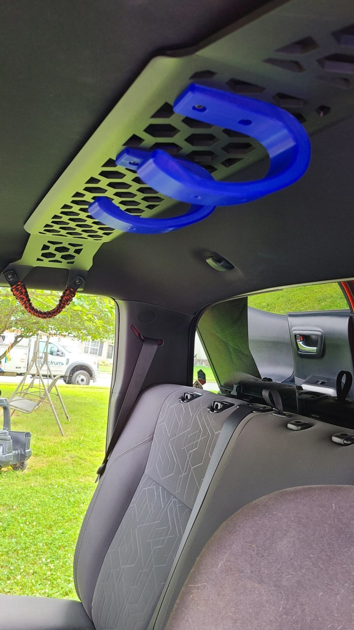

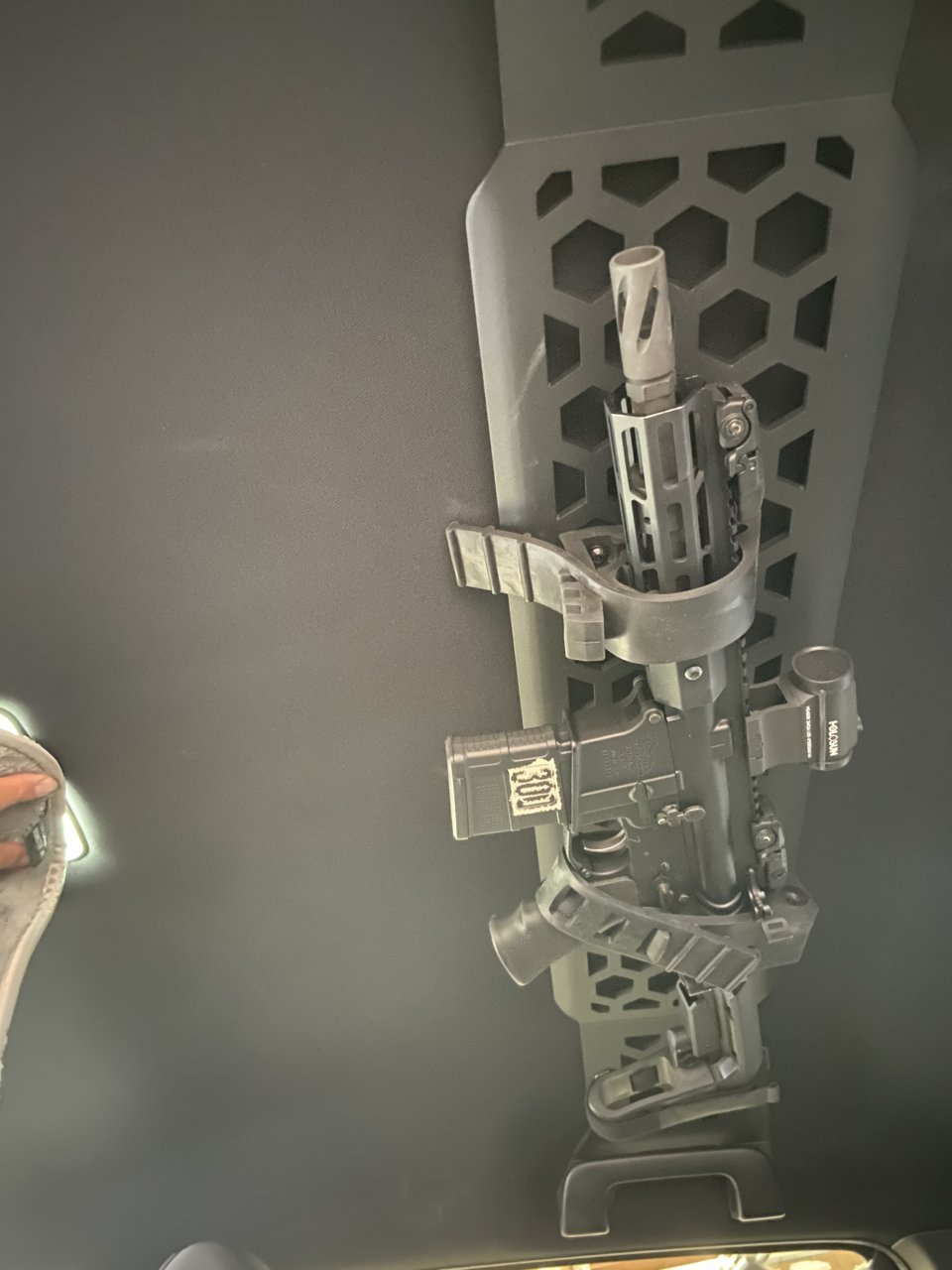

    Ordered my hex mounts from @reymataco and used quik fist gun mounts. Extremely happy!

    300blk. I approve :thumbsup:

    Needs some laser etched magazines!
