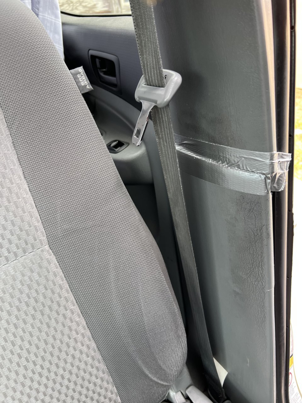

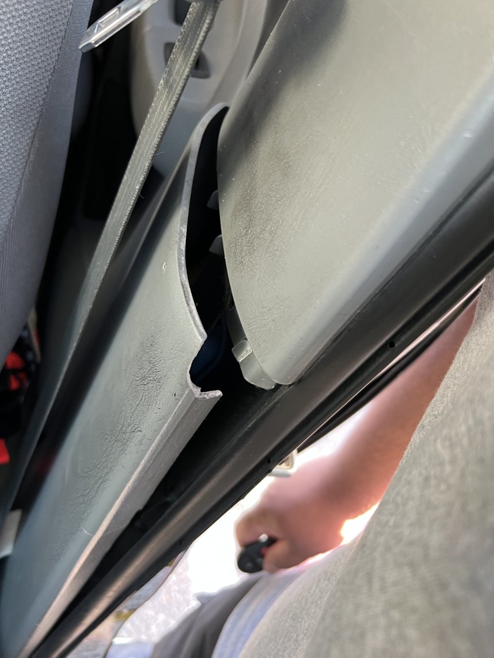

    Hello everybody I’m looking for a replacement interior pannel for my 2012 dbcab Tacoma any help would be greatly appreciate.

    Part number will be xxxxx - xxxxx (xxx) with the first five being general identifier (interior panel) second five being specific identifier (driver lower trim pillar B) and possibly the three digit suffix specifying color code if there was an option for your year.
    Should be roughly in the middle of the panel molded in in thin 1/4" tall numbers.

    The duct tape is almost a perfect match

    Looks like the P/N is 62414-04050-B0, but you should still head over to parts.toyota.com and punch in your VIN just to be certain. Go to 'Body and Interior' then 'INSIDE TRIM BOARD.'

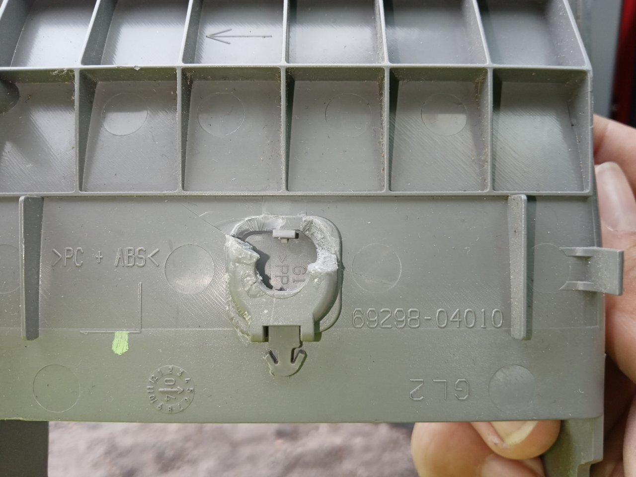

    Take off the trim piece and look around it. The part number is molded into the part it self. Here is one I need to buy myself for example with the part number on the inside.
