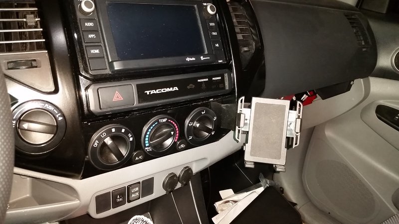

    Here is what dealer found:
    Black 4x4 selector switch - 84724-04030
    Black center console piece - 58805-AD010
    steveh_2007 and happy77m like this.

    Long awaited update. Painted lower shifter panel. Painted side panels and instrument cluster rings black. Swapped out 4x4 switch to the black one.
    Added phone mount.
    Thoughts: the interior is much easier on the eyes. The gauges are surprisingly better to look at. I feel the eyes are not distracted by the like they were with the silver rings. Everything flows better.

    If you dont mind sharing. What paint did you use for the side panels and shift indicator?
  19. Mar 29, 2016 at 1:33 PM
    #39
    BDub
    BDub [OP] Well-Known Member
    Sep 11, 2015
    #163961
    1,600
    Brandon
    Byrnes Mill, MO
    2015 DCSB Off-Road
    Duplicolor semi-gloss black.
    Just follow the directions. I ended up doing between 4-5 coats about 45 minutes apart. Once it cures its proven to be pretty durable. Makes touch ups easy if you need to re-shoot it.
