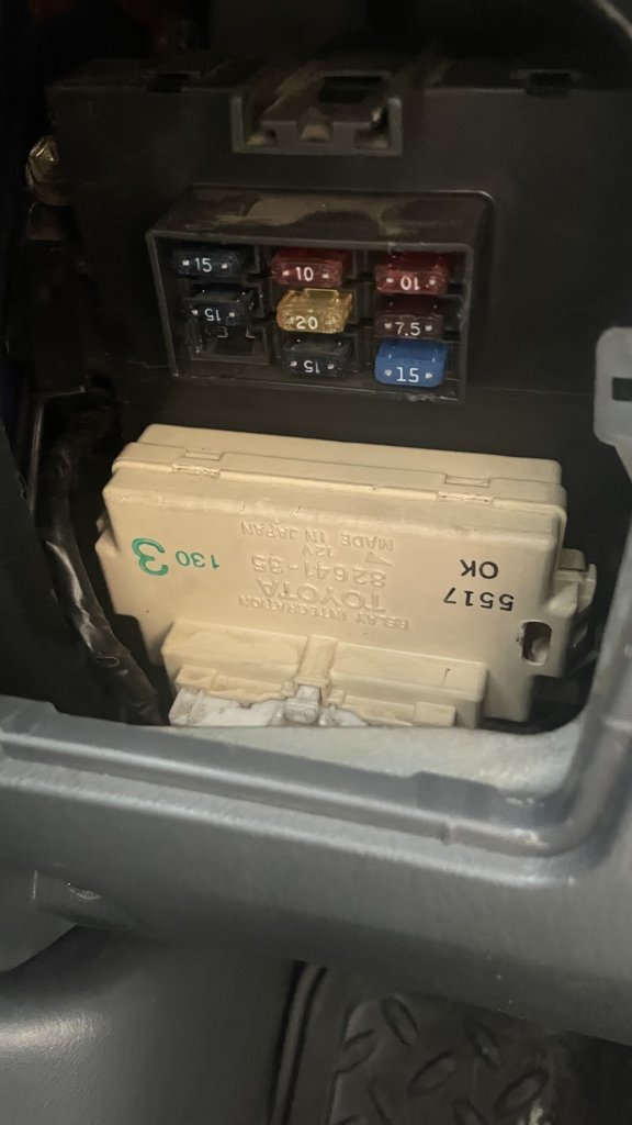

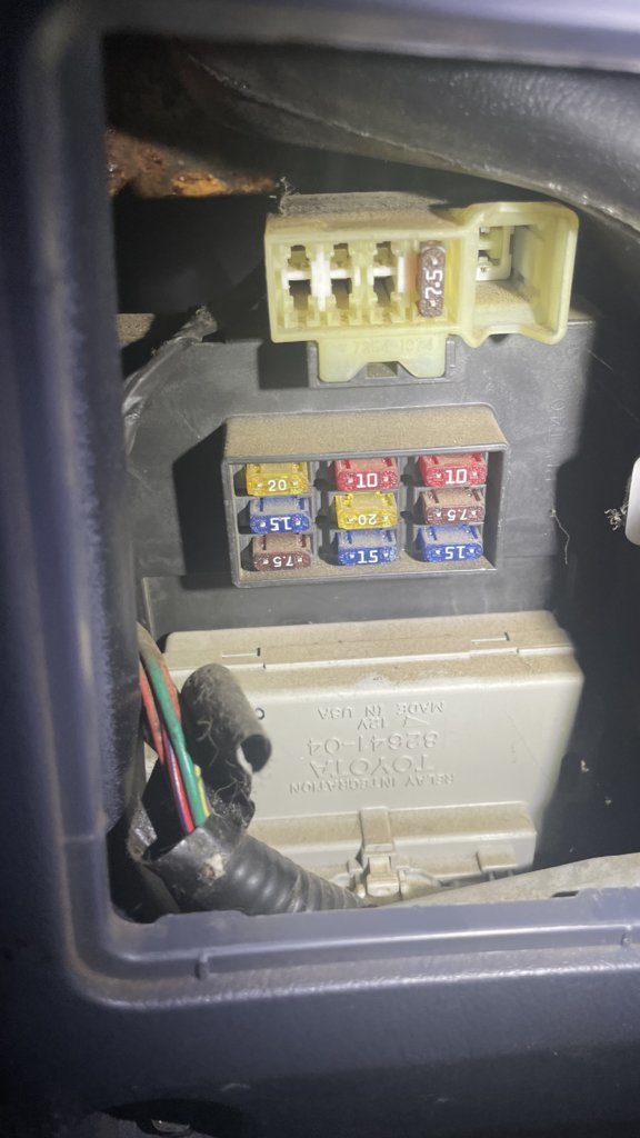

    Does anyone know if these 2 boxes are interchangeable? I have a 95 Tacoma 3.4 4WD and the part number for it is 82641-35. Im looking at a box from a 98 3.4 4WD with the part number of 32641-04. The only differences I can see is the 4wd fuse on the 95 is a 15a, and the 98 is a 20a. And the 98 also has a plug for what im assuming is a 7.5a starter relay. Other than that they appear the same. From photos ive found online the back relay plug locations look the same. The 98 has a little extra box on the top with a 7.5a which im guessing maybe its for cruise control. My 95 has the location for the clip, just no fuse location. Any help would be appreciated, thank you.
    1995 Tacoma 3.4 4WD Box
    1998 Tacoma 3.4 4WD Box

    A lot of little things changed from 95 to 98 I doubt that would work without at least repinning. You’d need to look over each wire diagram to be certain.
