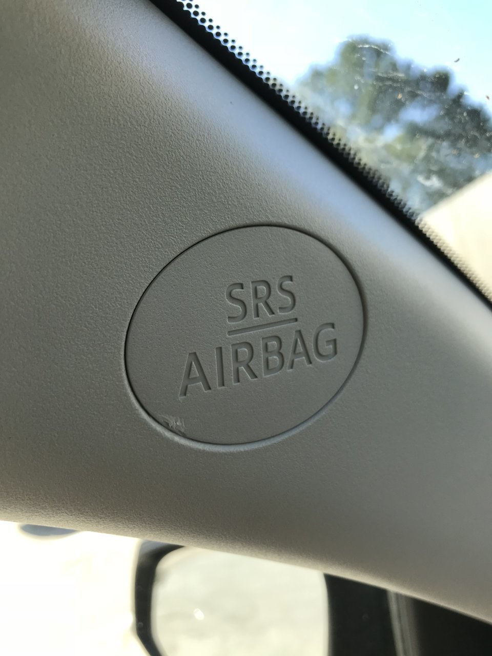

    Car audio installer left a small scratch on the metallic silver trim above my head unit. Very small but I look at it every day. Any good fix to buff this out or cover it up?

    They also messed this up. Something I can easily order a replacement of?

    The painted plastic is is prone to scratches, it's very weak. I have a couple on rear door handles inside and I almost never have passengers. The plastic cover however on the inside, you can just go to you parts rep at the dealership and I'm sure it will be a few dollars. But the installers should be paying for that, not you. It would make me question the workmanship they did to the electronics that you can't see as well.

    Sounds like the installer owes you:
    55476-04010-B1, Center panel trim gunmetal, ~$70
    62212-04110-B0, garnish front pillar LH, ~$60
    EDIT: Just saw yours is an SR5...55476-04010-B0, Center panel trim silver

    Before you go replacing the dash trim, try using a paint polish or plastic polish on it. It appears to me like it's a mark, or some type of paint/material transfer, not so much a scratch or gouge. If this is the case, a polish or even maybe a clay bar should take this off.

    You can also try slow work with a heat gun on the plastic.

    Pro is gunmetal, OR/Sport is either orange or gunmetal (depending on interior color), SR is black, and SR5 is silver.

    OP, use PlastX on that scratch. Will do wonders.
