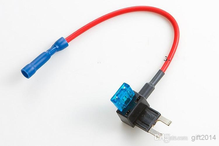

    There will be a constant 12v slot in your fuse box in the dash. Run the wire along the headliner to the front pillar cover and down into the dash by the fuse box. Use a fuse tap to connect into the fuse panel and mount your switch. IMG_0334.jpg

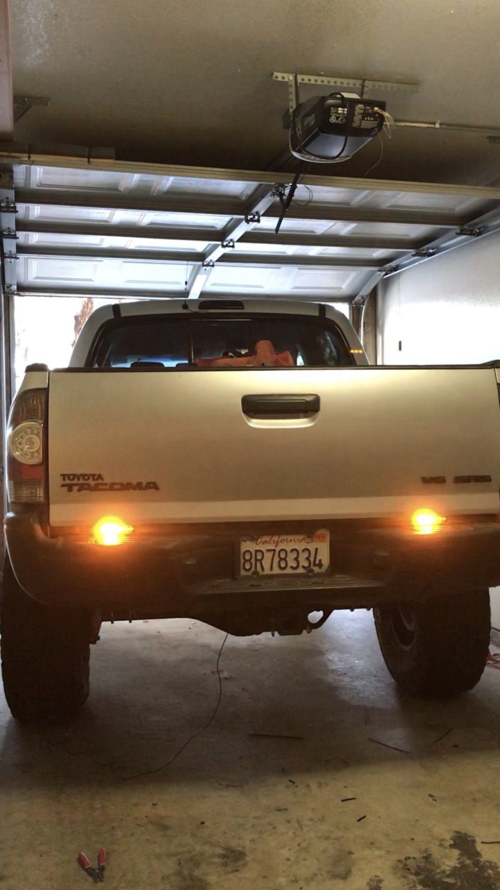

    I installed these to my blue sea fuse block...they are strobes
    ebrisse and stealthmode like this.
