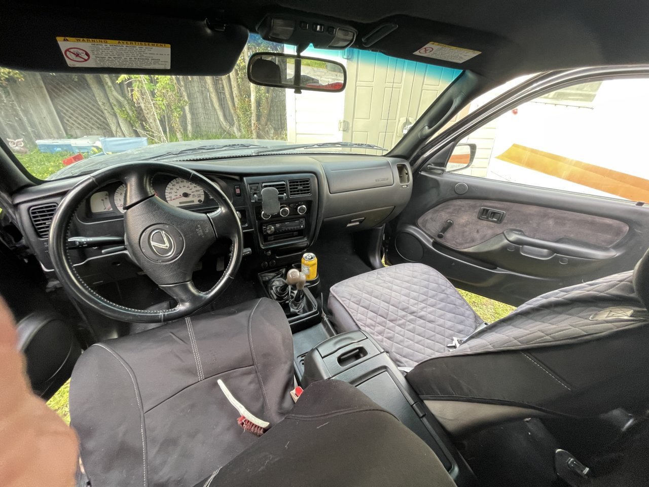

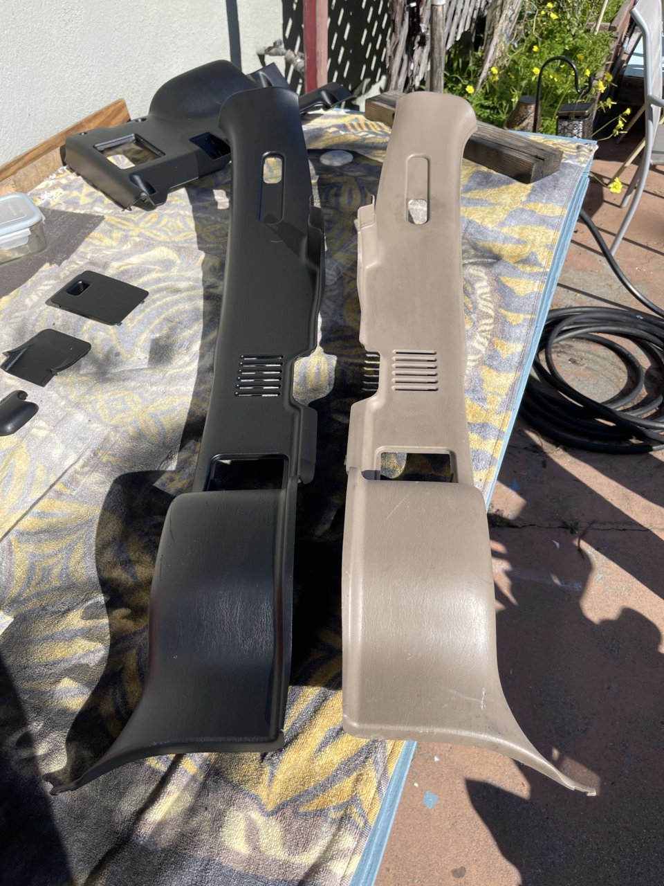

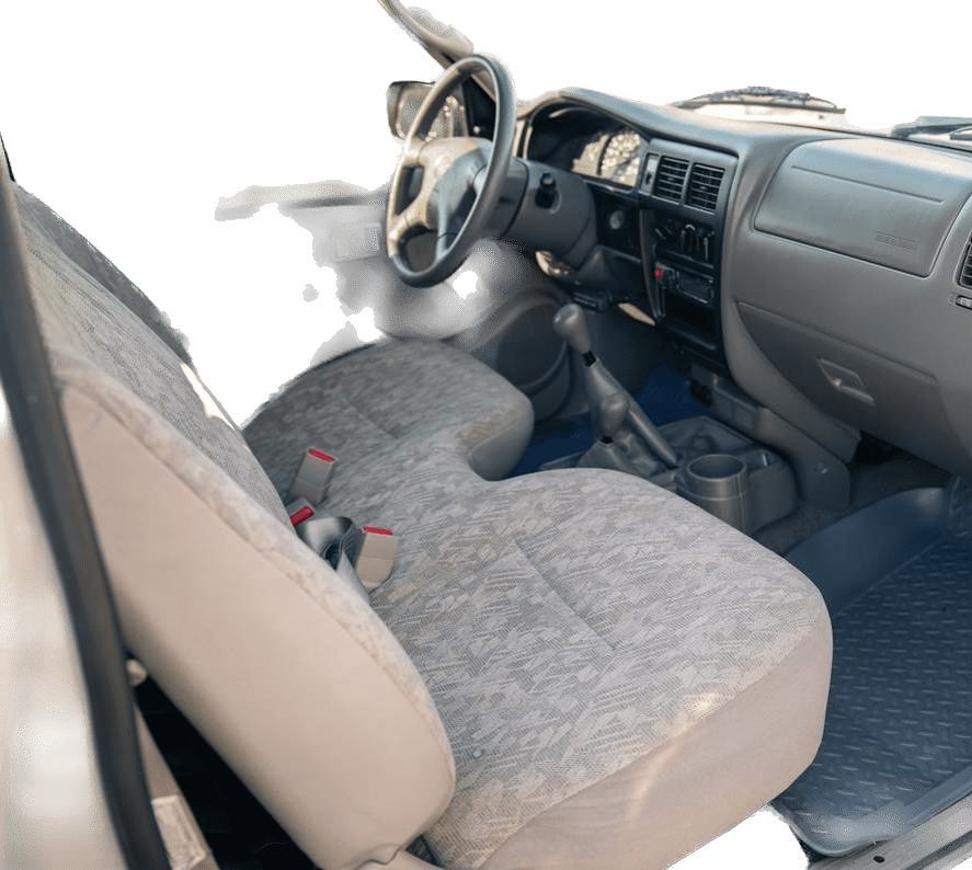

    I just did this exact transition on my 2001 Tacoma reg cab.
    I use the DUPLICOLOR adhesion prep spray paired with the DUPLICOLOR flat black vinyl/plastic dye. I did the ENTIRE interior and used about 4 cans of black @$15 a pop and 1.5 cans of the adhesion spray.
    I am in love with the results.
    here are some pics!
    *also did the bucket seat, map light and steering wheel swaps on this truck. I added a Lexus console (not plug & play) & new AC knobs.
    Before/after

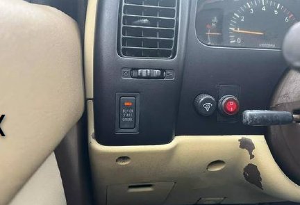

    A previous owner painted the interior hard plastic pieces, and it is peeling EVERYWHERE. Looks like crap!
    Friend suggested painting over the crappy paint. Wondering what to do.
