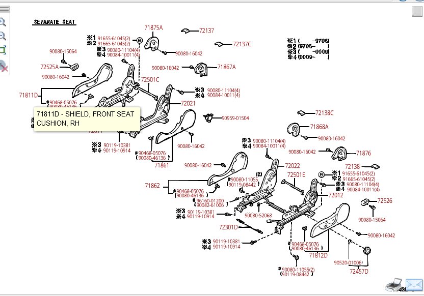

    OUCH! Not my experience. For parts like that dealer tacks on shipping charges that are outrageous. Note the following invoice. Screws: 87 cents each, Shipping: $18.56!!!
    Better: enter "Toyota [part number]" in a Google search and then select "images". If you find an image that seems close,select the source url of the image, likely it is someone selling the same or similar. Dealer diagrams for screws are often generic, blurry, and not helpful. Also, part number from your 1998 may have been "superceded" by a different part number for the identical part for a later year.
    BTW, isn't there a screw that attaches the trim to the lower portion of the PASSENGER seat? Likely it is the same screw!
    On the attached PDF I transferred parts numbers for my 2000 ExtraCab PreRunner with bucket seats to the parts diagram. May be helpful, but there are not fasteners listed either document.
    Good luck!

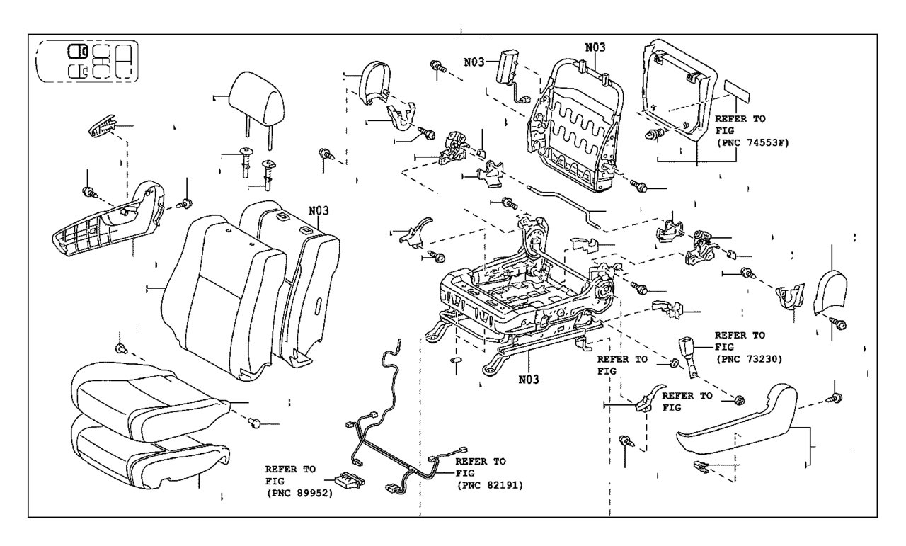

    Dealer diagrams are the only good diagrams. I use them every day. Toyota always has dotted lines that indicate where each fastener is installed, and it shows how each part is layered. If it doesn't have a part number its typically not available separately.
    The diagram shown above is from the CCC estimating program. I will attach an OEM diagram for comparison, if there are any better diagrams please share the source.
