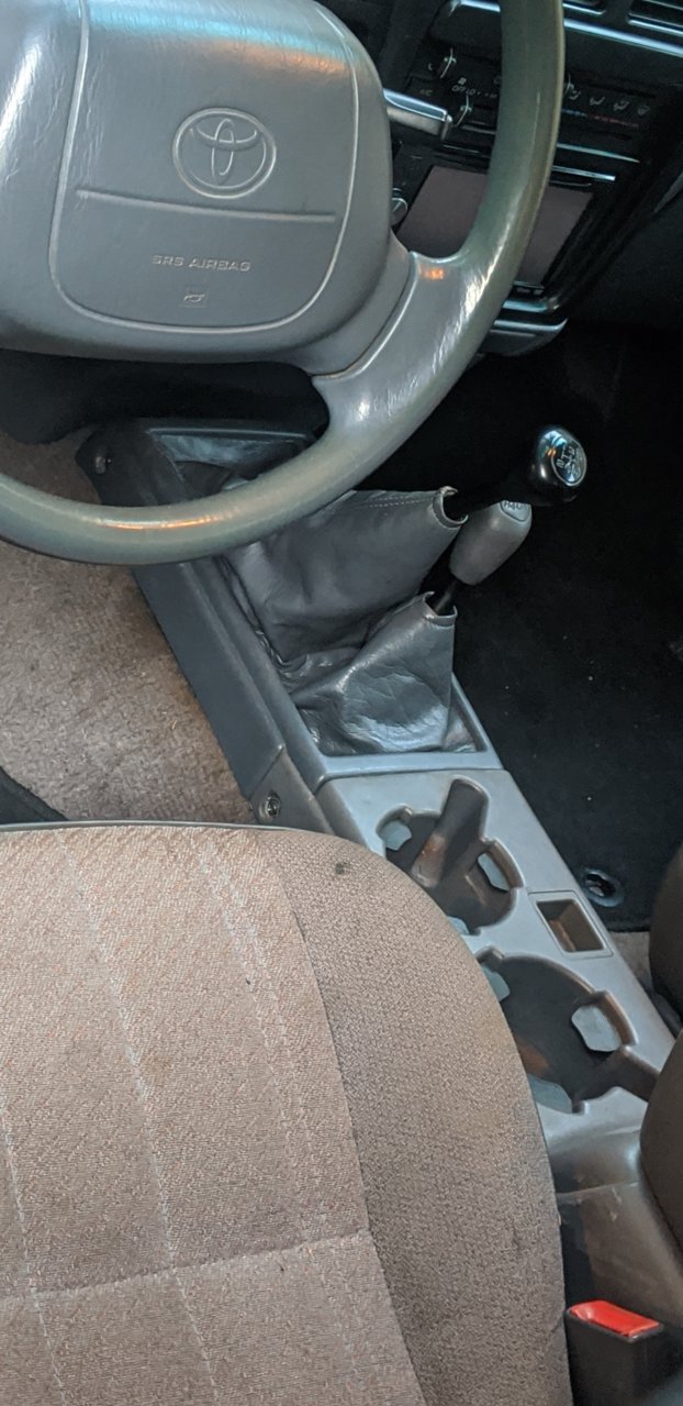

    Hey all.
    my 98 came with the light blue interior. Looking to update it to grey. Also interested in upgrading the seats to buckets from a 4Runner.
    Are 4Runner seats A direct bolt in? Which center consoles are out there that are a direct bolt in? Do the door cards from the front doors of a 4Runner bolt onto the Tacoma doors?
    Any other updates / upgrades of stock Tacoma or 4Runner interior parts.
    thanks for your time reading this.

    It looks like you added the extra cup holders and center console from one of the 01-04. I did the same thing and the colors are different. The interior of my 97' is tan and the center console/ cupholder is gray.60790170302__A35790FA-FCC5-482E-8C4A-25927DB1D85C.jpg

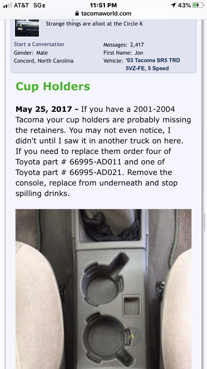

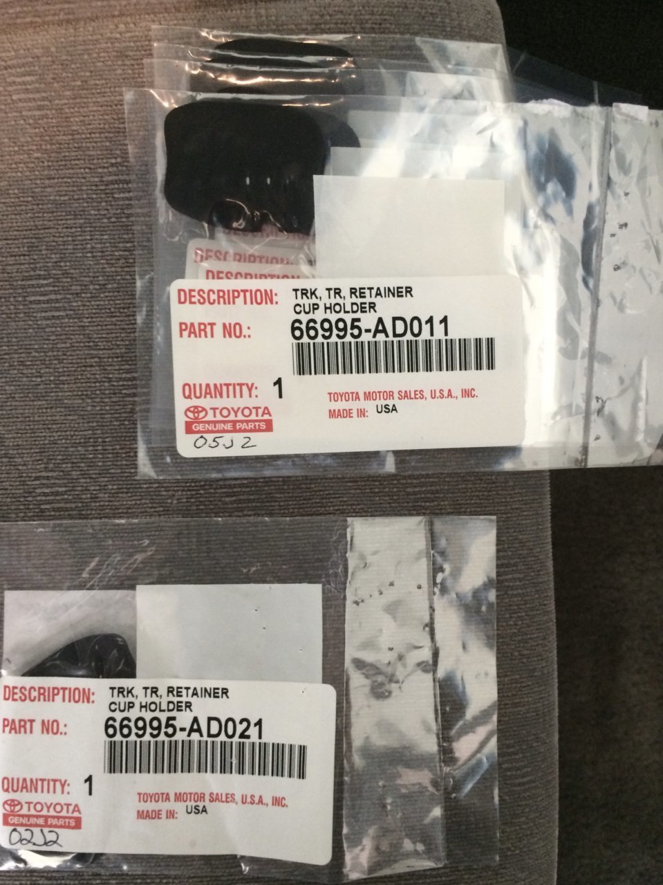

    Idk if it interests you but I see your cup holder retainer flaps are missing just like mine are when I did the conversion too recently. If you’re interested in replacing those like I am here are the part numbers.
    Found this from another TW member

    awesome, thanks man ! i had an 03 prior to my 97 and it was missing them too. im gonna order them rn

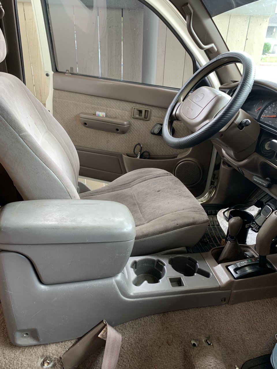

    Do you have a backup camera wired to that head unit?

  13. May 13, 2020 at 6:13 AM

    is that from your 97 5-lug?

    Yes it is. It's a little dirty rite now
