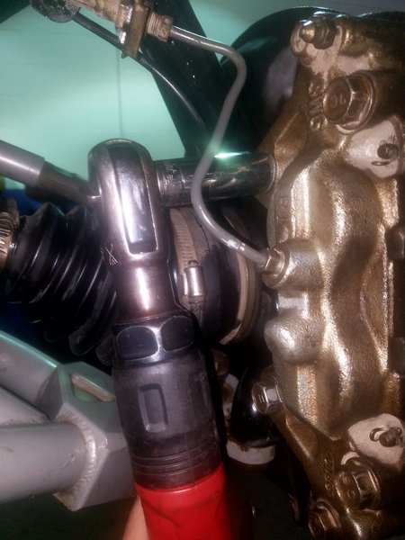

    Thank you well looks like I'm checking things out tonight. How did you guys torque the 4 bolts that retain the bearing flange to the spindle? They really suck bc you can only get a wrench on them. I hooked to wreches together and just got them as tight as I could...
