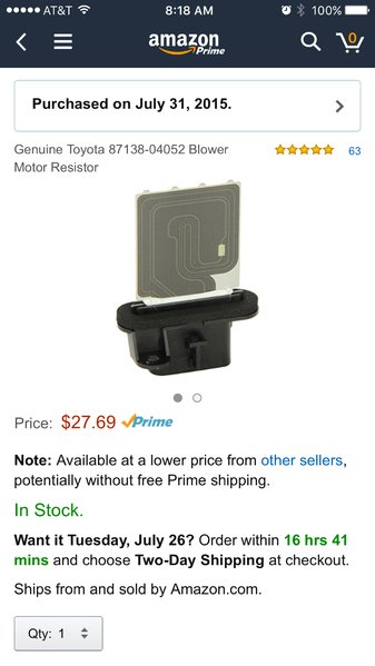

    Does it work on high? I had this problem before but the blower motor only worked on high.

    It's not working at all...

    Ok....fuses all checked out...it did this once before....but I killed the truck then restarted it and it has worked fine....and I am about 100 miles from home...might have to deal with this Texas heat till I get home...gonna use the 270 style AC:bananadead::)

    Did you check the fuses with a meter or only visual? Visual is not accurate at all.
    Check the IG1 No2 Fuse 10 amp, the 50 amp heater fuse. Use a meter to check the fuses.
    NOTE: The blower motor should have 12 VDC to it whenever the ignition is on.
    The blower motor is turned on by switching the ground wire through the resistor pack.

    First let me say thanks to everyone for the help...so here's what I did...just did a visual inspection of the fuses since I was away from home (didn't have a meter or tools)all the fuses checked out...Called around Dallas and found a Resistor at autozone...went and picked up and put it in. Cranked the truck and turned on the AC...Still didn't work...ok so we take off to head home and about 10 miles down the road the blower starts working fine...all speeds!????

    You must have a burned connector for the blower. They are notorious for this. I would pull the connector and look for overheating contact, caused by a loose connection.
