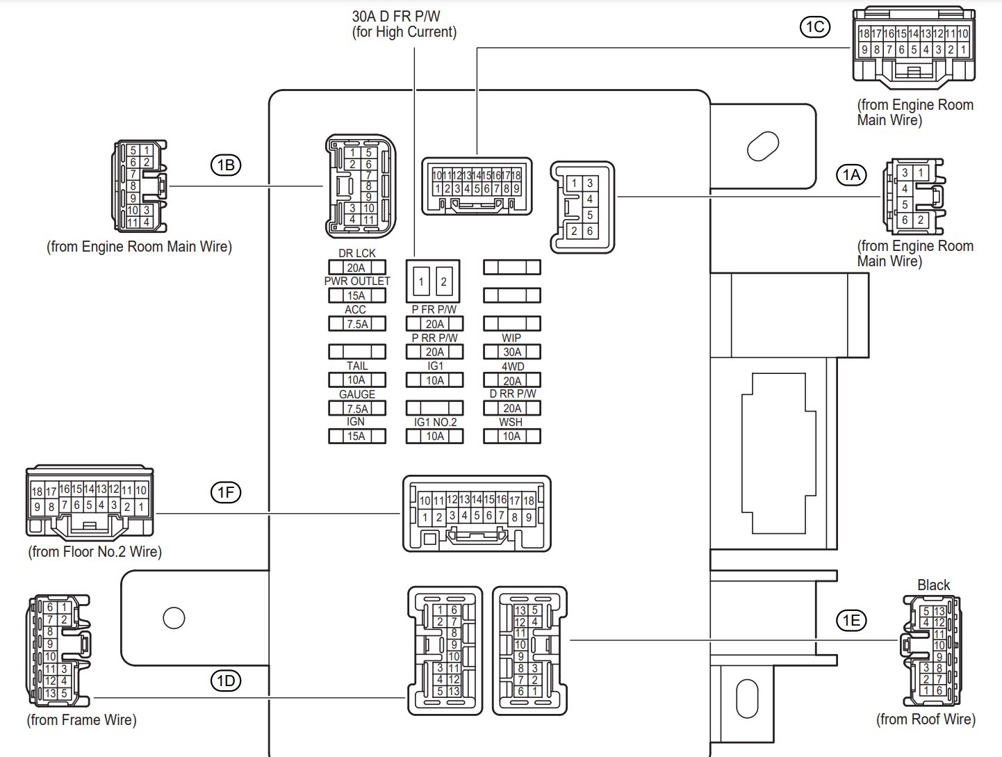

    The Dome light and the Clock both share the same power from the 7.5A Dome fuse.
    They do not share a common ground.
    Both the Dome and Clock are fed power from the 1C connector.
    I'd inspect that the fuse itself is tightly in place.
    Then take a look at connector 1C
    The power comes in from pin 4 on 1C. A white wire.

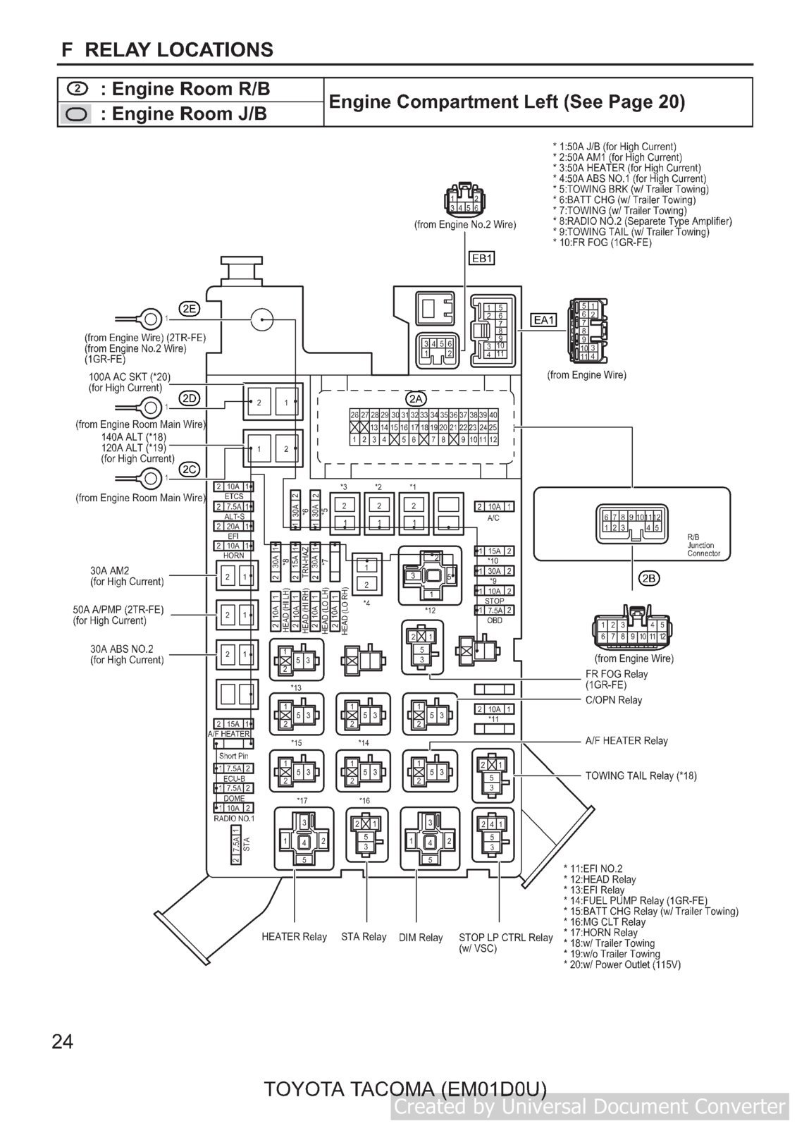

    Check the Short Pin in the Engine Room Fuse Box, it powers the radio and dome among other things and has been known to develop a bad connection.

    Short pin powers the Body ECU, Dome Light and the Radio. It is just a shorting bar connector that is removed during storage and shipping to prevent battery drain. Installed during final inspection and prep at the dealer.

    Thanks guys! After re-inserting the short pin, the dome light/radio started to work again... I'll see if that's a permanent fix or not though.

    Worst case you can just solder a wire across the connections for the short pin as it serves no other purpose... Highly unlikely you would ever need to remove it...
