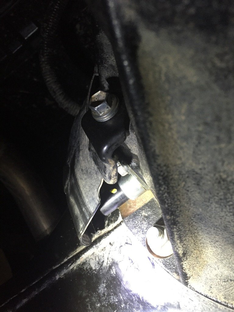

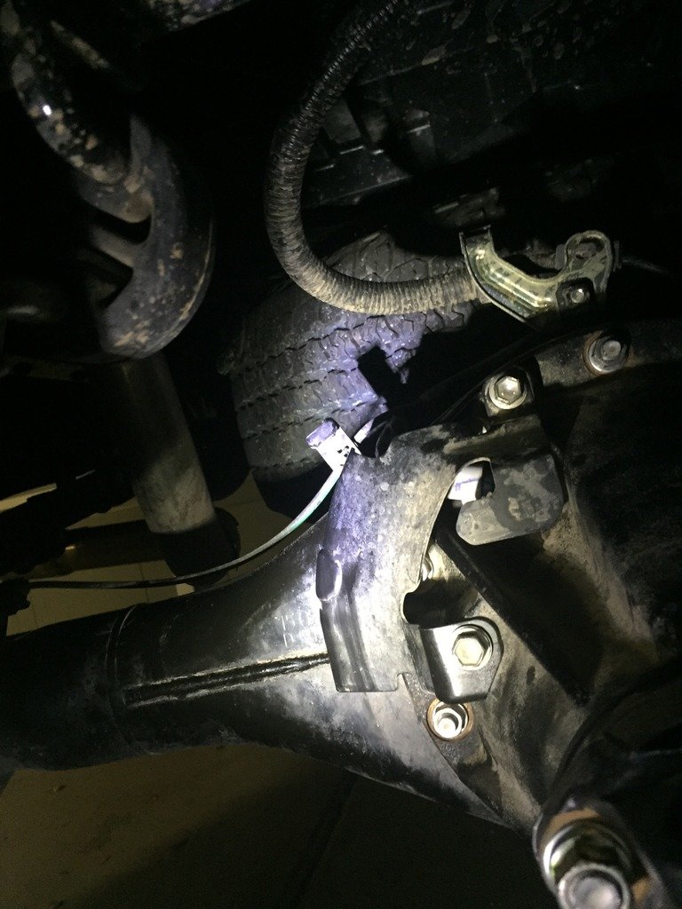

    Update: Dealer tech had the who 3rd member out. Tested the switch/actuator on the bench and it tests fine. Resistance readings are good and it engages/disengages. Put it back in the truck and the resistance reading go up and it engages intermittently.
    Keep in mind this was told to me by the service manager so it's 2nd hand info from the tech to him to me. They are waiting to hear back from Toyota on what do do next. I guess they talked to Toyota many times today. Either swap in just a new switch or replace the whole 3rd member which I said I'd prefer. They need approval from Toyota and there aren't many parts available. Service manager said he could pull a whole new 3rd member off another truck to put in mine, but need approval. They did say my ring gears look perfect.
    As of now the e-locker is disabled (I assume something is unplugged in the diff) until they hear back from Toyota. Which they expect to hear by tomorrow. They just wanted to get me my truck back today. Could have kept it if it's only going to be a day but I bet it will be longer. The service manager doesn't want me to go months with no 4LO due to no parts from Toyota, which I can appreciate :)
    Here are a couple of crappy photo's of the rear diff. Passenger side on the front of the diff is a shield. It appears to be covering a plug and below it a sensor. I didn't stay under there long enough to look in more detail.
