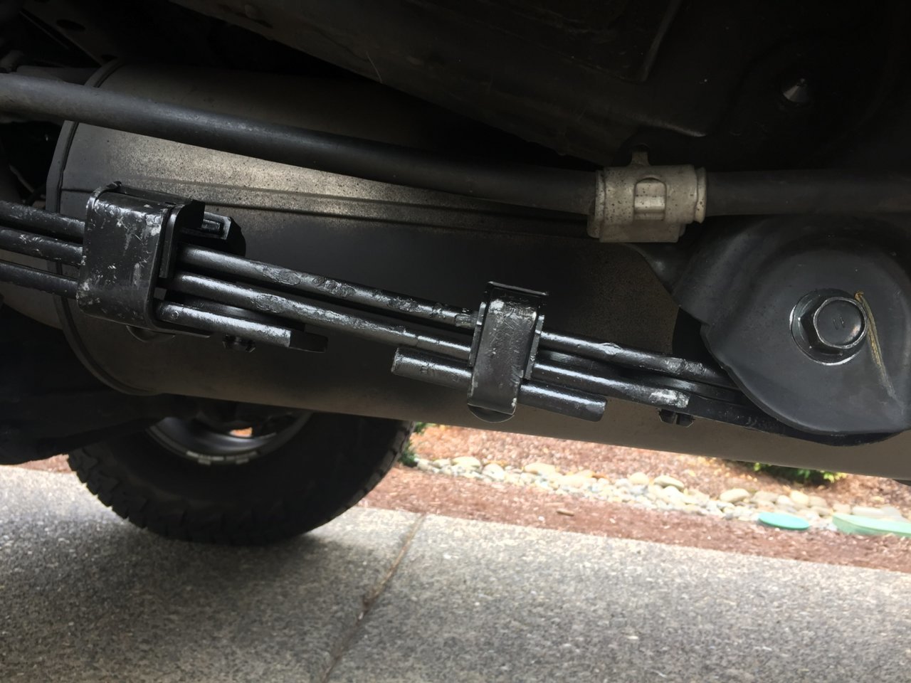

    I visited my local Toyota dealership and told them that my truck was howling/whining at 50 to 60 mph and that the rear differential was also leaking.
    On my first appointment with 6,200 on the odometer, they confirmed the problems, replaced the rear leaf springs, installed the dampers and replaced the rear differential gasket.
    The howling is gone for now.
    The new leaf springs have an additional short section of spring at the bottom/front of the spring.
