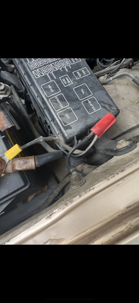

    inspect all 3 grounds
    that is what my 'intermitent' problem was

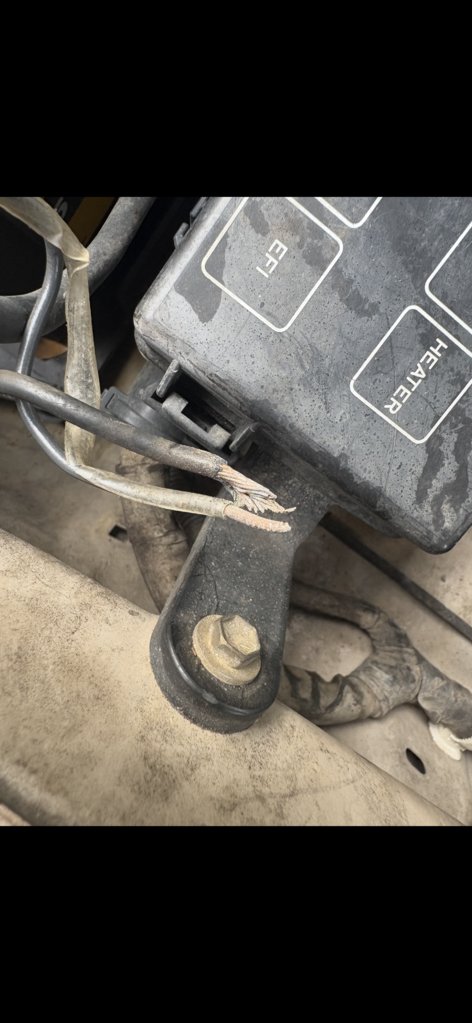

    Bc I just went through this on my 2rz…..
    both v6 and v4 share locations of firewall and inner fender(next to battery)
    v6 has 3rd ‘near throttle body’
    V4 has 3rd on front of intake plenum
    mine was a corroded wire/shody work done by previous owner on the inner fender ground wire
