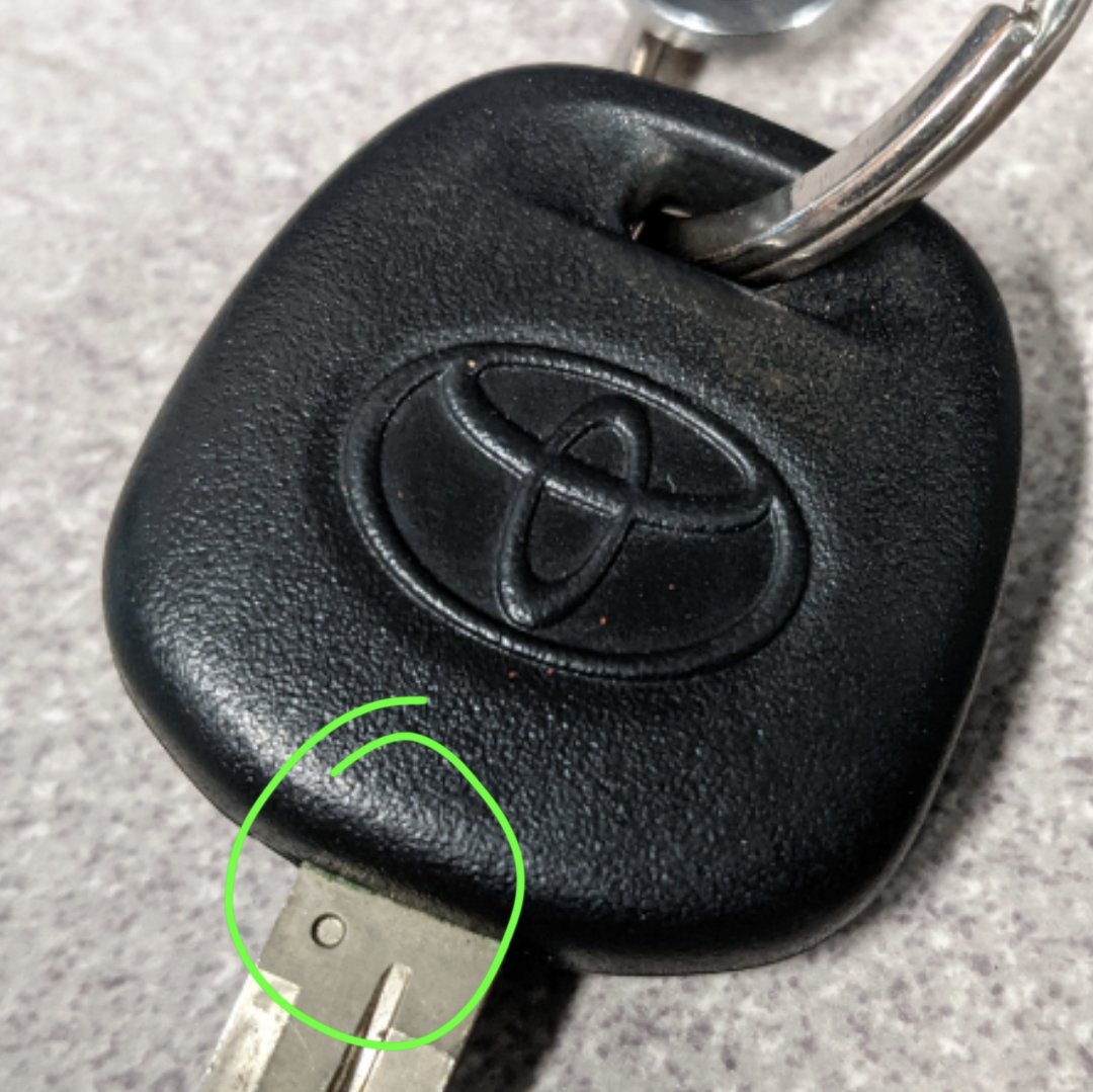

    If it was made after 2006 it should, find a key that you know starts the vehicle look near the head of it, is there a tiny dimple in the key body on one or both sides? Does the key have a thicker rubberized black head on it?
    As for the fuel pump kit I believe it's the same between the six and four cylinders but I'm sure it can be easily verified through URD's website.

    It's not always a letter, if it has a head like this and that circled in green divot it's a transponder key.
    Even if it's not it wouldn't hurt as a diagnostic step to just try a bare key with nothing else (like remotes other keys or fobs or even key chain decorations) within 3' of the ignition.

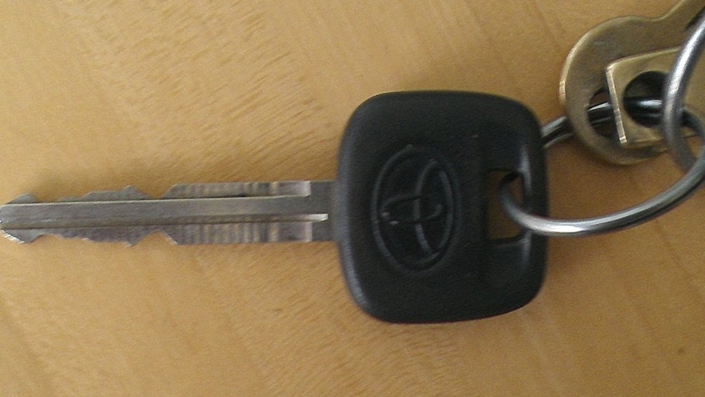

    My keys looks exactly like this:be7l3k_8ac11739317812b9319d701935c34efad4f9d525.jpg
    Another thing I've noticed between chip and non-chip keys are that the black part on the chip keys is a little bit more rounded than the non-chip counterpart. I've experimented with this in the past and did my research and this is ultimately what I concluded. No dimple at the top and the shape of the black part is different.
    Funny enough, after I parted out my 98 I still had one of the rubber top keys that looked very similar to this one on my keyring and accidentally used it to start my 2013 a few times...it didn't work as smooth and took some jiggling of the key in the ignition but it would start the engine. Eventually I realized my ignition switch wasn't broken and I was using the wrong key to start my truck when I had to jiggle it.

    So long as there is no divot on either side and like you said the similar but non-transponder keys are slimmer in profile on the head then I guess you could count that out.
