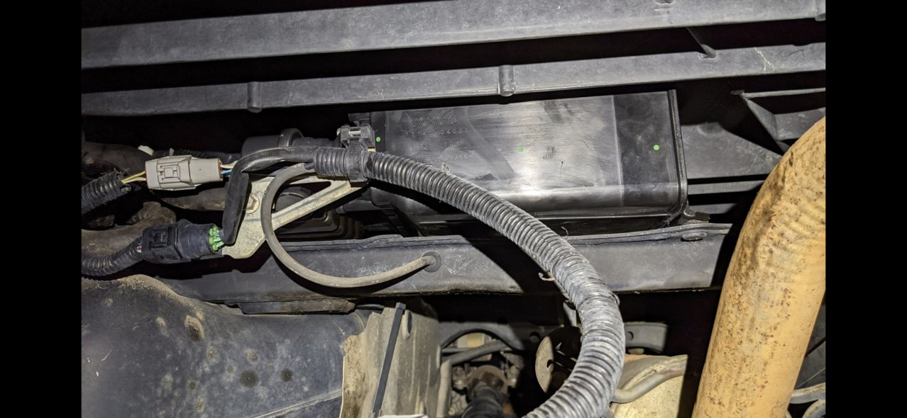

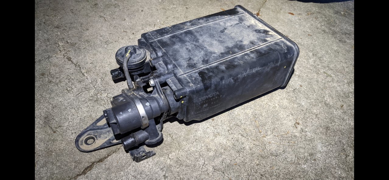

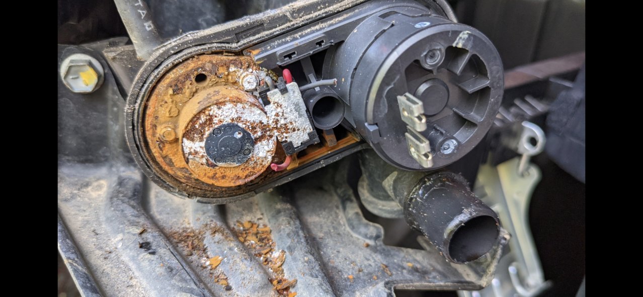

    The purge valve is bolted to the charcoal canister with three 10 mm bolts and the charcoal canister is bolted to the frame crossmember in front of the spare tire on top underneath the bed.
    It cannot be removed without removing (or at least loosening and lifting) the bed or cutting the reinforcement ribs of the bed unless you have a half inch body lift or greater.
    This bastard up here:
    Looks like this removed:
    And what's going on when they fail:
    Approximately $300 part from the dealer, dealer charges like $1000 to change it,
    Cost me the part and 30 minutes.
