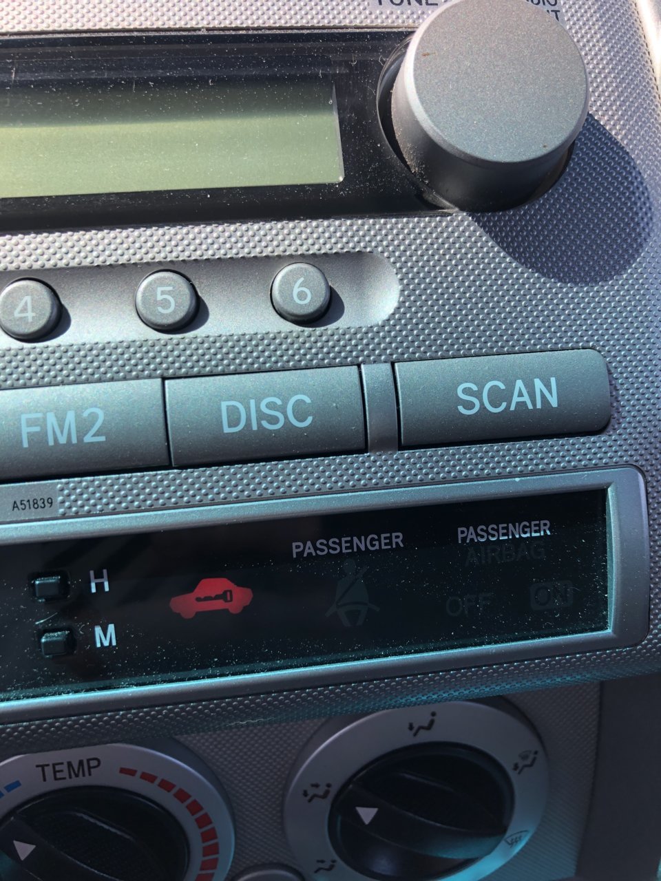

    Let’s start with easy stuff first.
    Does your anti-theft light continue to blink with the key in the ignition. You may need to turn the key to accessory to get to to stop. (You shouldn’t but you
    might)
    The light needs to stop flashing with the key in the ignition.
