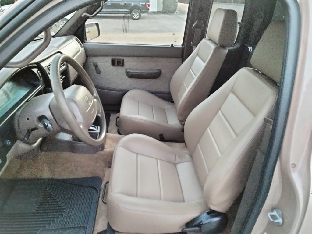

    New seats..at least I'll be comfy in the parking lot if the truck won't start.IMG20250122175559.jpg
