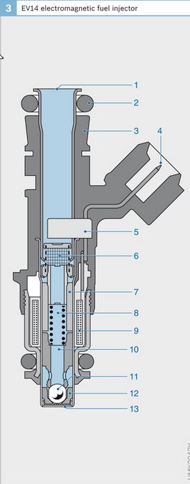

    Not wanting to be Mr. Negative, but:
    You cannot "rebuild" a modern gasoline fuel injector. It is welded together during assembly. At the very best you can clean the outside nozzle orifice plate, replace the external O-rings and any snap on tips if applicable. And with the proper equipment you could pull the pressed in filter if it has one and then back-flush (reverse flow) the injector then insert a new filter. Many still have an internal basket filter that cannot be removed as it is around the needle valve. After assembly and setting the body is over-molded in plastic.
    Even the Old EV1 injectors flow couldn't be altered after it was set as the adjustment sleeve was staked in place.
    I don't see how they can flow balance anything as the adjustment sleeve is inside the injector and set during assembly.
    Image below you can see the basket filter on the EV14 Injector needle.

    I'm glad you are happy with their service they provide. I can even see where injectors with the inlet basket filter could benefit a little. Most of the Bosch injectors have a filter inside around the needle valve that cannot be removed. Not much good other than cleaning the outside and installing new o-rings.
    Been working in the injector business for over 25 years... Diesel Unit Injectors, EV1, EV6, EV14, HDEV5, HDEV6
