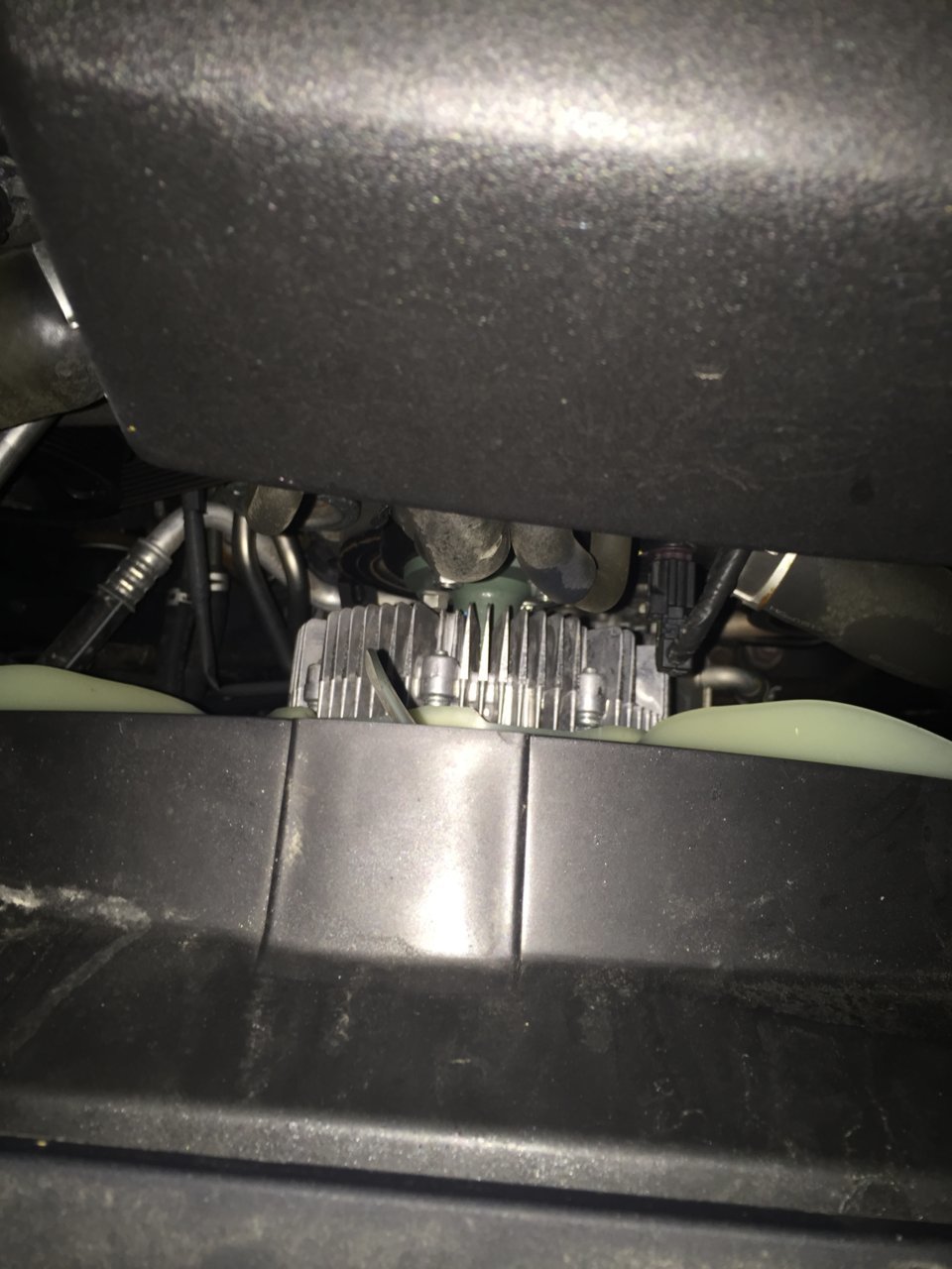

    I have done this mod
    It helps a lot.

    Because it is a viscous fan clutch that engages and dis engages at certain temps. It is always “spinning” though.
