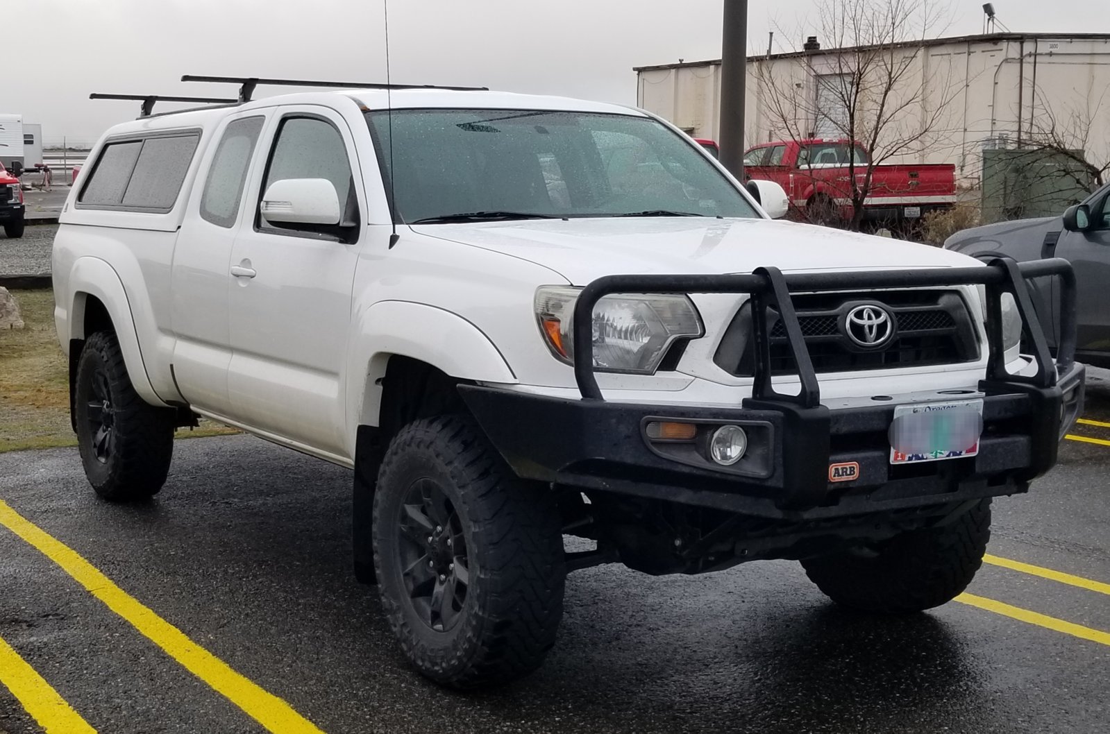

    Hello fellow Tacos. I've got a '15 AC SR 4x4 6 spd and a while back I put on Bilstein 5100's (all around) with stock springs and the Deaver "overload replacement" leaf set. The truck drove fine, albeit a little stiffer than I'd have cared for. A month later I put Firestone airbags on it and now I have an intermittent and inconsistent shake/vibration. It literally comes and goes with no notable explanation. It feels like an out-of-balance wheel when it's happening, but how could that be, given the inconsistent nature of it? Any insight would be greatly appreciated. 20231213_122225.jpg

    Road surface doesn't seem to make any difference. The one thing I failed to mention (which is why I say it feels like an out-of-balance wheel) is that the vibration/shake is speed dependent. The faster I'm traveling, the higher the frequency of the shake. I haven't messed with airbag pressure. After installing the bags, the rear sat higher overall (than before airbag install), and the passenger side sat higher than the driver. I added a little pressure to the driver's side just to sit level but the passenger is at the recommended minimum.
