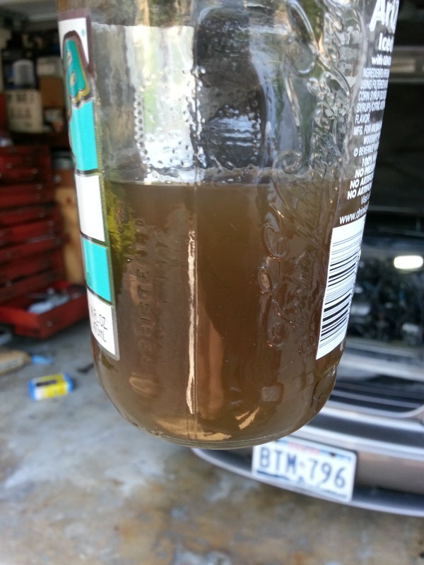

    Helped my neighbor with his Camry last weekend. Was having a misfire code, and car wouldn't even stay started.
    Thought he had bad gas that was full of water. Ended up being his fuel filter was full of crud after 150K miles.
    This is what the fuel looked like.
    ^^^ That is terribly nasty.
    Changed out the filter, and the car would start and run. Also ended up having a bad coil as well. So we put a new one in as well.
    But let it be known, that the car wouldn't even run until after the filter was changed.
    Figured that you would like to see that.
