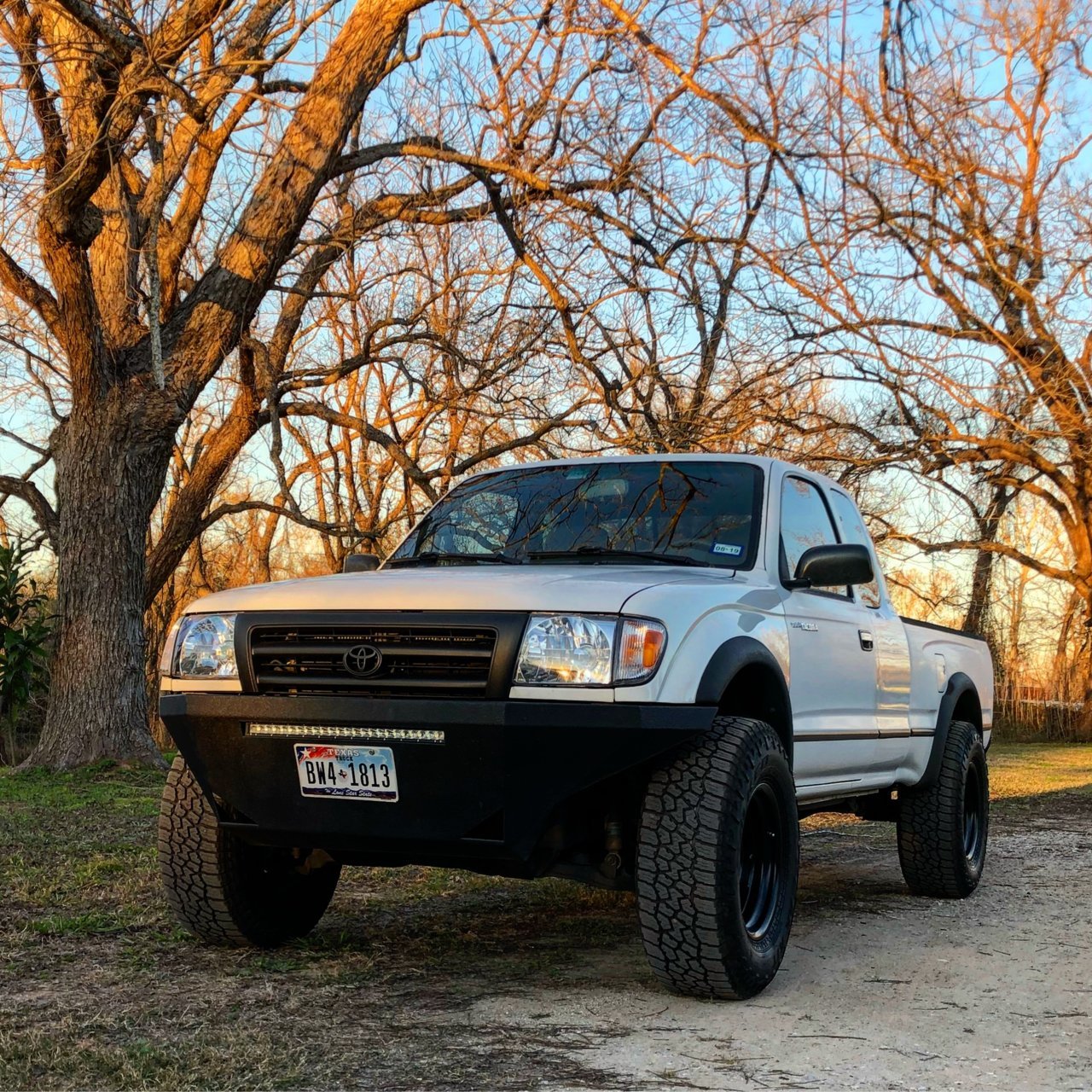

    Hello all,
    I've been having a problem with my truck intermittently stalling at idle/in traffic off and on for about a year, and it has gotten to the point of 3-5 times a day now. I've dug through every thread I could find on this topic, and am getting tired of throwing parts at the truck.
    First things first, '99 Prerunner with the 3.4 5VZ, zero motor modifications @197k. In Drive, with foot on the brake, idle will stumble, drop to 300-400 rpm, then die. If left in park, idle will become low and rough, then sputter and die. If the idle starts to fluctuate in park and I put it into Drive, it will immediately die.
    I've tried the following:
    -New MAF Sensor
    -New Throttle position sensor
    -New Plugs & Wires
    -Thoroughly cleaned Throttle body & IAC Valve
    -Ohmed IAC Valve, is within spec
    -Sprayed carb cleaner on all vacuum lines, no signs of leaks
    -Replaced valve cover gaskets (leaking), replaced all intake manifold gaskets and air filter while I was in there
    -New Fuel filter
    -Seafoam through vacuum lines
    -Injector cleaner through 5 tanks of gas
    -Compression test, all cylinders within 10psi of each other
    It's not throwing any codes, and it does not make a difference if the A/C is running or not. I'm starting to suspect the fuel pump due to a slight hesitation in the throttle when accelerating from a stop, but it seems like the fuel pump would be an all or nothing deal, not a long intermittent issue.
    Does anyone have any suggestions or ideas? Any and all are welcome at this point!
    The problem child:
