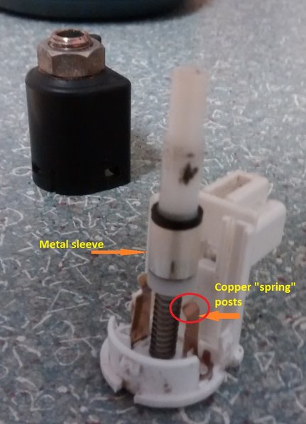

    Last winter, I had intermittent starting issues for a few weeks before finally couldn't get the truck started at all. Would turn key and get all accessories on but no response from starter motor when I turned the key.
    Figured it was something electrical because there was no other indication that the starter was failing. After checking a few other things, like starter relay and making sure the clutch start switch was being engaged properly, I took out the switch, and sure enough when I bridged the gap in the electrical harness with some spare wire, the truck started fine.
    The switch was difficult to pop open, but when I got it, I saw that when the button fully depressed the contacts (red circle) on the "spring posts" would pass over the metal sleeve, and hence the circuit was not complete when I turned the key. I fixed this by placing a small nut under the spring to ensure the metal sleeve could not go past the contacts, cleaned up the metal sleeve, and reassembled. I think a replacement switch was fairly cheap at rockauto.com if the switch had not been repairable.
    Figured I'd post this up, because when I was searching intermittent start problems on the web, I didn't find the clutch start switch as a potential cause, and spent a lot of time looking into more complicated causes. The truck is a 2001 tacoma with 240k at the time.

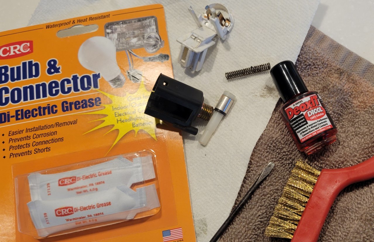

    I used some DeoxIT electrical cleaner on the copper "spring" connections and the metal ring attached to the plastic button. Used a brass wire brush with that stuff to clean it up good and then put a small amount of Di-Electric grease on there for minor lubricant.
    Took me 15 minutes! Works Great!!
