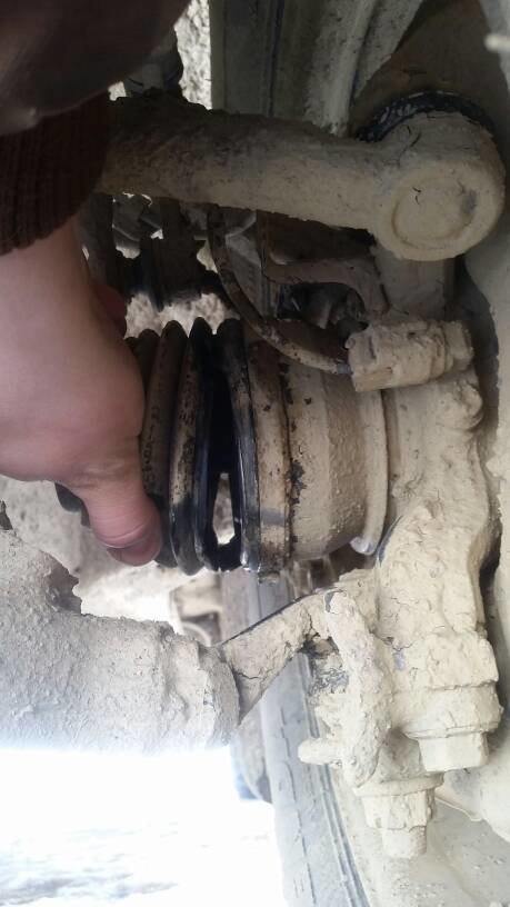

    well, the other day I found a torn cv boot and all the grease flung out, toyota is replacing the whole shaft under warranty. I don't know if that has anything to do with the shake or not?

    well it was in fact the cv axle causing all this headache. here's a pic, just rolled over 15k miles. the dealer covered it even though I'm dirty and lifted ;) 2975d82b2c60d8002d01aca34195c49a_fbf67d5b83cb41cf54d92880033040d88d25c22d.jpg
