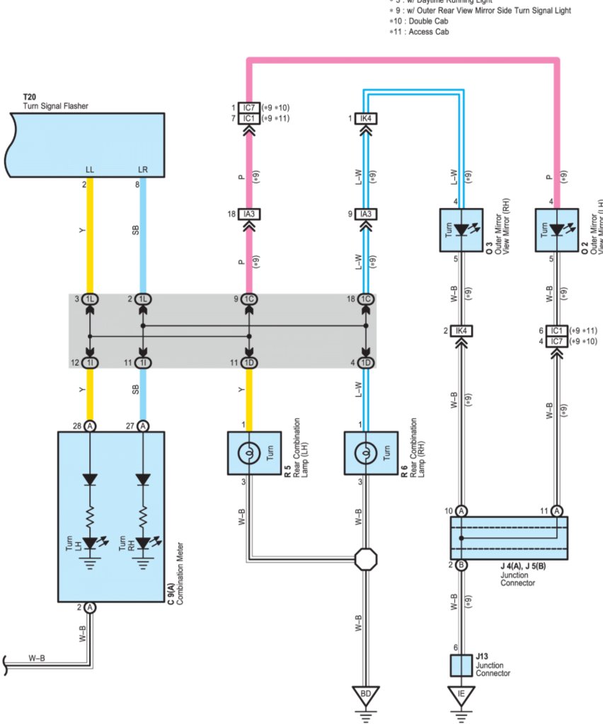

    Ok. Let me drop this here.
    Just for reference.
    Ideally, I like to check for power and ground at the bulb plug.
    But that can be easier said, than done.
    Since the other flashers on the driver side work, we can rule out the flasher relay.
    Let me find the nearest connector(s) that is easiest to get to, we can check there.
    The Left hand mirror goes through 1x junction connector (1C) and 2x regular connectors (IA3 and IC7)
    The Ground IC7 and J4.
    Let me figure out were those connectors are and get back with you.

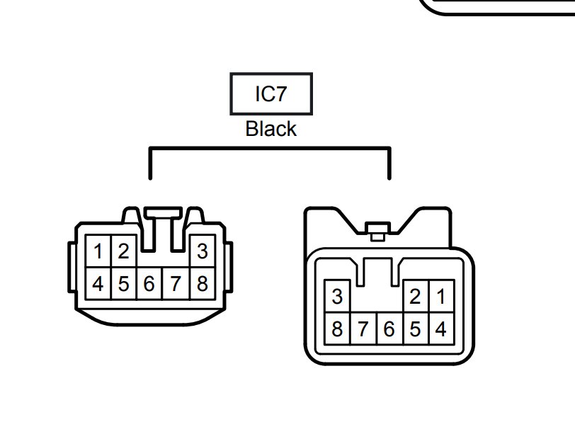

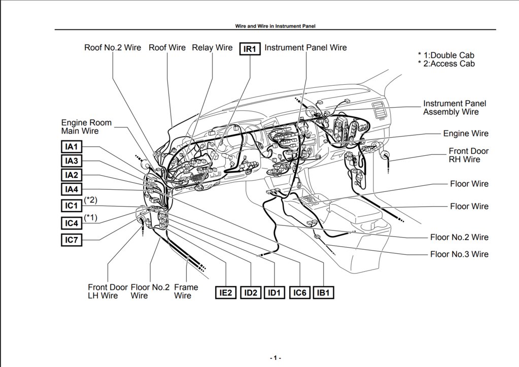

    Ok it took me a minute.
    But I finally found a copy of the connector locations.
    That said, most of the time, it's the wire harness between the door and the cab.
    Every time you open and close the door, those wires bend. Eventually, they can just break over time.
    And depending on the time, they can move just enough at the break to make contact again....Then next the door opens/closes the break contact.
    Unless you wan to go straight to the bulb connector, IC7 is the easiest place to check.
    It's behind the driver side kick panel.
    You are looking for Pin 1 (Pink) - Power
    And Pin 4 (White/Black) - Ground.
    I'd use a test light, as it can act as a blinker, and you wont have to try and watch the meter bounce between 0/12v. (power side)
