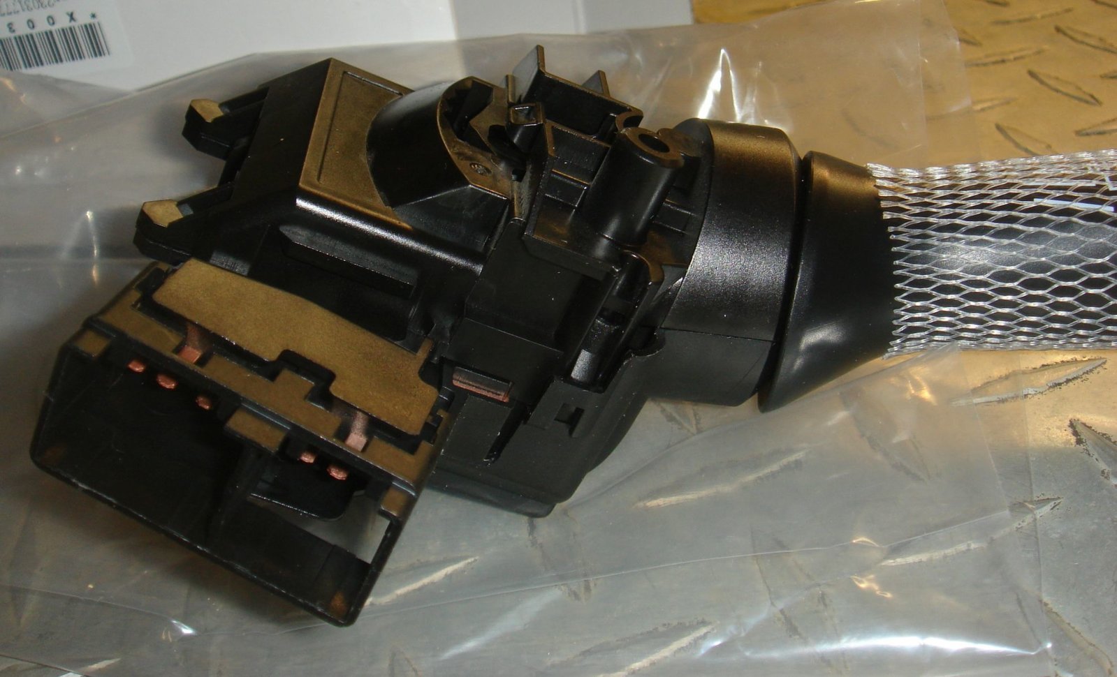

    WIPER INSTALL DSC00717 (13).jpg https://www.instructables.com/Adding-Intermittent-Wipers-to-a-2007-Tacoma-Base/
    I finally found a cheap part and 16 years later, installed Intermittent wiper control on my 2007 Tacoma BASE model. It took three times as long to write it up as it did to r&r the darn switch.
    Why it took me so long to realize the manufacturer needs to wire every vehicle for all possible accessories for that model in order to sell a ten dollar switch for hundreds as adding cruise or Intermittent wipers and such!
    How to replace WIPER SWITCH on Toyota Tacoma, INTERMITTENT wiper MOD, Part # 84652-02710 Lincoln Max n Co (GOOD YOU TUBE)
    ACROPIX Turn Signal Headlight Switch Front Windshield Wiper Switch Fit for Toyota Camry 2.4L 2007-2010 8465204141 - Pack of 1 Black 28.01 w/ 5% coupon
    https://www.amazon.com/dp/B0BZYRXQMD?ref=ppx_yo2ov_dt_b_product_details

    Best mod I ever did! That, and remote start. The stock wipers are too fast for light rain and smear everywhere if it’s only sprinkling out, so I’d always be turning them on and off and on and off. Intermittent switch was SO easy!
