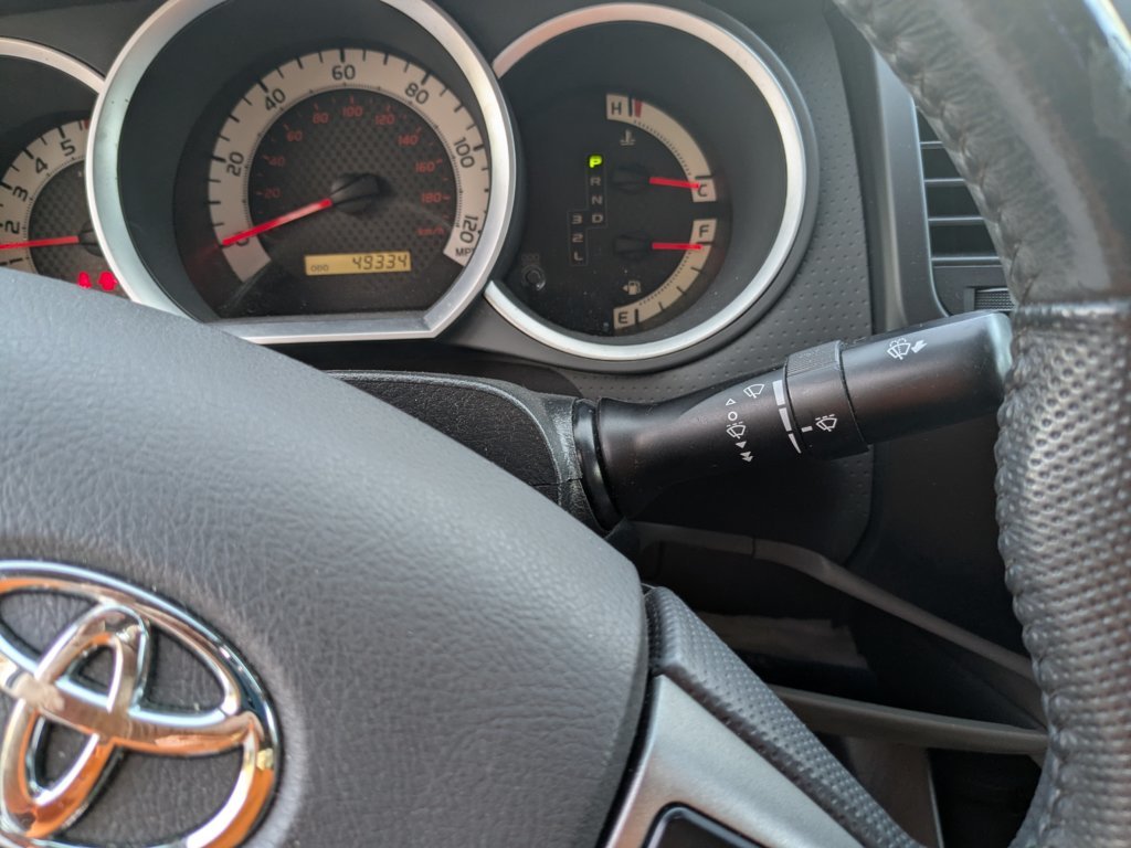

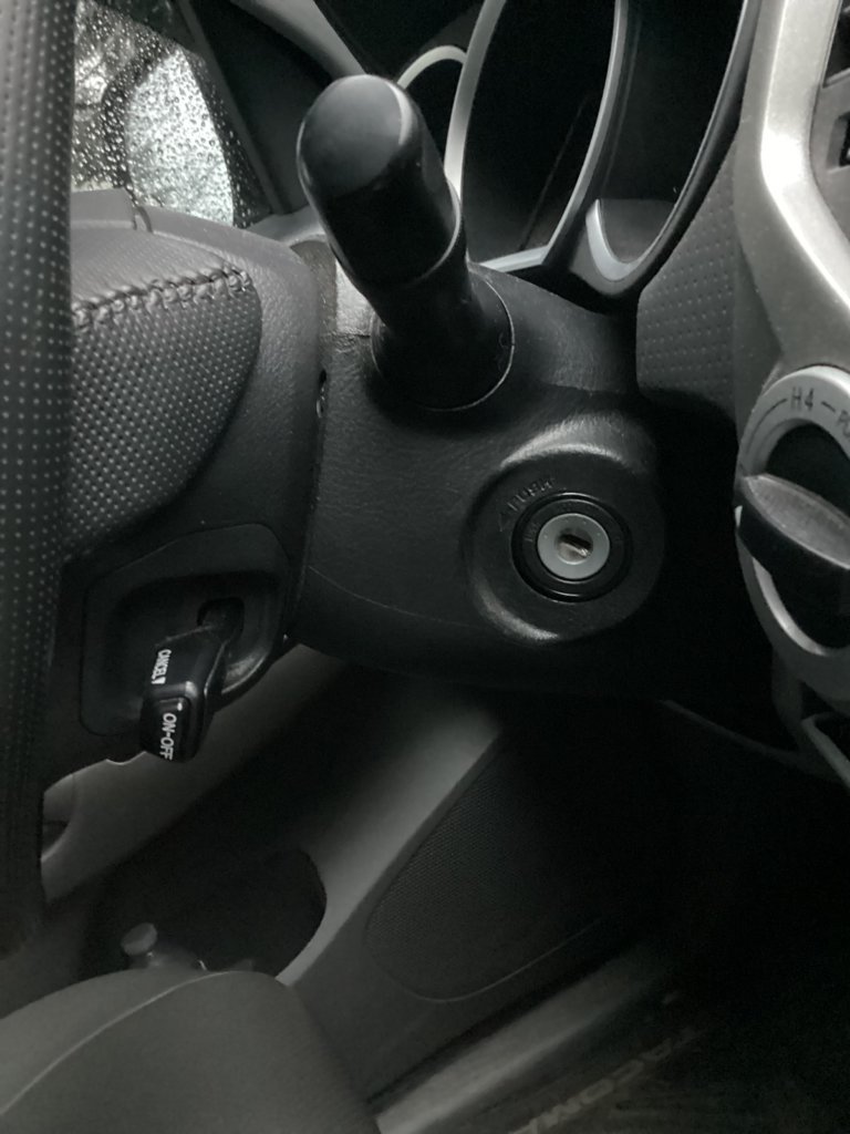

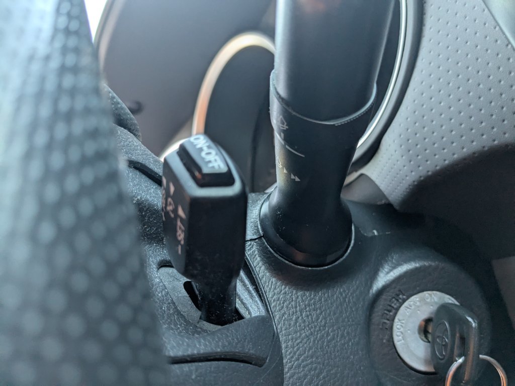

    PXL_20250212_210036138.jpg PXL_20250212_210021910.jpg PXL_20250212_210001815.jpg
    The cruise stalk moves with the wheel. Wipers do not.
    Mine came with cruise as part of the convenience package, but I added the intermittent wipers, which was quite easy.
    Mine is a 13. And yes that's the odo as of today.
  9. Feb 12, 2025 at 1:21 PM
    D2.
    D2. Well-Known Member
    Dec 1, 2016
    #203759
    1,578
    Dan
    Nova Scotia, Canada
    2009 Tacoma - access cab 4x4 2TR-FE
    Cruise Control install. Intermittent wipers Hood lights Bed Lights Sliders 3" lift 886's on Billy 5100's Icon AAL 285/75 R16 Falken Wildpeak AT3W's
    Awesome pics.
    My truck came with nothing, and I added Cruise and Wipers by adding the stalks. I was lucky in that my clock spring already had all the connections.
    If your a manual trans, there may be another switch you need to buy from Toyota. Its for the clutch pedal. It a switch that lets the ECU know if you've depressed the pedal ( this is different from the one that lets the ECU know you have the pedal to the floor in order to start it )
