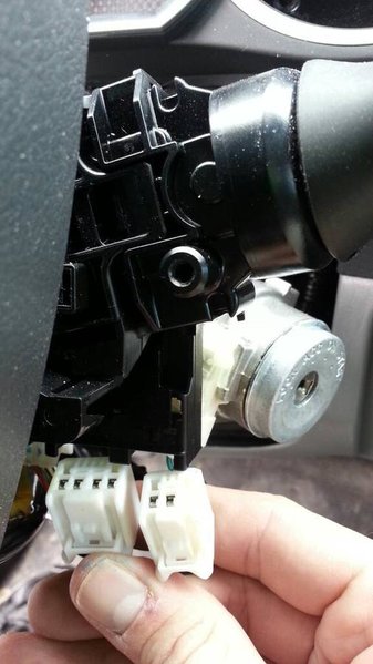

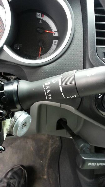

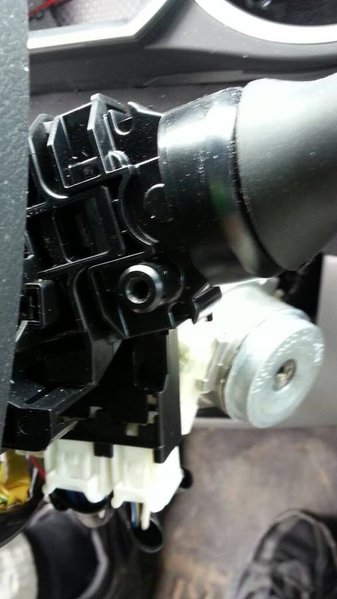

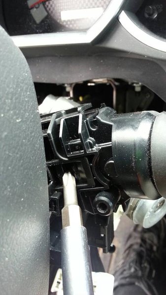

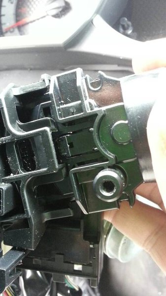

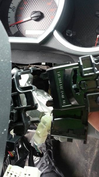

    I so wish I had done this mod the first week I got my Tacoma! I can't believe I waited this long, super easy and works like a champ! I want to give a shout out to Jorge at Camelback Toyota for a great deal on the part including shipping.
    I found it best to start the truck, turn the wheel one way and remove a screw, turn it the other way abd remove the other screw.
    Then turn the wheel upside down, you can grip a lower section of the lower cover wait and pull straight down, mine separated very easily and its only 35 degrees out!
    Also it's easier to have your truck key off your key chain our have a spare to use as I was turning the wheel often and wanted the truck off before pulling both writing plus,
    Here are a few pics also showing the two plugs, and then the one large clip that holds the whole assembly in,
    New switch in place!

    I was so ready to do that, and may go back in and perform that,
    I saw the 2-wire plug at the ignition switch assembly but was excited about getting the wiper switch in and taking pictures I totally forgot!
    You can see the plug in the fifth pic, with the white/purple??? and green/blue??? wires in it,
