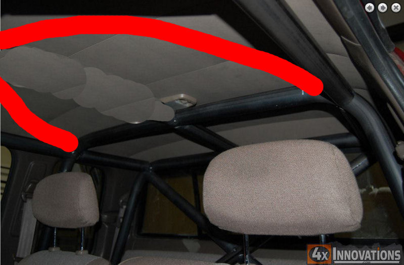

    Any chance I could get a quote for an internal cage for a 2002 extra cab, but designed to all me to still use my sun roof? Or should I order the kit and fab it out myself?

    Sorry I don't have a Tacoma with a sunroof to be able to see how a cage kit will fit with a sun roof.
    No we do not offer bolt in cage kits any longer. All kits are weld in only.
