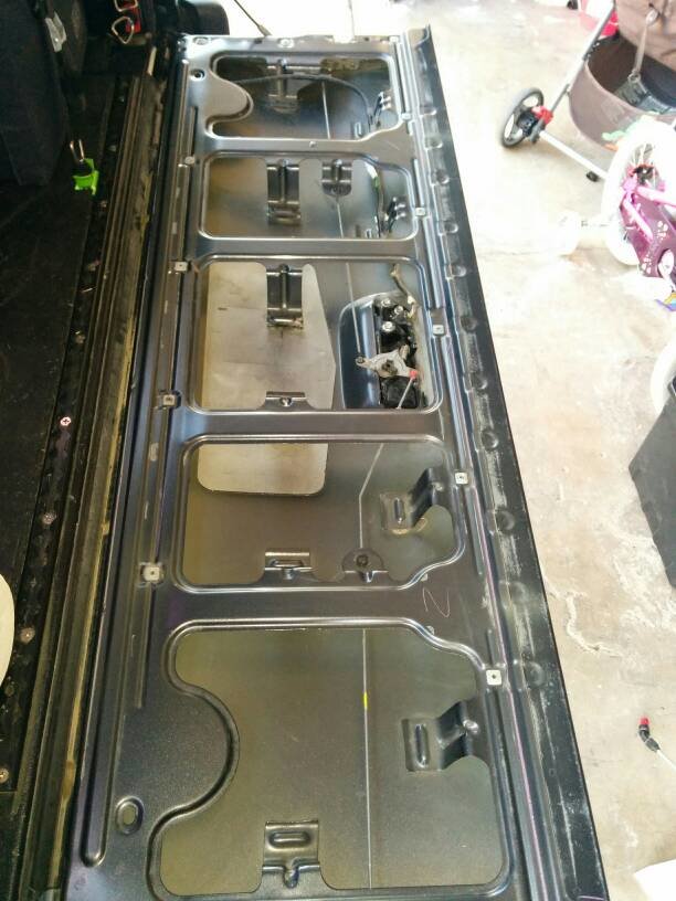

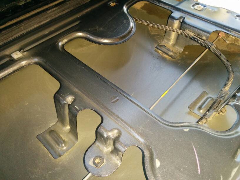

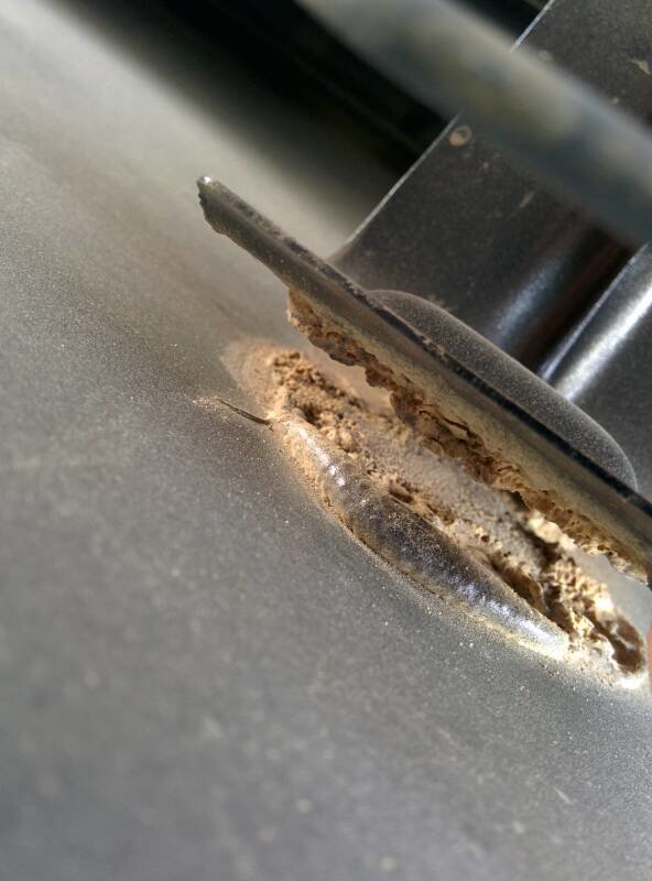

    I took apart my tailgate and discovered (10) right angled sheet metal standoffs that provide structural integrity to the tailgate.
    Four (4) of mine have separated, vibrated apart.
    There is some kind of glue in the joint.
    I want to fix them.
    Anybody glued then back together?
    Anybody know what kind of glue is used in the body panels?
    I married my tacoma likes this.

    The standoffs are providing some support, without them, it would just cave. When I took mine apart, the sheet metal was bent. The factory adhesive is the same as under the hood and in the door panels that secure the exterior skin to the reinforements. It's a flexible type material. It's probably not a very good glue, but for automotive it seems to work.
    JB Weld might be a good option.
    This is a pic inside after cleaning dust and dirt out for 45 minutes. lol

    It's body mastic. It's applied to the bare metal between the two parts. I wouldn't use JB weld because the body mastic is pliable even after it gets baked at 400 degrees. It's to prevent the panels from rubbing together and stiffens the panel. Unless it is making noise, I would just leave it alone.
