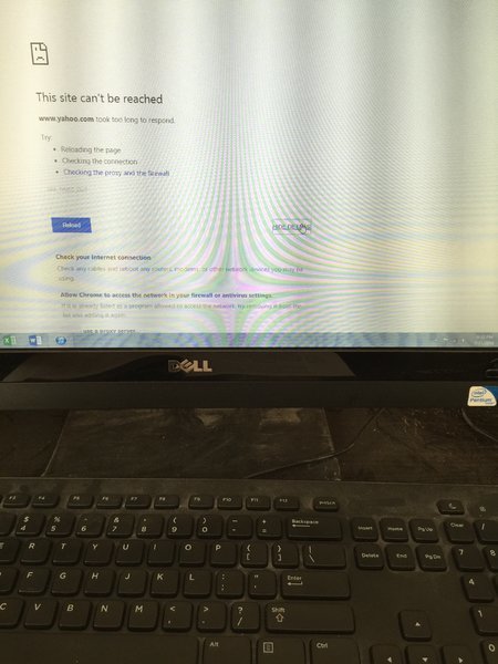

    Recently my desktop hasn't been connecting to the Internet. I get the message in the picture saying the site can't be reached.
    However I'm still connected to the Internet and have a signal.
    This all happened after I uninstalled my old antivirus.
    Any remedy for this? I am running Windows 8.

    Does it work hooked to Ethernet? If it works over Ethernet you may need to get the drivers for your wifi card reinstalled. If the computer came with Windows 8 on it then you should have gotten a disc. That disc could very well have the drivers on it. Alternatively back up the hard drive to an external and do a fresh Windows install. Or send it to dell if you still have warranty.

    I was trying to explain to someone today the difference between having a wifi signal and having internet access. Just because your device can wirelessly connect to the access point does not mean the access point is able to provide internet service/connectivity.
    Saying you have a signal means little. Good advice from Roger to connect to the access point via a wire/cat5/ethernet cable and see if that changes anything. If it does not change anything, reset the access point (if you can).
    Windows' troubleshooter does a decent job of assessing the situation. Any chance you ran it, and if so, what did it say?

    you can look at the IP to determine if you actually have internet or not
    you can unplug the service provider from your modem/router/gateway and the SSID will still broadcast. like above, it doesn't mean it has internet.

    I work for a well known Internet provider. Yes it can be difficult explaining to someone that doesn't do it often that the wifi bars you see only mean your connected to the network. That said have you went to command prompt and seen if you are getting an IP address? That didn't cross my mind earlier. Resetting the wireless router as JDM said is also always a good place to start. Try that first. Then Ethernet cord. Then drivers.
