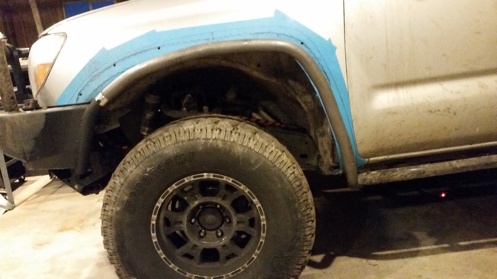

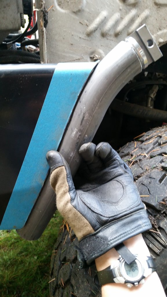

    I finished the driverside brushguard:
    And received the parts to build my RFRM box:

    Thanks guys. I'm very happy with the results. It was a good start with using the tube bender too. I hope to get the other side done over the next week or so.

    So the side that is done is right angle bends?
  9. Nov 7, 2015 at 8:44 AM
    #289
    InTheRough
    InTheRough [OP] Well-Known Member
    Jan 29, 2013
    #96438
    3,001
    Kolt
    Gig Harbor, WA
    '20 Tundra Platinum
    Rock Warrior wheels
    I am not exactly sure what you are asking. I think there were only two bends that would be close to a "right angle"; that being the top right and bottom right of the picture.

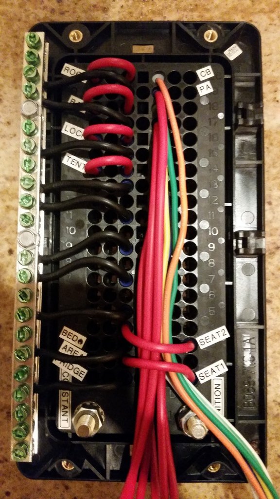

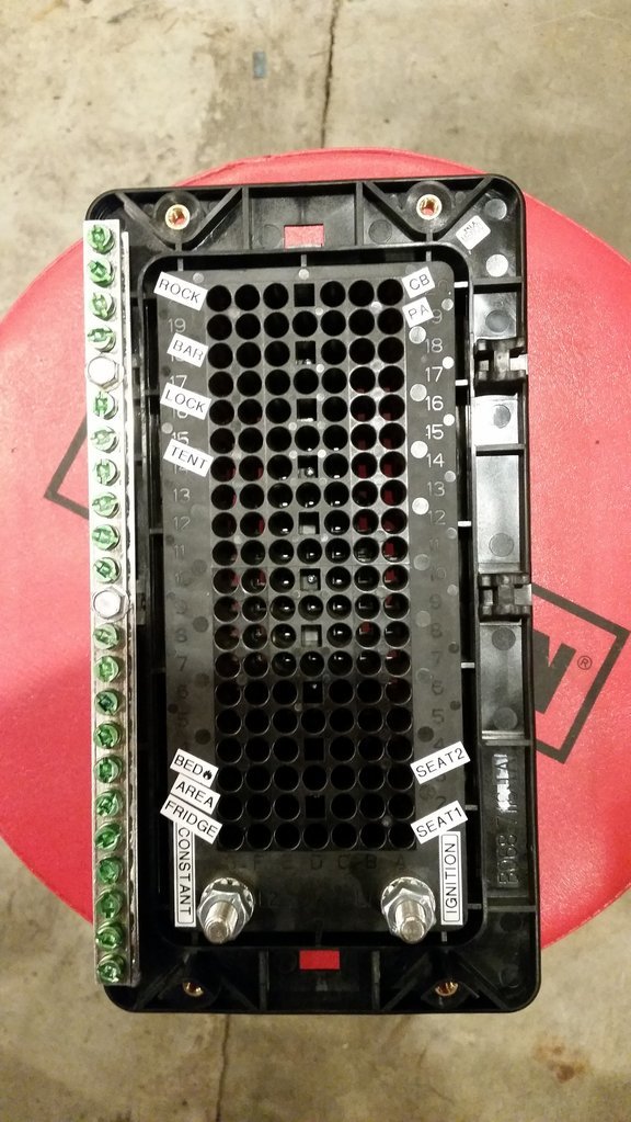

    Its been wet and cold and I have been too busy to work on the brush-guards so I was playing around with the wiring a bit (even though I said I wasn't going to start another project)
    What I am attempting to do is have both bus bars powered, one constant and one with the ignition. All of the grounds will run to an additional bus bar.
    For example, this way allows me to run my fridge at all times but my seat warmers won't stay on unless the truck's ignition is on.
    Top left will be constantly available relays.
    Bottom left will be constant fused.
    Bottom right will be ignition powered relays.
    Top right will be ignition powered fuses.
    I did it this way so that I can group the relays and fuses with their associated power (ignition or constant)
    I have already ordered the Solenoid to trigger the power with the ignition:
    http://www.amazon.com/gp/product/B000CEBXRS

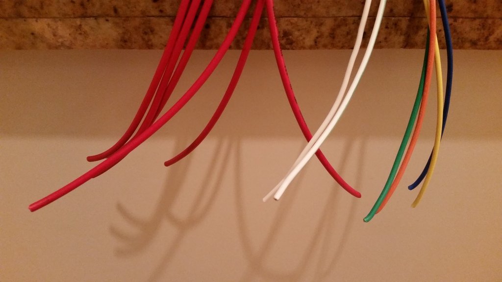

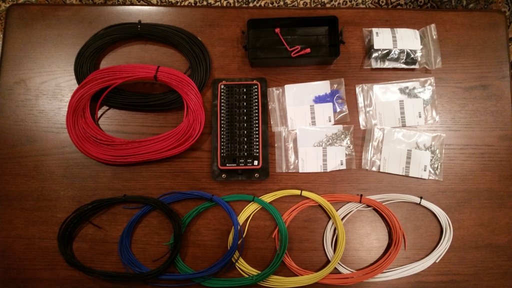

    I got a little work done on the box while my wife binge watched some TV.
    I left the ends even and ready for connectors.
    I also received my PAC-200 ($38 200amp continuous duty) and the Amazon bargain brand ($17 150amp continuous duty) solenoids. I bought the Amazon version and they shipped it before I could cancel the order.

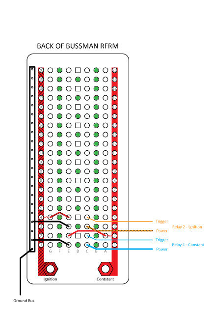

    Thanks, I am just taking bits of information from all of the other people that are building boxes. I am not sure how many amps you are planning on pulling but the smaller version may suit your needs.

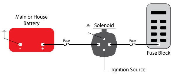

    The PAC-200 came with this wiring diagram:
    But for our intended purposes I would change it just a bit:
    PAC stated that it does not matter which side you hook up the battery or fuse block side to. They did not mention the ground or accessory source.

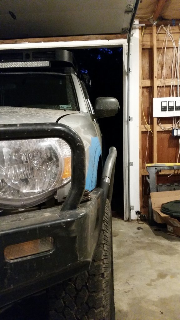

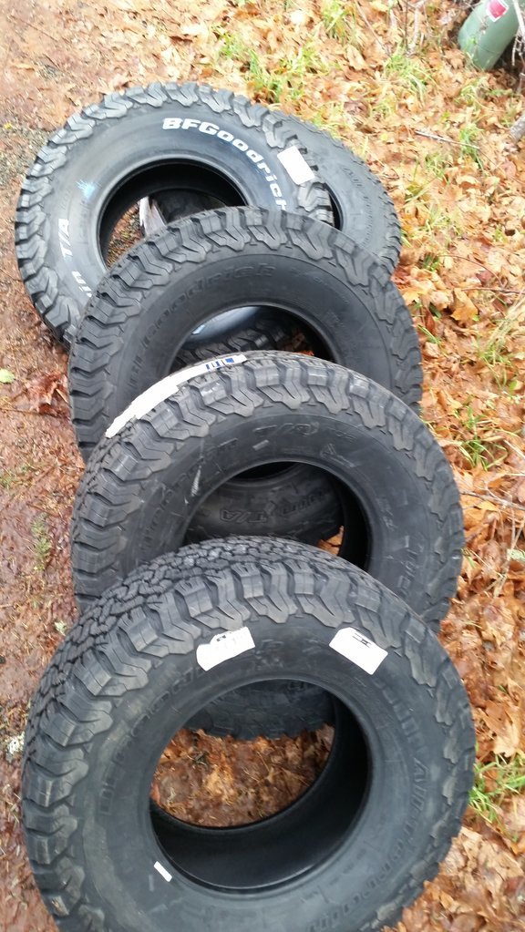

    I sorted the silica beads into 8oz containers (as dynabead suggests) so everything is ready for when I buy my tires.

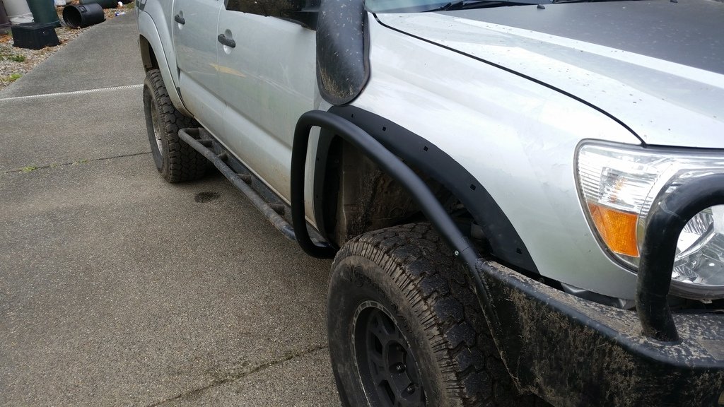

    I finally finished the passenger side brush guard:

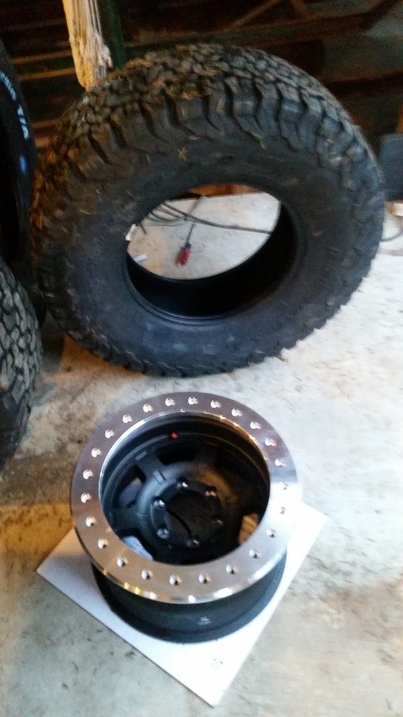

    Today, I found out that mounting tires on beadlocks is a pain in the ass. I tried doing it myself but I'm too light to use the "just jump on it" trick so, after calling many places, I finally got discount tire to set the first bead but left it unfinished. They are sitting in the truck waiting for me to go home and finish them.
    This is from before:
