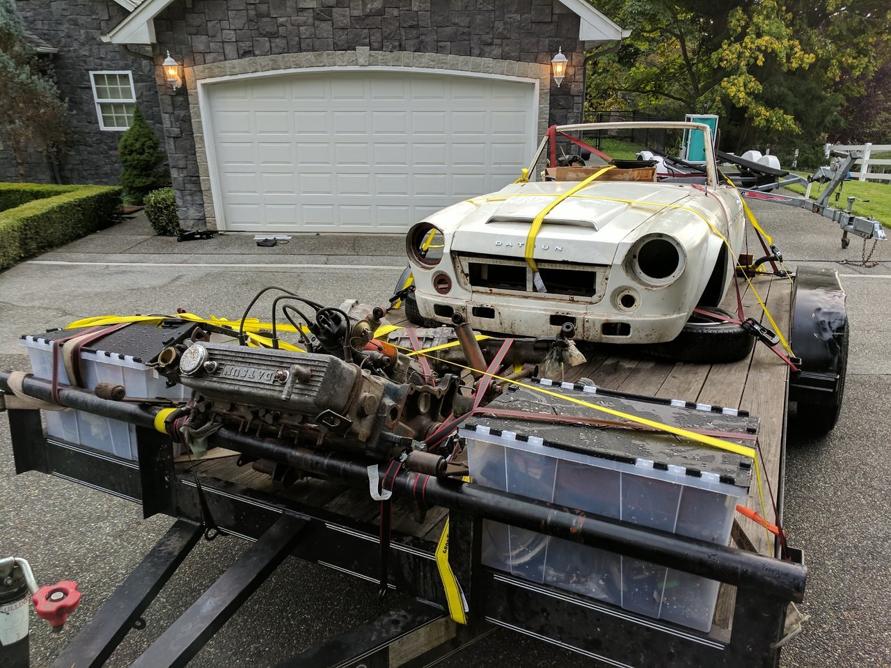

    All of my play money and spare time has been going to finding fun parts for my Datsun. For those that might be interested in that here is some info:
    LS1/T56 (02 Camaro 86k mi)
    Energy Suspension motor, trans and diff mounts
    Ford 8.8 (3.73 Posi)
    IRS (06 MX-5 suspension bits with custom modifications)
    Steering knuckles & control arms (98 Lexus SC400)
    Electric power steering
    Brembo GT calipers and 2-piece rotors (all around)
    3-piece 19" Kinesis Wheels
    Bride Kevlar fiber seats
    Grip Royal steering wheel
    Remote water pump and battery
    https://ls1tech.com/forums/conversions-hybrids/1885046-5-7l-t56-going-into-datsun-roadster-3.html

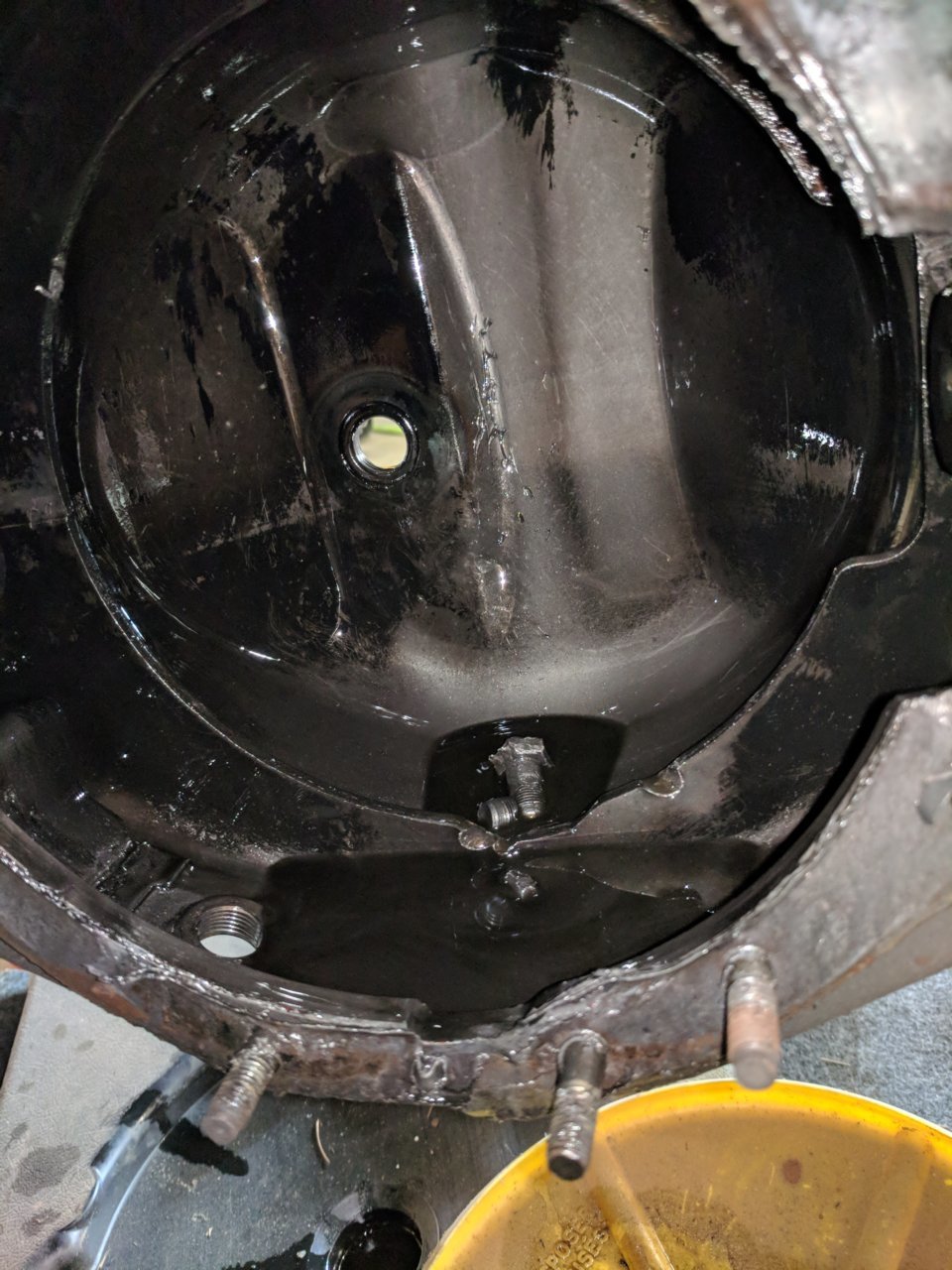

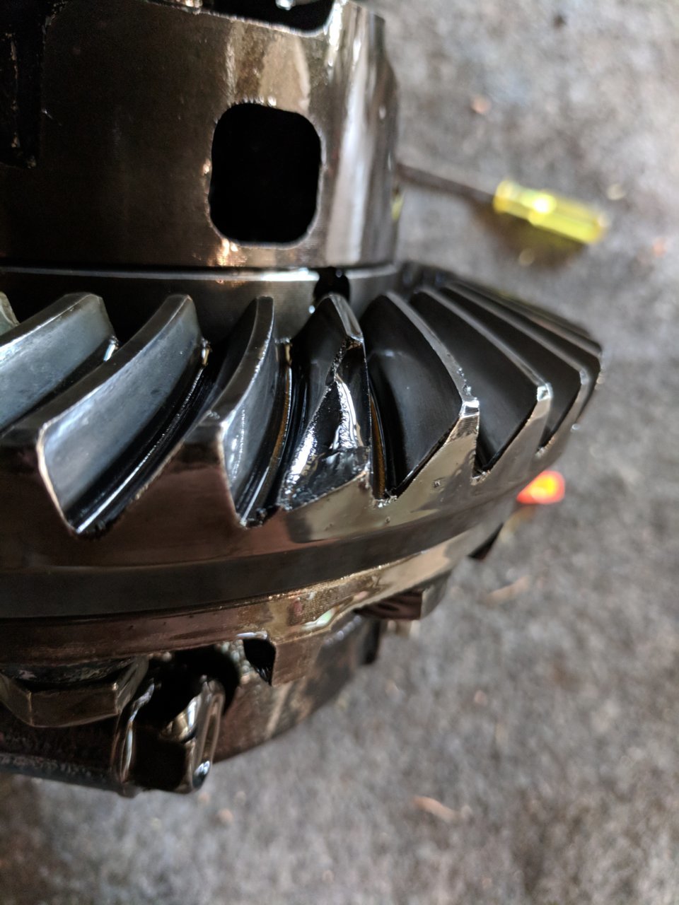

    Second update, my trucks rear diff was leaking and leaving spots on my driveways. The truck did have an issue going from Drive to Reverse (or visa versa) a few times these last 4 years but I didn't think anything of it. I finally got around to replacing the seal and found that there was a more prominent problem.
    Winter of 2014 I put a fully assembled 4.10 3rd member from ECGS in with no troubles. Since then it looks as though some of the ring bolts worked their way loose and one even fell out. Rattling around it broke one (and chipped one) of the Ring teeth and marred up my housing.
    ECGS said they may warranty it but I have to pay shipping both ways for a replacement.
    Should I accept it or fight for a replacement and full refund since their negligence damaged my housing and could have done worse?
