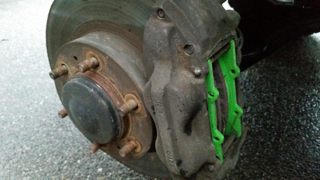

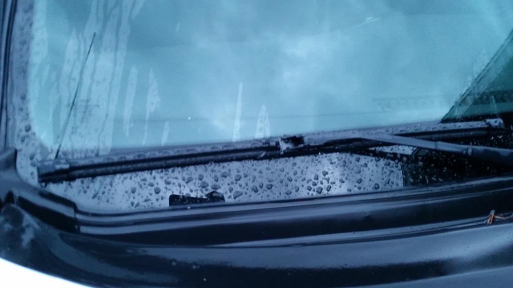

    Maintenance day!
    I took my last final yesterday so I have been spending the last two days taking care of things that have been set aside. Yesterday I ordered parts for my wifes M3 and put most of it back together, took care of my fathers Hummer emissions/tabs and got the brake tool from Oreilly's.
    Today I:

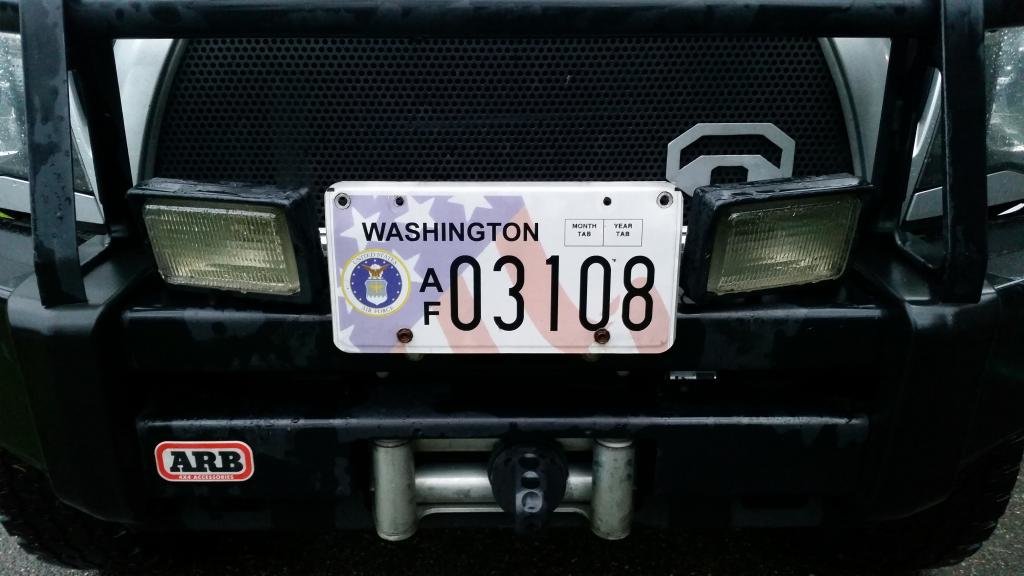

    Installed $2 Garage sale KC lights -
    Hosed it down with a pressure washer and chipped a small chunk of paint off the driver door. I live on a dirt road so I already got it dirty... Whats the point lol I also pressure washed the bed in preparation of putting the canopy back on tomorrow -
    Scrubbed all my windows down and put new wipers on -
    Changed the front brake pads -
    Is there a reason why it's so hard to find shoes for the rear brakes? I feel like most people don't do the rear brakes that often.

    80% of braking is done by front wheels unless you are trailering a lot. You could probably change pads up front twice before changing the back.
    Did you break in brake pads once new ones were installed? Did you turn the rotors when brakes were off?

    By break in, you mean apply the brake till they were seated against the rotor, yes?
    Turn them, no.

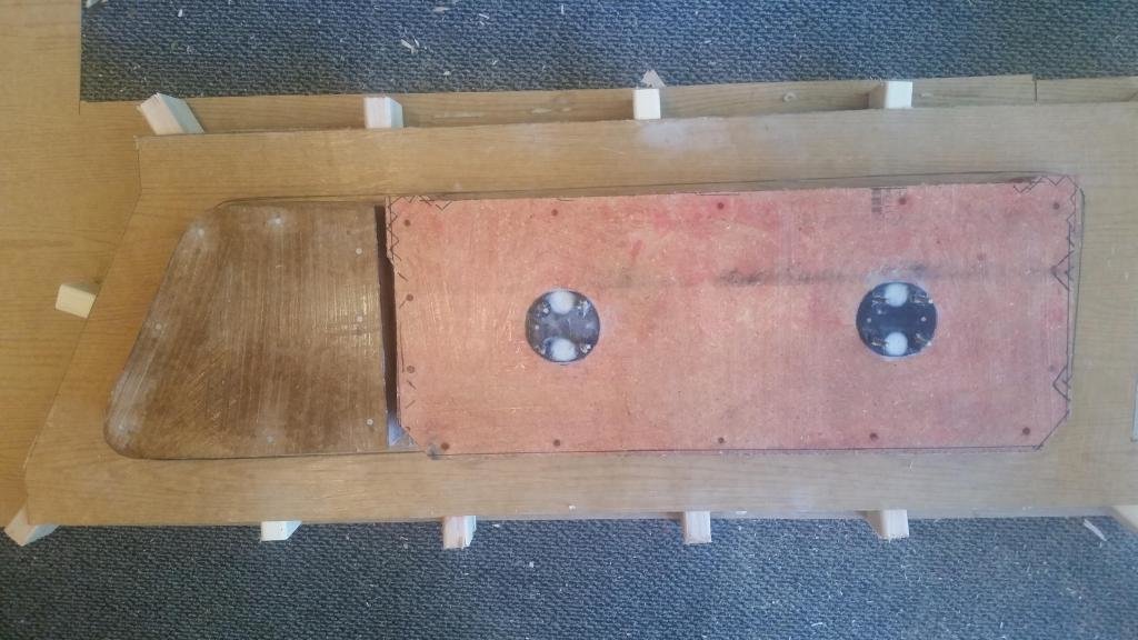

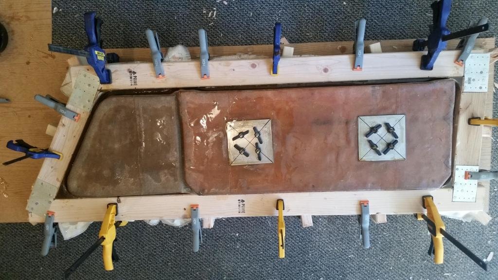

    Messed with my fiberglass attempt... It turned out ok but needs some work for sure:

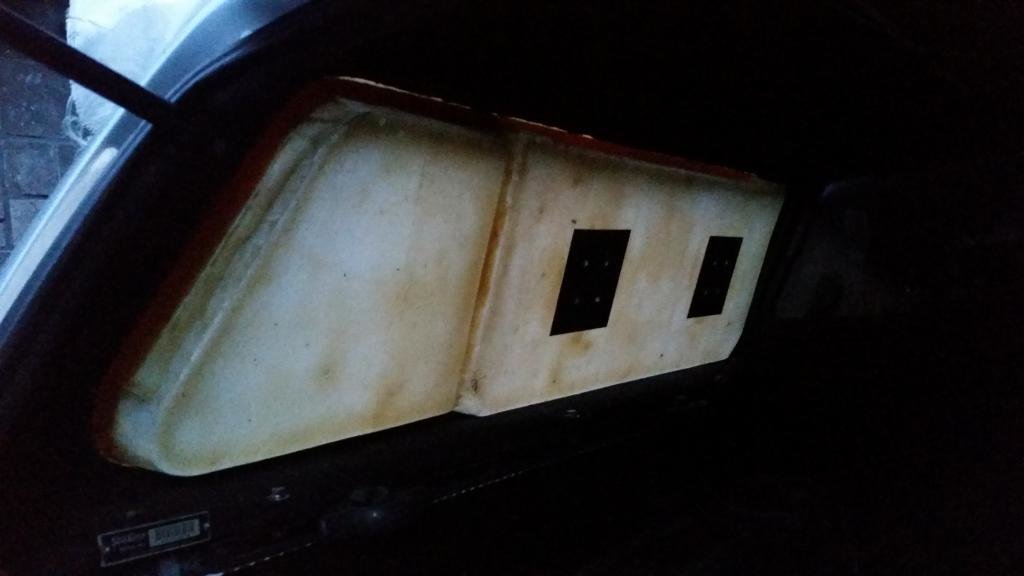

    I posted this in one of the other threads but forgot to post it here:
    This is the lay process that I used (lots of resin between each layer):
    (Petroleum jelly as a mold release)
    Woven
    Woven strips on edge
    Woven
    Woven
    Mat
    Woven
    (Compress the edge)
    (Compress mount location with SS plate)
    When I was done with that I mixed 40% resin and 60% bondo to fill the imperfections while being able to mold it. Sand and paint.
